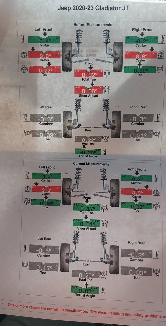

I'm in agreement with some others on not being a proponent for drop control arm brackets. That's with a caveat on how much lift, but 2 in. shouldn't really need it. Now the question is how much "lift" did you actually get, that would possibly be some of it. The addition of adjustable arms can skew handling or not letting the OEM bushings relieve tension and the re-torque with axles holding vehicle. Some lift kit springs are not set correctly for the weight of the vehicle. (The picture is from the alignment done on mine) the caster is still off.
Jeep Gladiator At what height do I consider a control arm drop bracket? 20240822_175912
This may add slight twitchiness to steering vs factory setup.

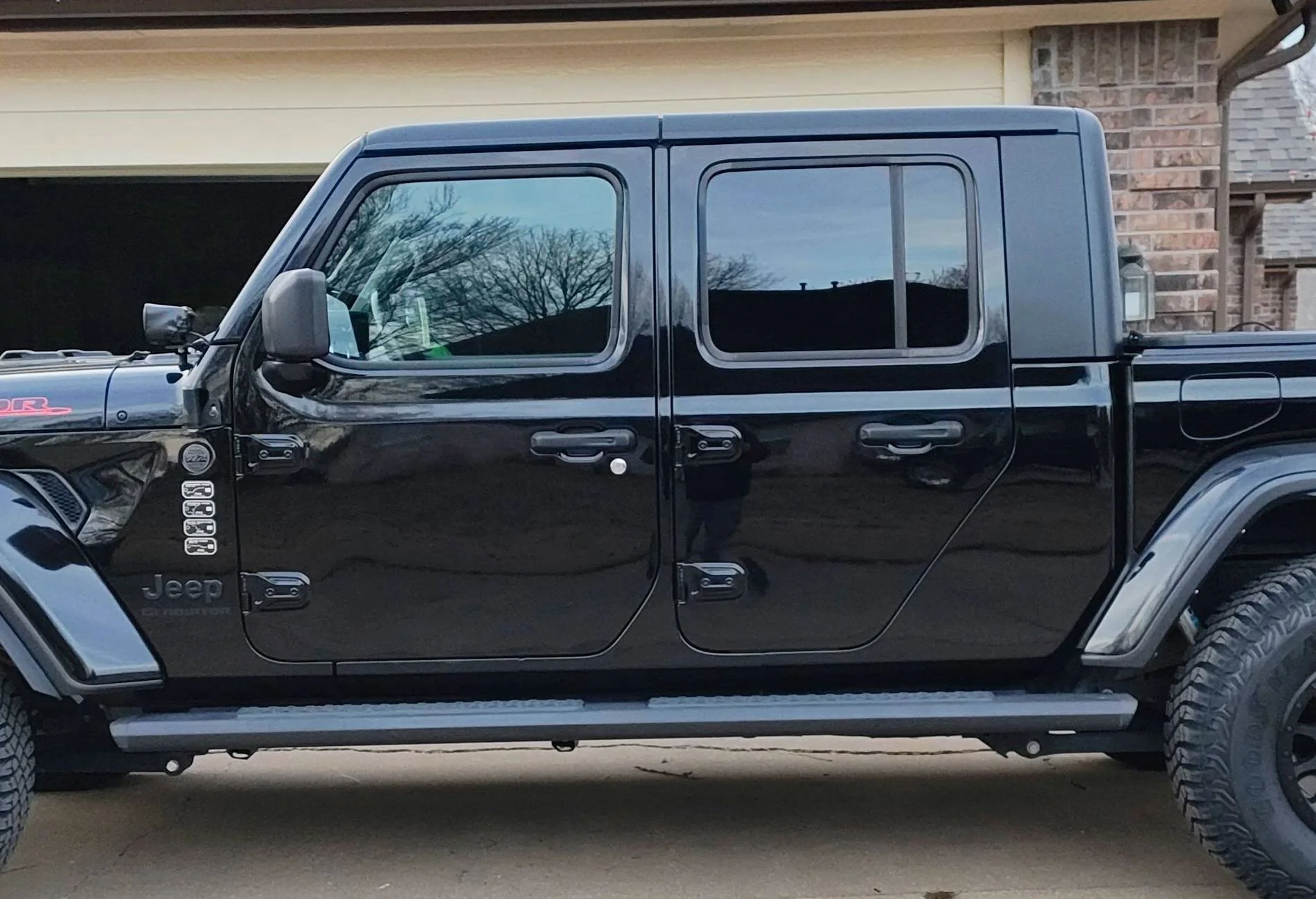

Machinist at Ramsey Winch
The drop brackets do not come down any farther than the stock rear lower control arm brackets. If you are going to have clearance issues with the drop brackets then you are probably already dragging the rears.

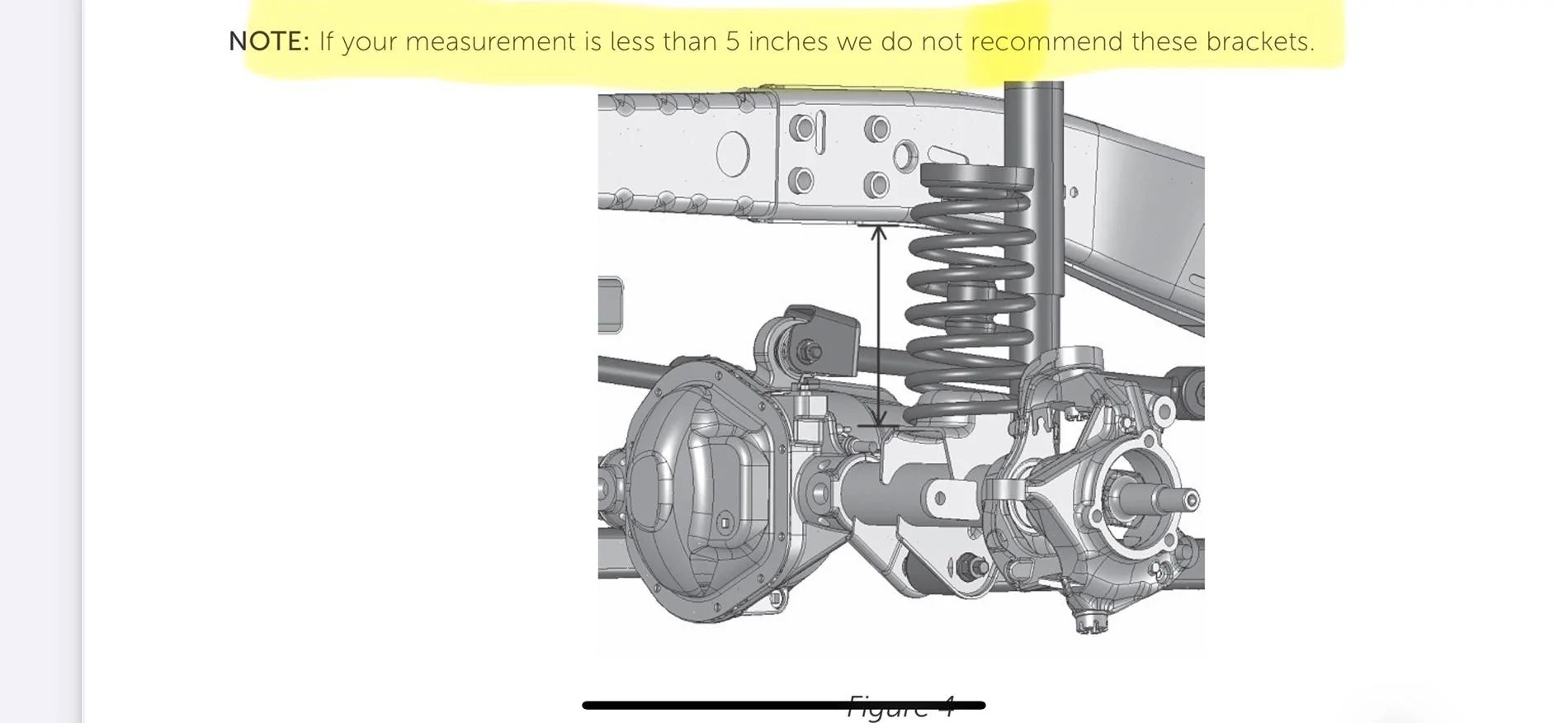

Metal cloak, teraflex and Rancho say 2.5
and AEV says 2”
I’m curious to know what the stock measurement is of the area indicated in the image I posted. Before any lift is installed.
