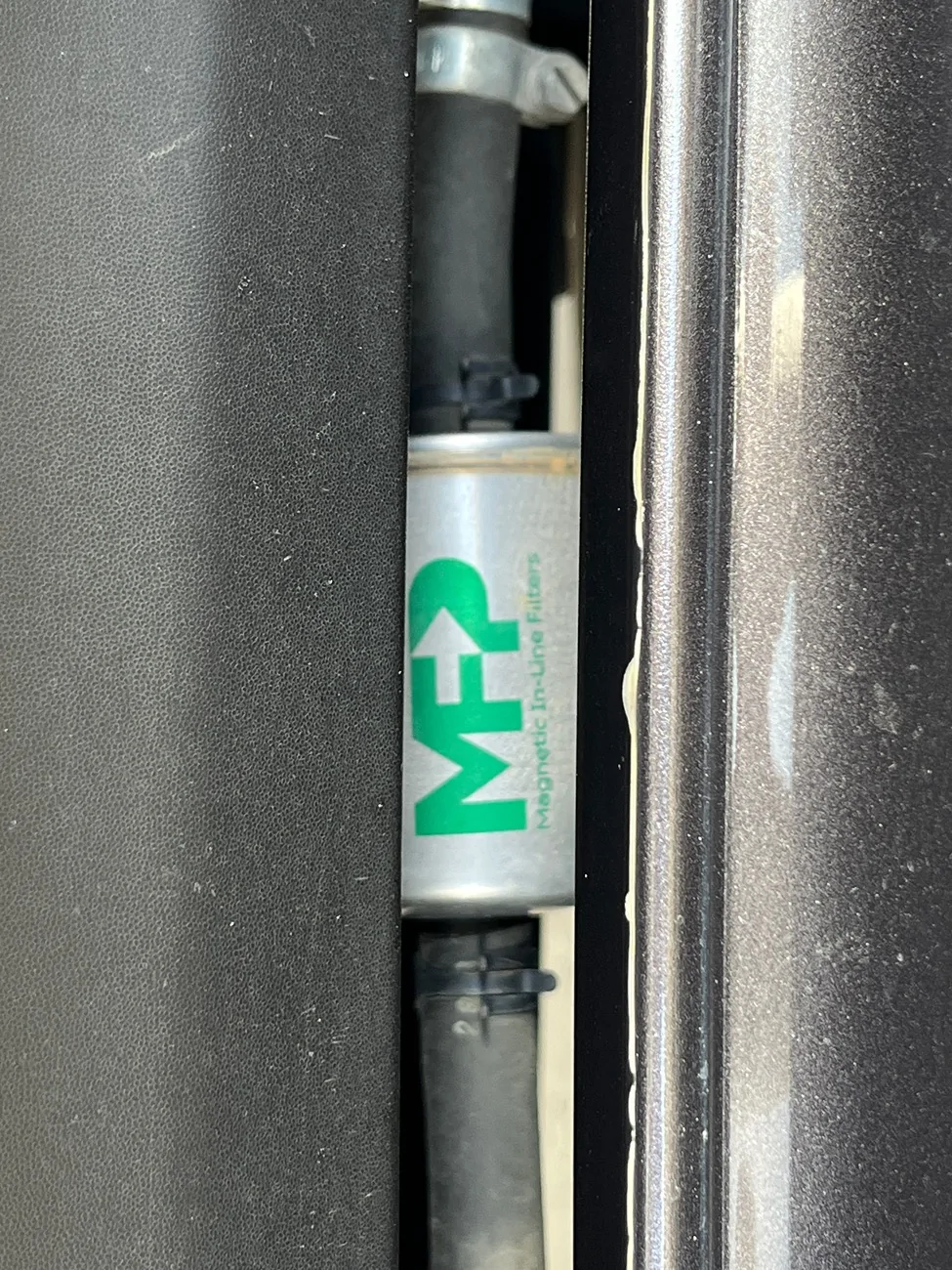

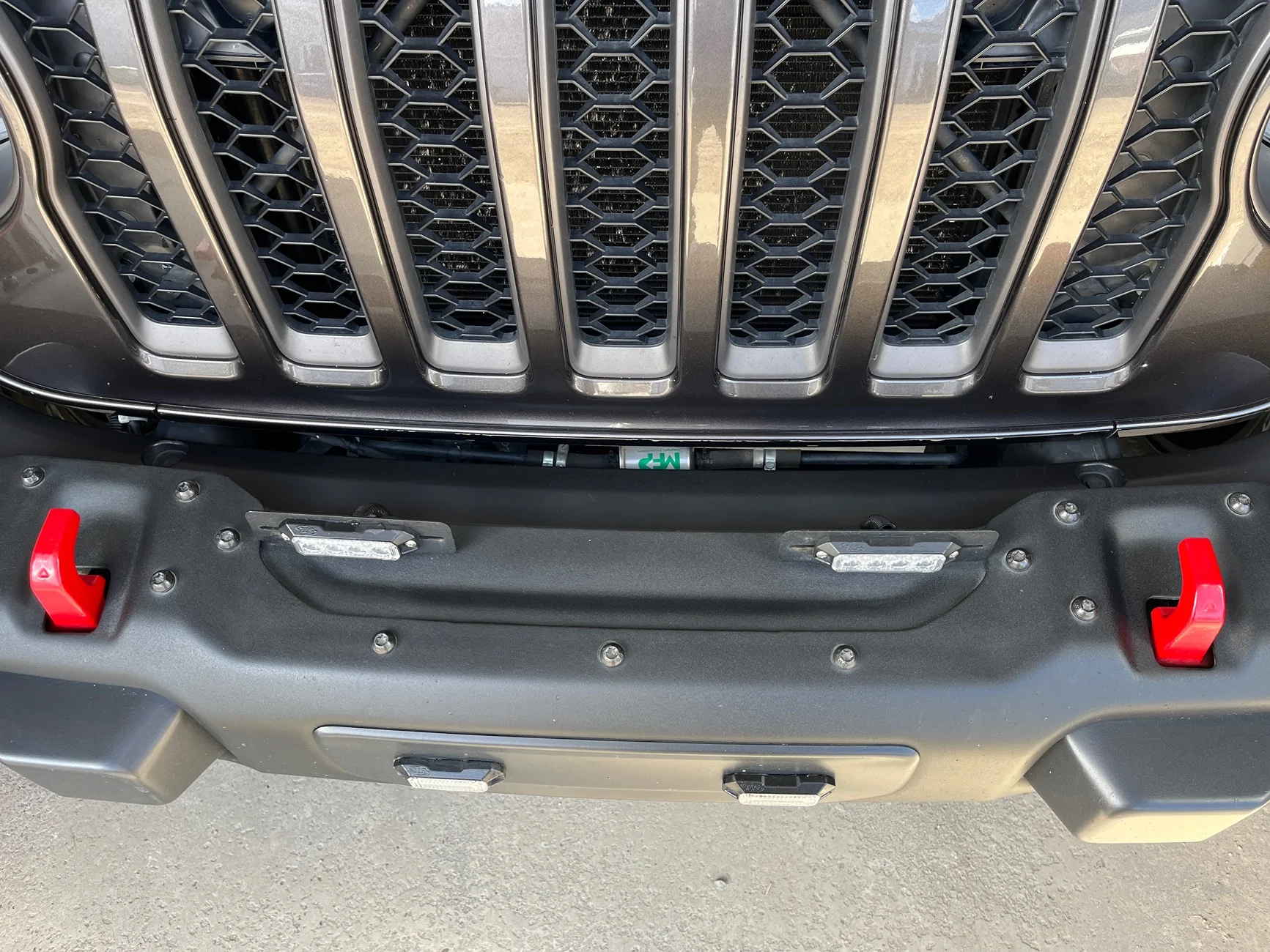

What’s you milage and have you done a power steering fluid flush yet? I’ve gone one step further and installed a low pressure magnetic transmission/steering pump filter on the low pressure steel line. Keeps the fluid clean.
Jeep Gladiator Intermittent high pitch whine coming from under the hood IMG_4293
Jeep Gladiator Intermittent high pitch whine coming from under the hood IMG_4292
This location for the filter up front is also the flush location now instead of the more difficult and messy location at the pump.
