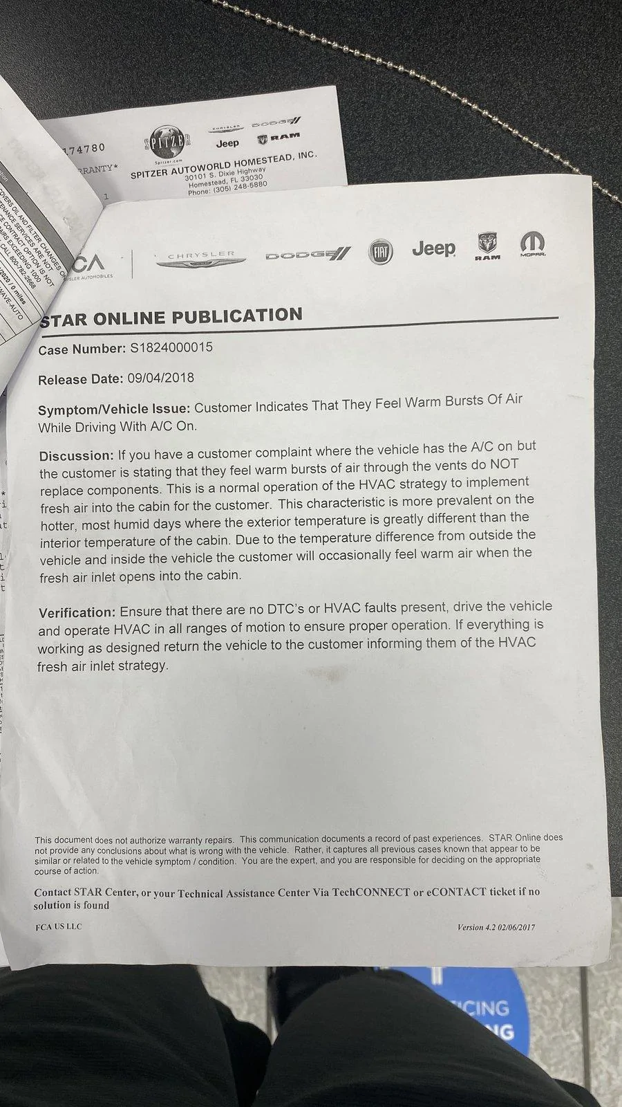

I was wondering if anyone has had an issue with the area around your feet getting really hot all of sudden.. It has happened to me three times after I have driven for about 40 to 50 miles. It will feel like all of a sudden a vent or something has opened up and it will get hot around your feet/legs for a few seconds to about a minute, then it will go back to feeling normal. The air coming from the vents will still be cold. The AC will be set about 66* to 68* and it will be set to blow out the dash vents with the re-circulation button on. I had it in to the dealership and they drove it for awhile and they cannot tell me what the problem is because it would not do that for them. I have had other Jeeps(4) and did not have this problem with any of them.

so this is my second gladiator and they both have had the same issue. I took it to the dealer and this is what they told me.

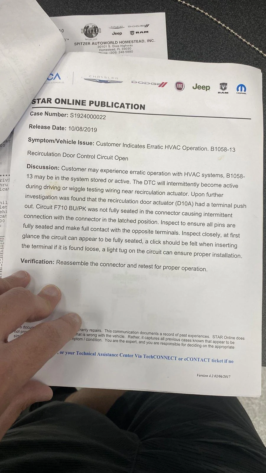

Thanks for the STARS numbers. 2nd one might be a good one to have looked at, pin retention is a problem in any connector, workmanship!
