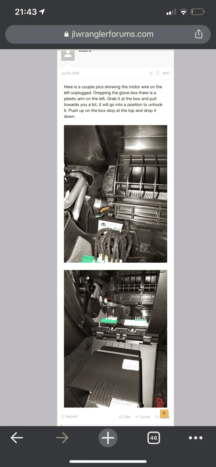

I'm working with the dealer to find away to manually block the air from coming in. Will keep you posted.
So...
I found a "fix" for this over at the JL forums. It works. I went on a 4 hour drive in Beautiful Hot Humid Florida and did not once get the pocket of air. Only con is that you lose the option to change between in cab circ and fresh air. It stays stuck on which ever option you have set before you unplug it.
I know some of you guys use that feature and might no work but for most people that live in hot humid area will definitely not mind.
Its still unacceptable that @JeepCares still has done nothing to fix/correct this. (and no I'm not going to send you message. I did that with the last gladiator and one of listed problems on my lemon case was "A\C Issues")

I unplugged the connector behind the glovebox. I’ll reconnect it in the winter
