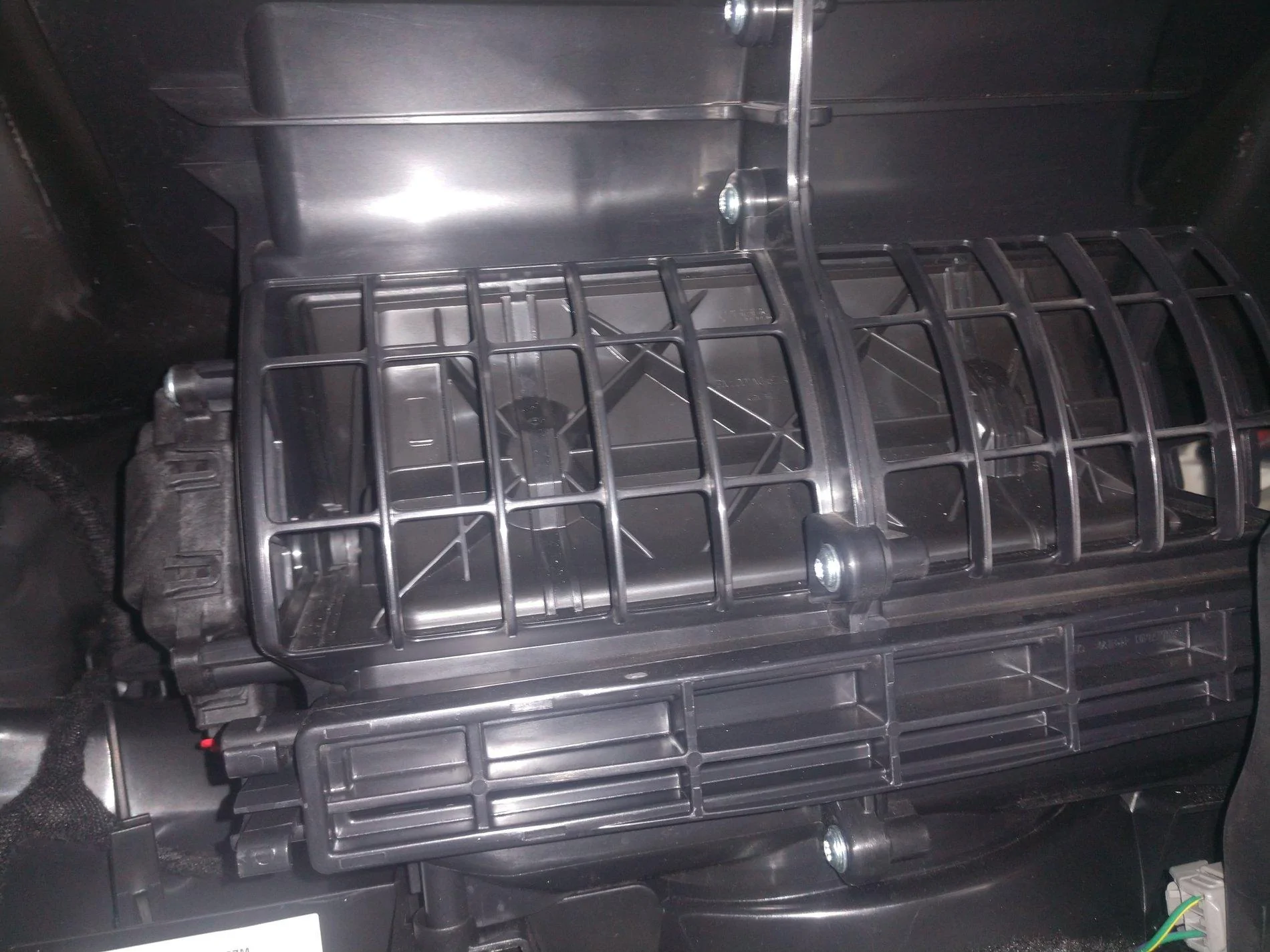

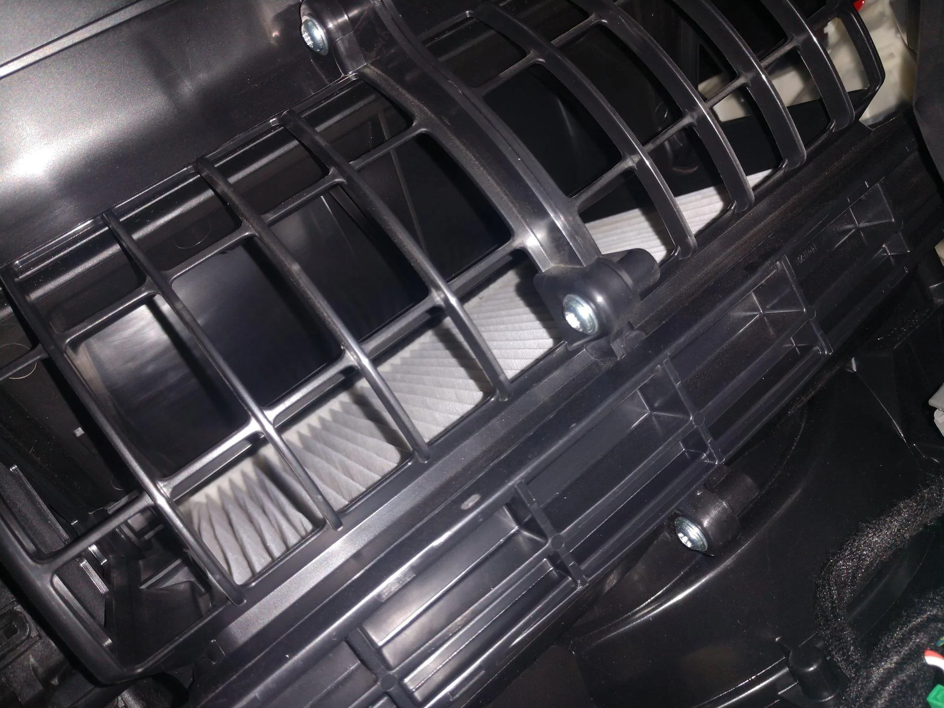

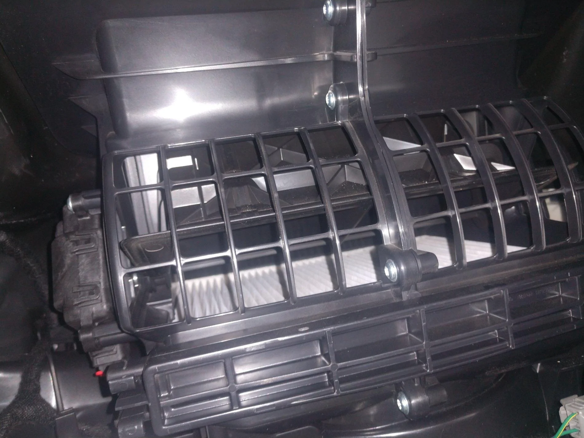

Well here is the source of the problem. And huge shout-out to the wifey for driving while I disassemble the Jeep. All these pics are taken behind the glove box.
When the AC is run in recirc mode, there is a baffle that moves in order to recirculate the air. Normally that is in the full up position as in the first picture. On fresh air mode, the baffle is all the way down to get air from the outside. See second picture. But for some reason, the baffle shifts to half open, as in the third picture, sometimes while in recirc mode. I'm assuming this is on purpose, in order to keep the inside air from getting stale

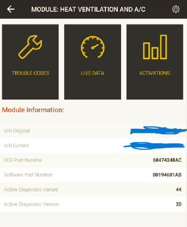

Anyone who had the 24-007-21 update have a OBD adapter and Jscan or another app, and could check the software version of the module? My dealer says they did the update but there was no change in my HVAC module versions.
