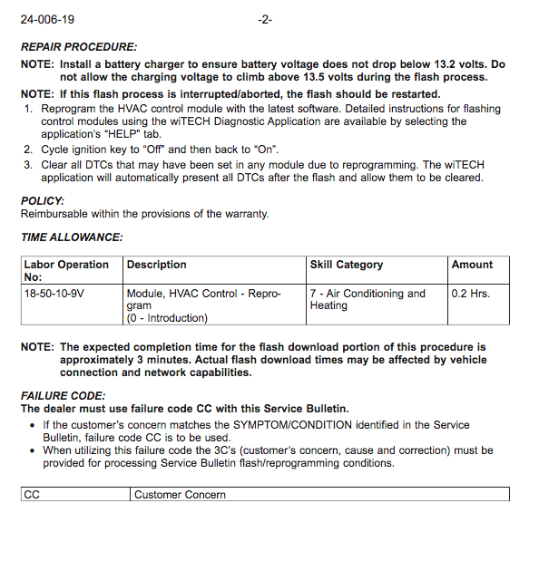

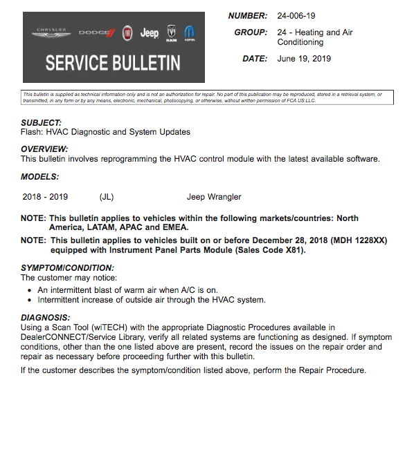

@JeepCares just got my JTR back from service...ā€UTD UNABLE TO DUPLICATE CONCERNā€ I told them the exact problem... Blast of hot air coming from the a/c every 20-30 min. They drove my car for only 4 miles and had my car running for over an hour. There’s no way they can identify the issue like that.
Service manager told me they ran all the code and nothing showed up and there’s no Service Bulletin out.
Interesting enough I found a service bulletin for the JL that was just released in June 2019.
My question to you @JeepCares, am I going to have to wait a year to get this fixed??? I spent close to $60k on my JTR. For that price range this is UNSAT.!!!!

Yea I’m surprised that more people are not complaining about it. I’ve been in contact with Jeep Corps. They talked to the dealer and there are going to use the JL TSP to fix the problem. Since the TSP doesn’t say the the dealer need to duplicate it, just if the customer notices certain symptoms.
