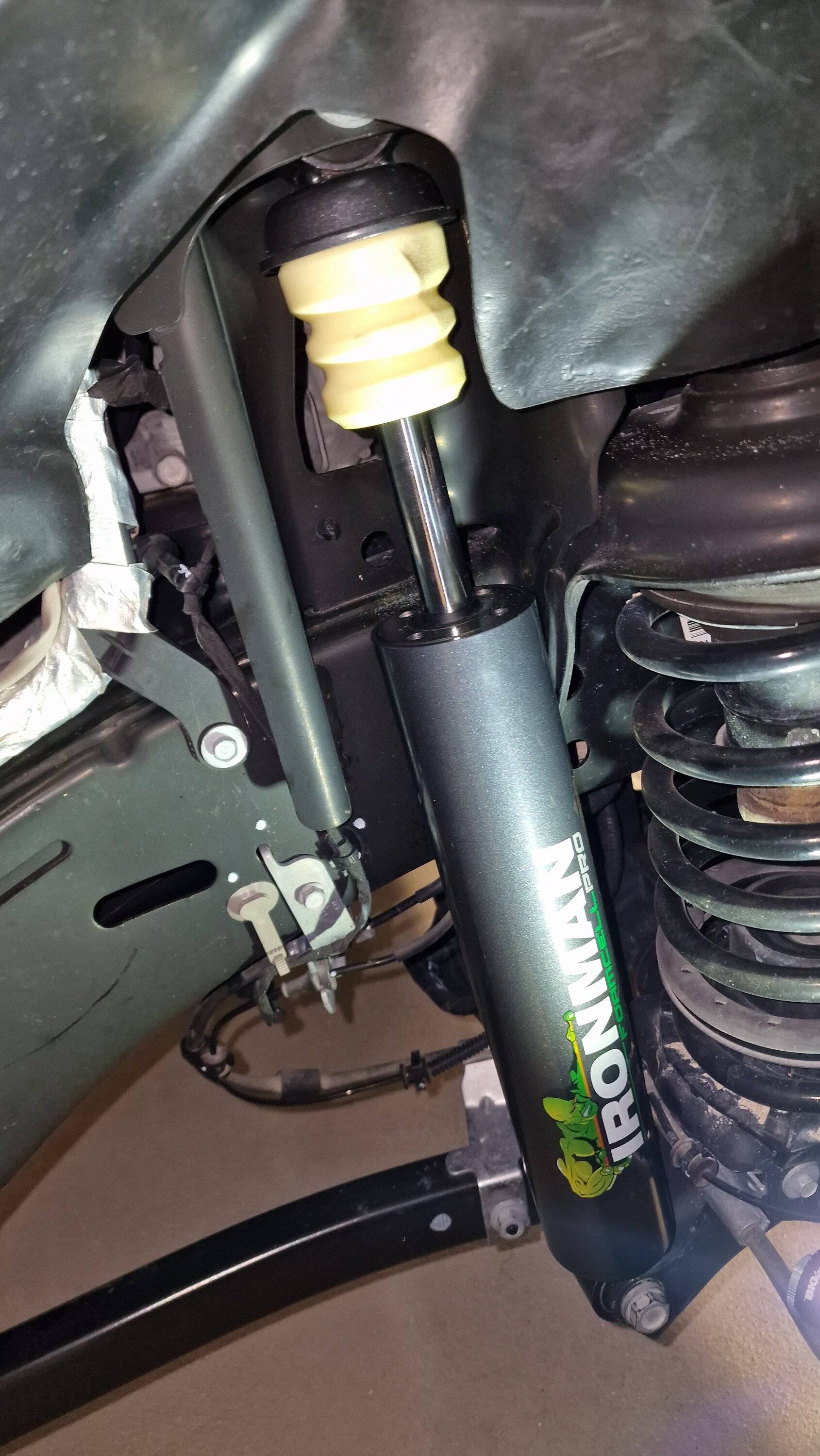

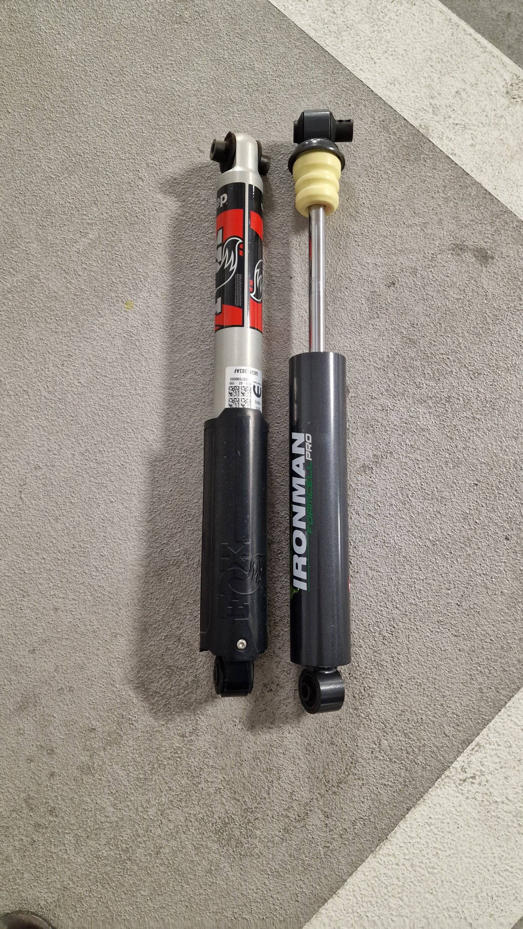

I'm running the foam cell pro shocks (in comfort) and they are excellent. Coupled with standard JTR springs I have a Jeep that now rides the tarmac really well and dune bashes at the weekend. The foam cell pro is a seriously robust shock. I didn't go with the springs only because with the 1.5" level as well (total 3.5"), they'd be too long for the shocks.

Why are they mounted upside down?
These aren't monotube gas shocks, they should be able to be mounted in either orientation
I would be more concerned with the the bump stop, the shock mounts were never designed to handle that sort of load. There is another cost to add to this kit, proper extended bumpstops
