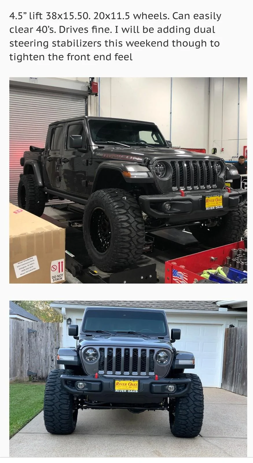

I personally passed on the Mopar lift for not being enough to run a 38" tire with sufficient uptravel. I purchased a 4.5" Skyjacker lift that will inevitably need an upgraded front track, lower control arms and shocks. But, like the Daystar, I will be able to run a taller tire competently, and as my needs change, I will upgrade.
Here is the ride height that I need for the trails out west and in Baja California that I prefer to run.

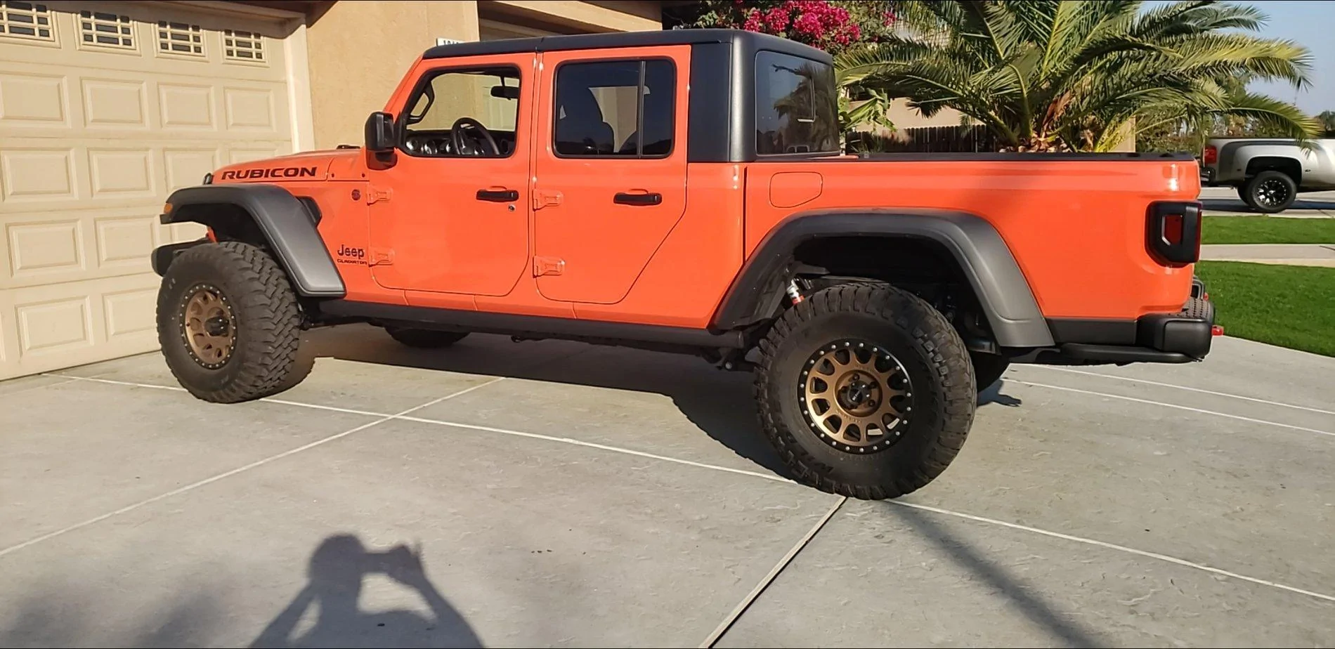

35s fit stock and the 2" spacer by daystar is simple and actually helped mine drive better by correcting caster. Looks great and looking forward to 37s.

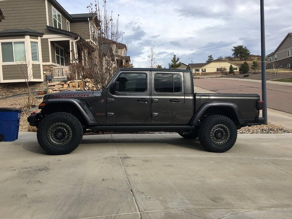

I put Teraflex 1" pucks on the front, Daystar 3/4" pucks on the rear and then had an alignment done after adding 35's. Total cost including alignment was $200. This maintained stock clearance from the top of the tires to the fender flare. I like the look, and will trail test eventually to see if anything rubs.
2k0NHAg-hjPCcR_0WhlJeIKxmAb0LSBv0i_xg98GMwiddFVxObaDhdovooVw?width=1024&height=768&cropmode=none.jpg
That's just about perfect from my perspective. Well done
