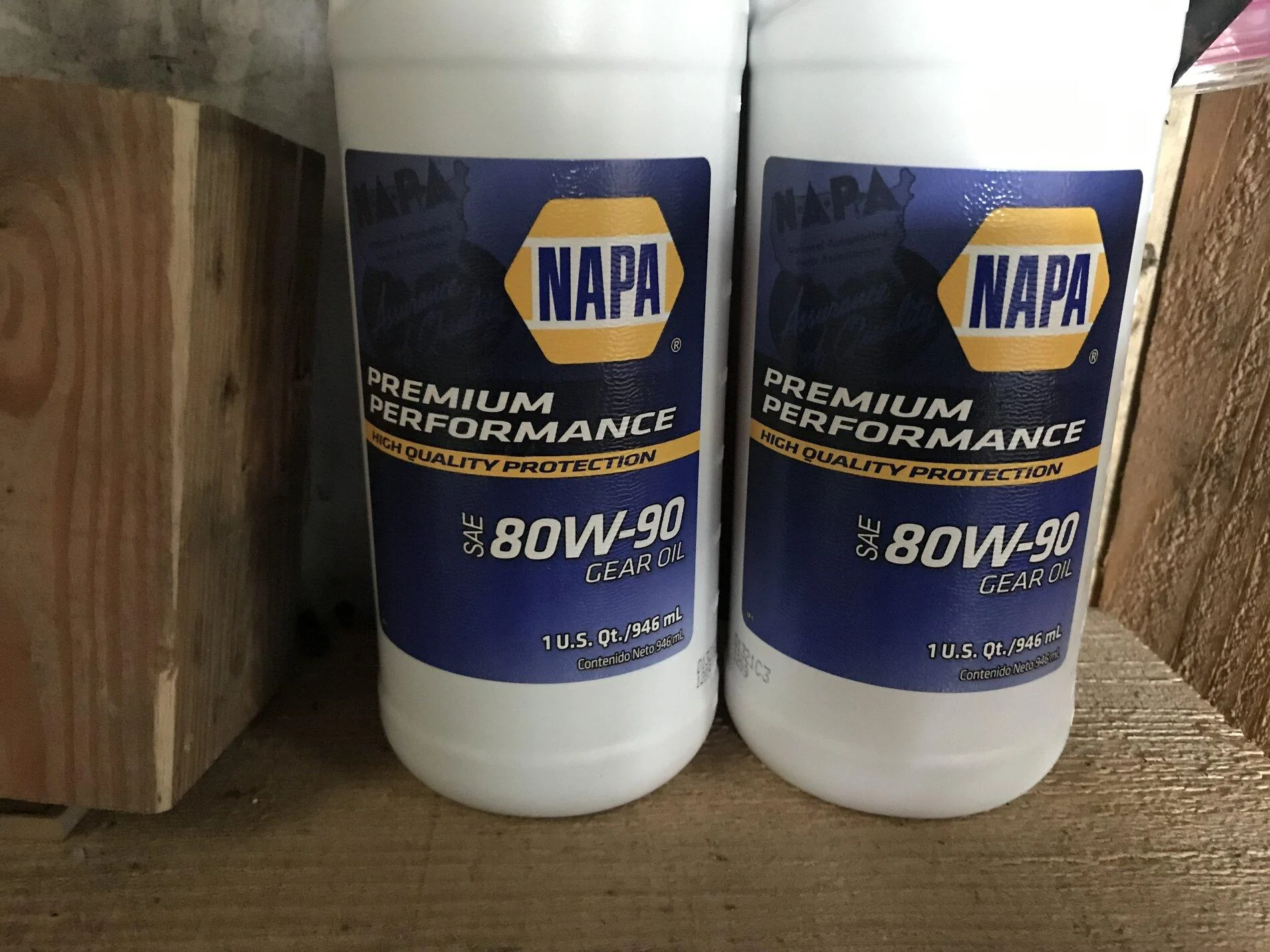

So I was told this stuff is fine for my 2020 JTR front diff. Is that good info?

Brand? Got a pic?
I don’t remember the brand, and can’t get a picture.
But it smells just as nasty as any gear lube I’ve used over the past 50 years.

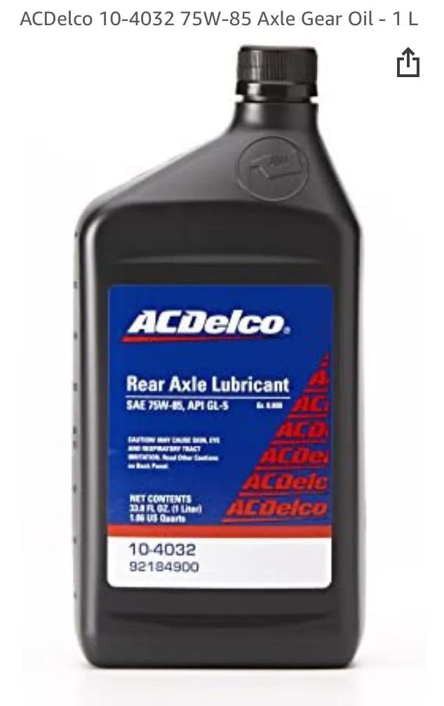

Really? I didn’t know that. I’ve got two jugs of 75w-90 in my garage, and one is synthetic, and the other is conventional. What about this stuff?
Jeep Gladiator Is the factory fill of the diffs and transfer case Synthetic oil? CD70A57B-EA0D-4522-832A-5BA2F3E0D847
75W-90 is a different animal than 75W-85. There is conventional 75W-90 to be had but even most of the offerings in that grade have been either semi-synthetic or full synthetic blends.
It is not a cross I am going to die on, but from my search in the past, it is damn near impossible to find a commercially available 75W-85 grade gear oil that is a full conventional gear oil and labeled as such. There is some minor brands that will not even list whether they are conventional or synthetic but the assumption is they are synthetic based on the rest of the industry labeling that grade as such.
I dove into the issue of 75W-85 in years past when I had a FJ Cruiser as initially Toyota had the factory fill of a 80W-90 conventional gear oil grade in the early years. They eventually went to a 75W-85 not for fuel economy reasons but for better cold weather flow characteristic as they had problems in Northern USA and Canada winters differentials with the 80W-90 but the 75W-85 grade synthetic cured their issue. It was easier and cheaper to formulate a 75W-85 grade GL-5 spec gear oil from synthetic base stocks than to formulate from conventional base stock.
For purposes of the OP's question, it is safe to say the factory fill was a synthetic 75W-85 grade factory fill and probably a SOPUS product. Also, the MOPAR replacement 75W-85 grade gear oil sold at the dealership is a synthetic product.
So if people are wanting a white paper showing "all" 75W-85 sold on the market is synthetic, I do not have that, but the preponderance of the evidence of what is out there in 75W-85 grade gear oil shows it to be a synthetic product short of maybe an unknown unicorn product I have yet to see.
