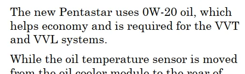

If this matters to anyone - This is from FCA -
Jeep Gladiator is 0W-20 really the right oil ? 1657471390391

There's a white paper out there somewhere where there is some literature about the newer 3.6s having valvetrains specifically designed to use 0w20. Something about the oil passages being smaller than they used to be. If I were to get researchy, I'd buy the highest film strength 0w20 I could find. Maybe when the engine gets older, I'll use something thicker.
I have a manual, If you stall it and watch the oil pressure drop its surprising how long it takes. Same thing if you rev past 3k and let it drop to idle. The only real reason I can think of to use a 5w20 over a 0w20 would be if its film strength was significantly better but so far I haven't found that to be the case.

I would love to see proof of this.
The only thing different between a VVT and original Pentastar is the head. And that's only a minor change. Everything else on the VVT has the same part numbers as the original from 2010-2012. Bearings, pistons, rings, rods, oil pump, block. All the same.
Just like in 2013 when they switched from 5w30 to 5w20. Zero changes made to the engine, yet lighter oil. And then we started seeing an increase in follower/cam failures.
Now I'm tempted to pull a valve cover off both my '12 and '21 to look at the oil passages.
Believe what you want. The fact is that ALL of the development work on the PUG was done on 0w20. The heads are where the complexity is anyway in the Pentastar. There are several reasons, including reduced friction, tighter tolerances, smaller oil journals and yes, ESS. But one other big reason is out there......The Pentastar had already specified 5w20 since 2011. No reason under God's sun to even consider spending a dime on messing with 5w30.
I posted an article awhile back that had the dimensions of the oil journals in the head. You can go find it if you want. It'll save you some time pulling heads and getting your calipers in there.
