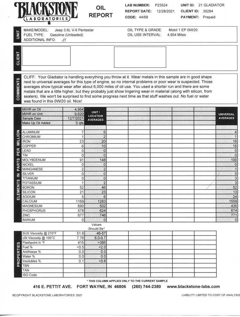

Just for grins here is the UOA from my Gladiator. 9.620 miles on the truck. 4,954 on the oil. Seems to be breaking in fine.

Looks good. I love blackstone oil analysis. I’ll be changing mine soon at the 10K mile mark and will post mine if I can remember

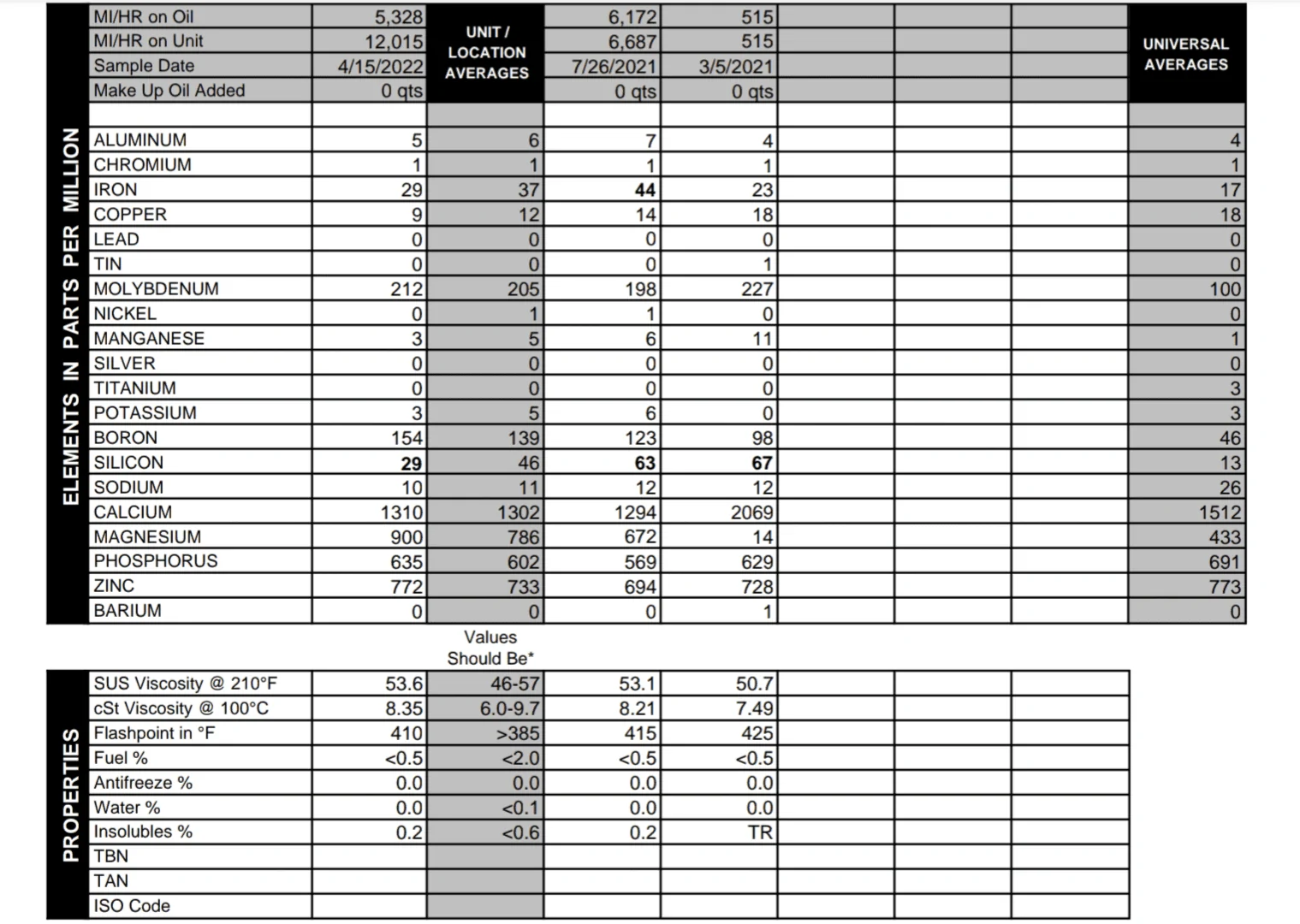

I'll add to your thread, I looked to see if anyone had started a thread about Oil analysis.
So I'll add results for my JT.

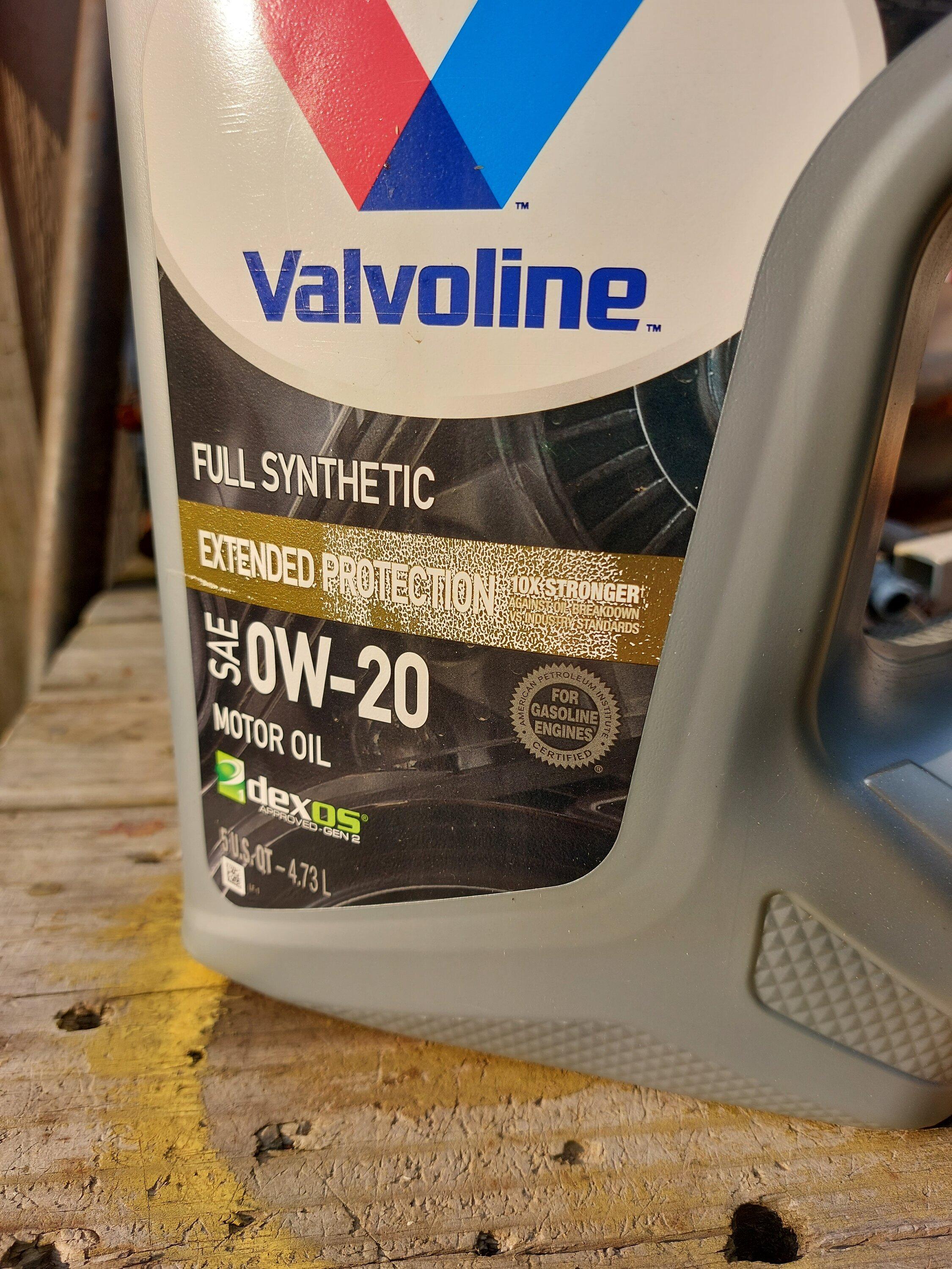

So now not to start a S### show on what oil to use. I've been using Valvoline Full Synthetic Extended Protection SAE 0W-20. It was the cost effective meeting specs. around $22.°° so that's what I've been using.

Does valvoline meet the chrysler specifications ?I've been using pennzoil platinium (as thats what the dealer recommended and has the specific chrysler specification met/or exceeded (forgot the exact specification)).

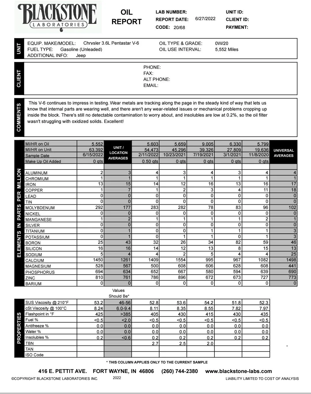

Jeep Gladiator Oil UOA, M1 EP 0W-20 with 4,954 miles Screenshot_20220706-150949

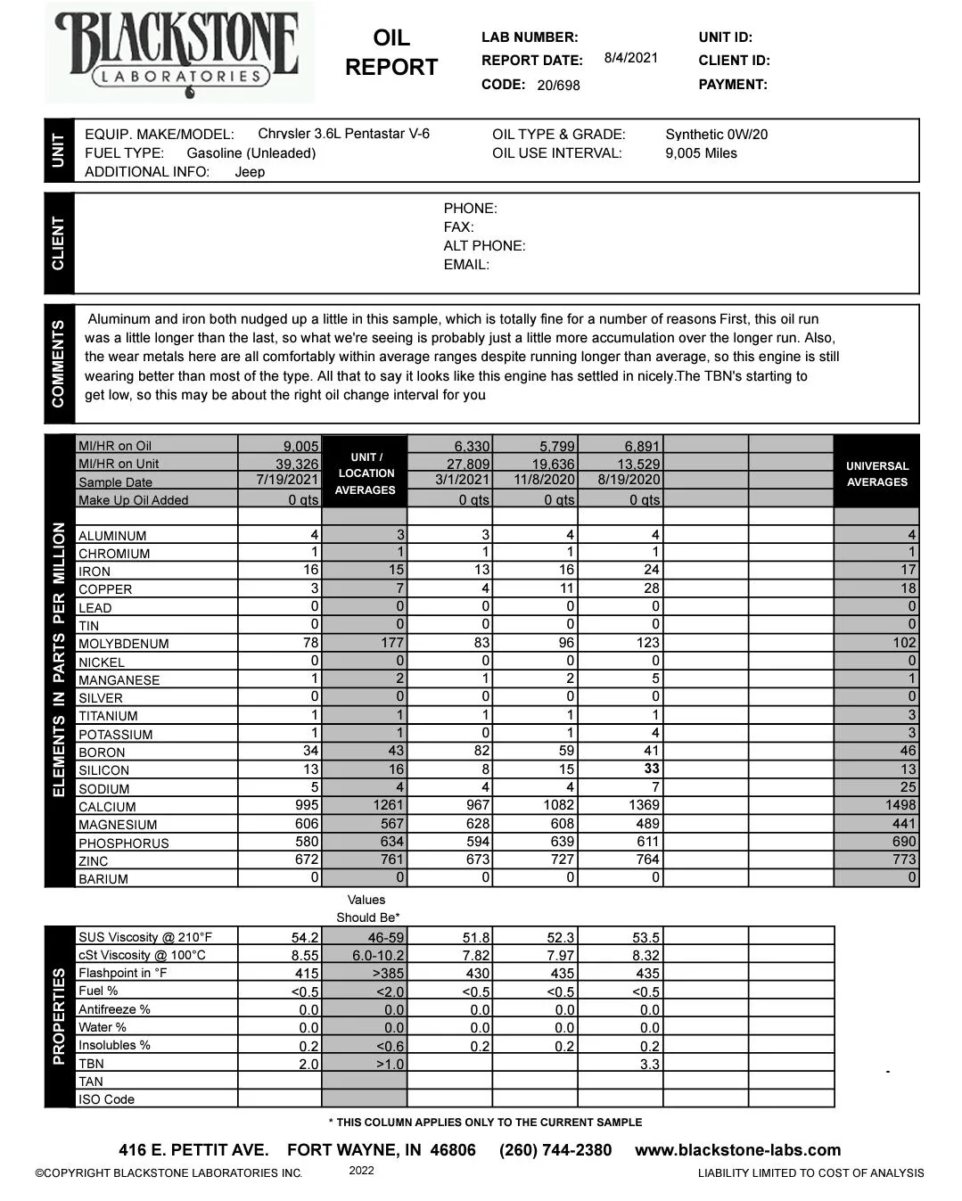

This is Amsoil SS 0w20. The truck is mostly used for towing my boat and off-road trailer, which makes up about 75% of the mileage.
As far as I know it's got the pentistar logo as meeting the specs... ?‍♂ and according to oil samples it's doing good. Now I have needed to add a qt to top off at over 6000 miles on this change the"Oil life meter" is at 30% left was at 35% when I topped off yesterday. Over 6 hours driving from my home to E. KY. towing trailer.
