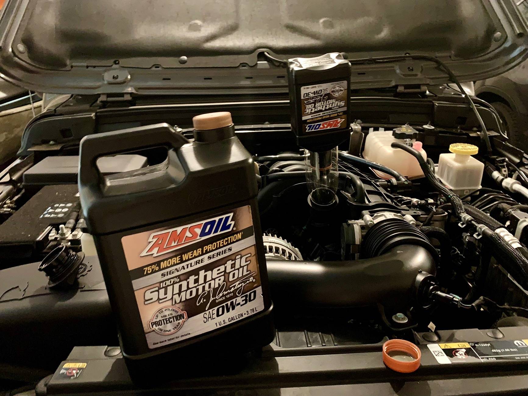

I changed my 0w-20 oil to 0w-30 last week. I know it might the “placebo effect,” but the engine seems to be smoother and quieter. I’ve been watching the oil pressure and oil temps, they seem to be the same as when 0w-20 was used.
There's only one part of any 3.6 I've owned that could be quieter and oil won't help their injector sounds. There's times I forget it's running so smooth and quiet.

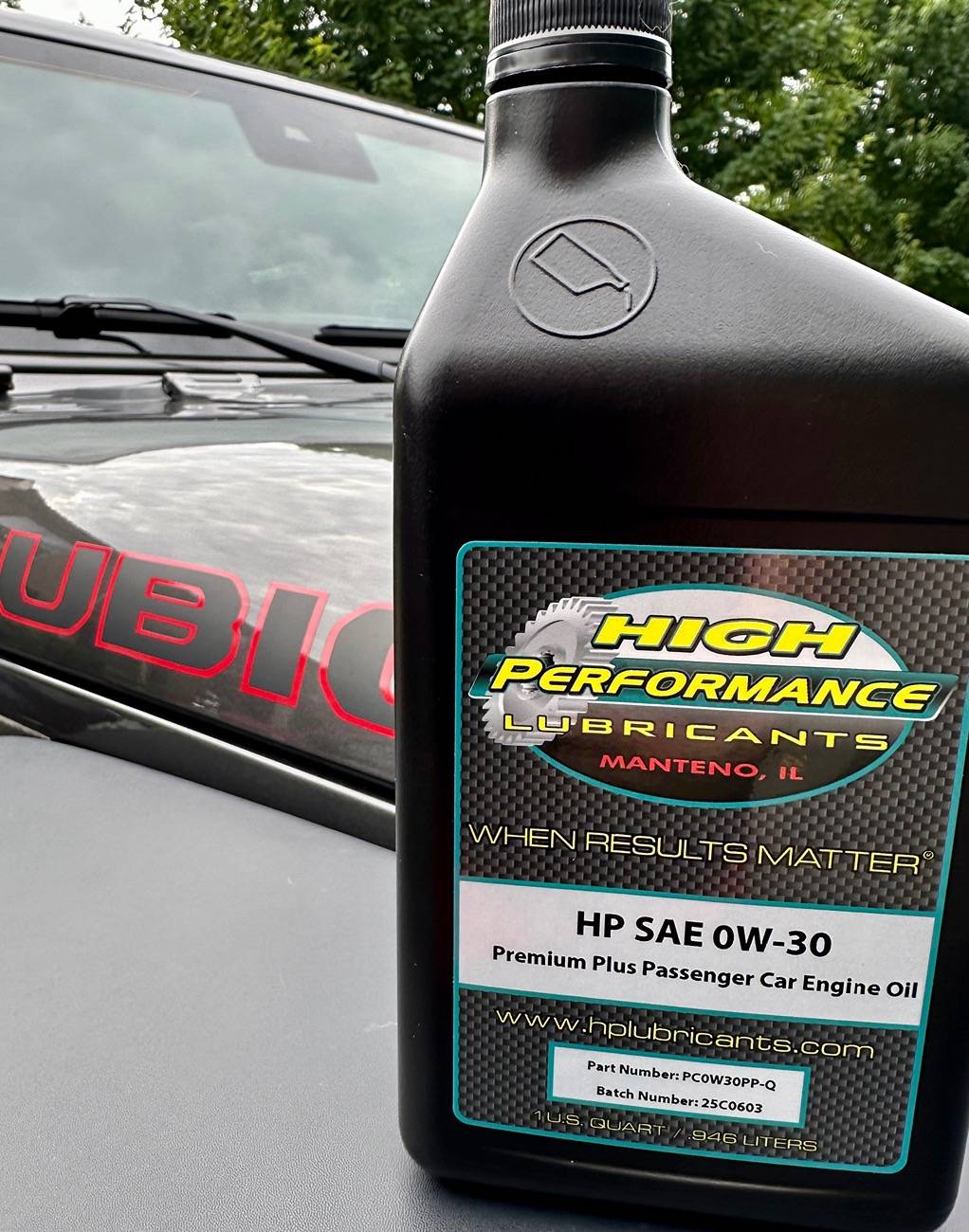

Team 0w30 for the win! I noticed the same when I switched mine a few thousand miles ago to the same weight. I went with HPL and it’s been great so far.
HPL is good stuff
