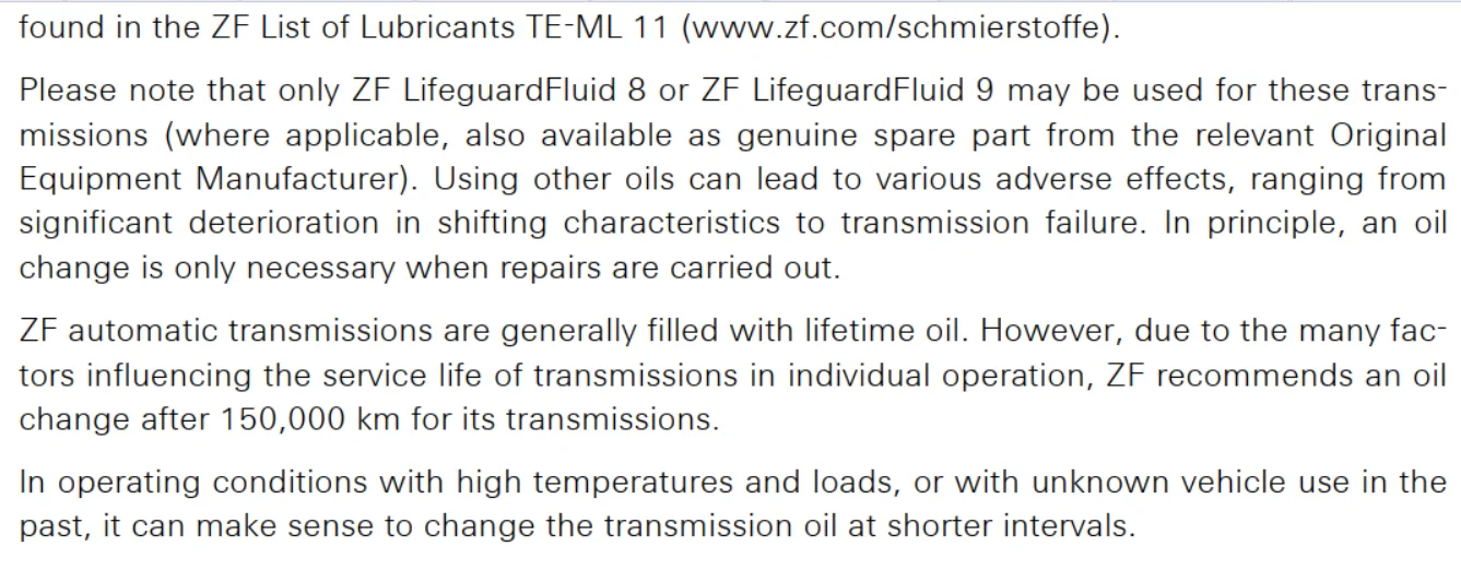

Back in 2016, ZF recommended 80K to 120K KM (50K to 75K MI) change intervals on their 8 Speed Oil Change Kit documentation. By 2022 and with their latest 2024 dated PDF for the 8 Speed Oil Change Kit, mileage recommendations were removed.
That basically leaves their latest TE-ML 11 document dated 2026 now recommending a 150K KM (93K MI) change interval for the ZF 8 Speeds as @ShadowsPapa mentioned. This document is the first I have seen ZF use the term "Lifetime Fill".
Anybody recommending 80K to 120K KM (50K to 75K MI) change intervals is only incorrect in that it is outdated recommendations now having been superseded by 150K KM (93K MI) change intervals by ZF.

If you bother to read the actual publications posted above it says…
5-, 6-, 8- and 9-speed as well as 4HP20 automatic transmissions:
ZF 5-, 6-, 8- and 9-speed as well as the ZF 4HP20 automatic transmissions are filled maintenance-free with specially developed semi-synthetic ATF oils. However, due to the many factors influencing the service life of transmissions in individual operation, ZF recommends an oil change after 150,000 km for its transmissions. In operating conditions with high temperatures and loads, or with unknown vehicle use in the past, it can make sense to change the transmission oil at shorter intervals.
please read the last two sentences…
We all did. That is exactly what I said in response to Hootbro if you read my response. Our point was that it does say lifetime, and it doesn't give the specific numbers otherwise mentioned - those are OLD and do not apply. So it's you missing the point.
Go read our posts again.
50K-75K is old, outdated information. It does use the term lifetime and does state shorter may be needed. Nope, we didn't miss anything.

We talked about service intervals for the automatic transmission back in September.
From a different post:
  • See doc #2 (sixth paragraph) for the service interval of 150,000 km (93,000 mi) for normal driving
  • See doc #2 (sixth paragraph) for the shorter service interval, unspecified, for severe duty
  • See doc #3 (sixth paragraph) for the same service interval info provided in doc #2
Each of the docs on the list above is the latest from ZF. Each link to the ZF website is also provided.
It is reasonable to believe that 1) the ZF licensing agreement has a reporting requirement, and 2) ZF has access to relevant licensee service records. As @Hootbro has shown us, ZF occasionally publishes updated guidance. If ZF didn't do this, "life of the vehicle", from the owner's manual, would be our only service interval guidance for the automatic transmission.
As for "lifetime oil", I believe that ZF included this language in each PDS to enable some of their licensees to meet CAFE requirements. However, in my opinion, it doesn't make sense because the specific service interval of 150,000 km (93,000 mi), for normal driving, is shown in the next sentence in the same paragraph.
Content from the Jeep owner's manual is also provided in the same post, but it is not helpful for service intervals.
For a Gladiator, what many might consider normal driving can be classified as severe duty. Frequently driving faster than 70 mph, in temperatures above 90°F, and in stop-and-go traffic are each considered severe duty.
Also see "What is Severe Duty?" at the beginning of Fluid and Filter Lineup.

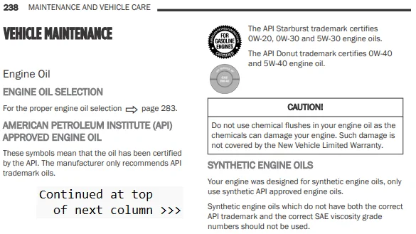

The current 3.6
Your finding about grades being no different outside of the U.S. means The Motor Oil Geek will need to change part of his video (starting at 0:54).
Note: My opinion about the five (5) grades is my interpretation. I am still investigating this with Jeep and the issue is not settled. 0W-20 is recommended in the owner's manual.
I still think that Jeep meant what they said when they added viscosity grades to the revised 2020 owner's manual. 0W-20 is recommended and four other grades are listed. However, there are some differences between the advice in the revised 2020 owner's manual and the 2026 manual. I plan to contact Jeep about the differences.
- Changes: In my opinion, the changes are a result of loosening CAFE standards (crossed out because the revised 2020 owner's manual is copyright 2022)
- Inconsistent viscosity grades: While there are three grades in common, advice on viscosity grades for the 3.6L engine in the Jeep Gladiator is different for the two examples discussed in this post
Assumption: A viscosity grade listed in the owner's manual may be used; see fact #3 in key facts about motor oil compliance and viscosity grades. I think that this is a safe assumption, but this will not be settled until I contact Jeep.
The advice on 1) page 251 of the revised 2020 owner's manual and 2) page 238 of the 2026 owner's manual (below) are written differently. In the revised 2020 manual, there are no conditions mentioned for the other grades listed. However, in the 2026 manual, the grades are grouped by API trademark type and the reader is redirected to page 283.
Viscosity grades listed in revised 2020 owner's manual:
- 0W-20, 5W-20, 0W-30, 5W-30, and 10W-30
- Unlike the 2026 owner's manual, this advice ends here (no continuations)
>>> Grades in common: 0W-20, 0W-30, and 5W-30 (in both revised 2020 owner's manual and 2026 manual)
Viscosity grades listed in 2026 owner's manual:
- API Starburst trademark: 0W-20, 0W-30, and 5W-30 (5W-20 and 10W-30 are not listed in 2026 owner's manual)
- API Donut trademark: 0W-40 and 5W-40 (0W-40 and 5W-40 are not listed in revised 2020 owner's manual)
2026 owner's manual, page 238:
Jeep Gladiator Oil - going from 0w20 to 0w40 1783396716866-di
2026 owner's manual, page 283:
Jeep Gladiator Oil - going from 0w20 to 0w40 1783400641745-at

Looks like its ok to use the other oils mentioned 5w30,0w30 and so on,correct.
It is just explaining what the API Starburst Trademark certifies and is not endorsing use of those grades in the JT. Still is only calling out 0W-20 in the recommendations.
It is obvious that I believe this is more than just a list of grades that API certifies. If they were going to stick exclusively to 0W-20, they would not have revised the 2020 owner's manual. Also, if this were just a list of grades that API certifies, they would not have omitted 5W-20 and 10W-30 from the 2026 owner's manual. The starburst is still right there on the front label of Mobil 1 EP 5W-20.
Also see the justification in a different post. This information has been out there for more than a year.
In all cases, 0W-20 is still recommended.
I will not consider this to be settled until I contact Jeep.
