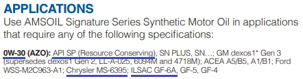

For what it’s worth. Amsoil claims that their 0w-30 SS is suitable for MS-6395 requirements. I know it’s not official, but does give some reassurance.
