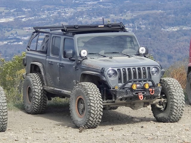

I have two 7" "Oh, I can see Canada from here" LED spots on the bumper, the little pods on the cowl, and I've had a few mounted on the bed rack for campsite & bed illumination. The cowl ones are ok, but I really need to yank those off. Combination of not bright enough and an odd angle for me.
The big spots are fantastic. They illuminate wayyyyy down the road. On road the drawback is reflections from road signs. The lights make anything reflective pop from probably a mile away. There is a straight stretch of I90 in Montana east of St. Regis we were on once in the middle of the night. I flipped the lights on and we could see the markers curve to the right way off in the distance.
Jeep Gladiator Is there a guide or general practice with regard to supplemental lighting on a Wrangler / Gladiator? 1769537139097-zg
I've been wanting to put a few up on the roof rack to help light up the ditch area and beyond, as we drive a lot at night where we're in mountains with no other light sources. It'd be nice to know if we're on a gentle plateau or a narrow ridge with a 2000' descent on either side. Also, illuminating the sides may help us ID wildlife in our late-night drives through the National Parks. The front spots aren't optimal for winding roads that are in parks like Glacier or Yellowstone.
When you do finally pick out what you want, you can pay the premium and get well-known brands like Baja Designs, Diode Dynamics, or save some coin and get the cheaper stuff. Before you make that decision, watch the YT videos from the guys who have tested the lights and actually do a good comparison.
I had some Hella lights a while ago, which used to be a pretty good brand. In less than 1yr of being mounted, the bulb assembly popped out of the housing. So that was nice. <eye roll> So I don't prescribe to choosing one brand over another. There are only a few manufacturers of LEDs, so the light companies pretty much using the same light source, just different wiring & circuitry, quality control, and customer service.

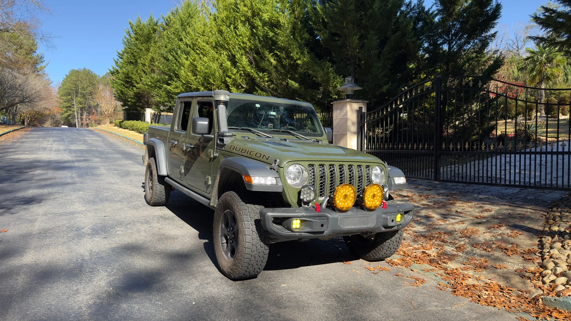

Small ambers angled out with larger amber on the bumper. Spots on the A pillars with a good set of flood ditch lights. Best setup I have had on a Jeep and not too much.
