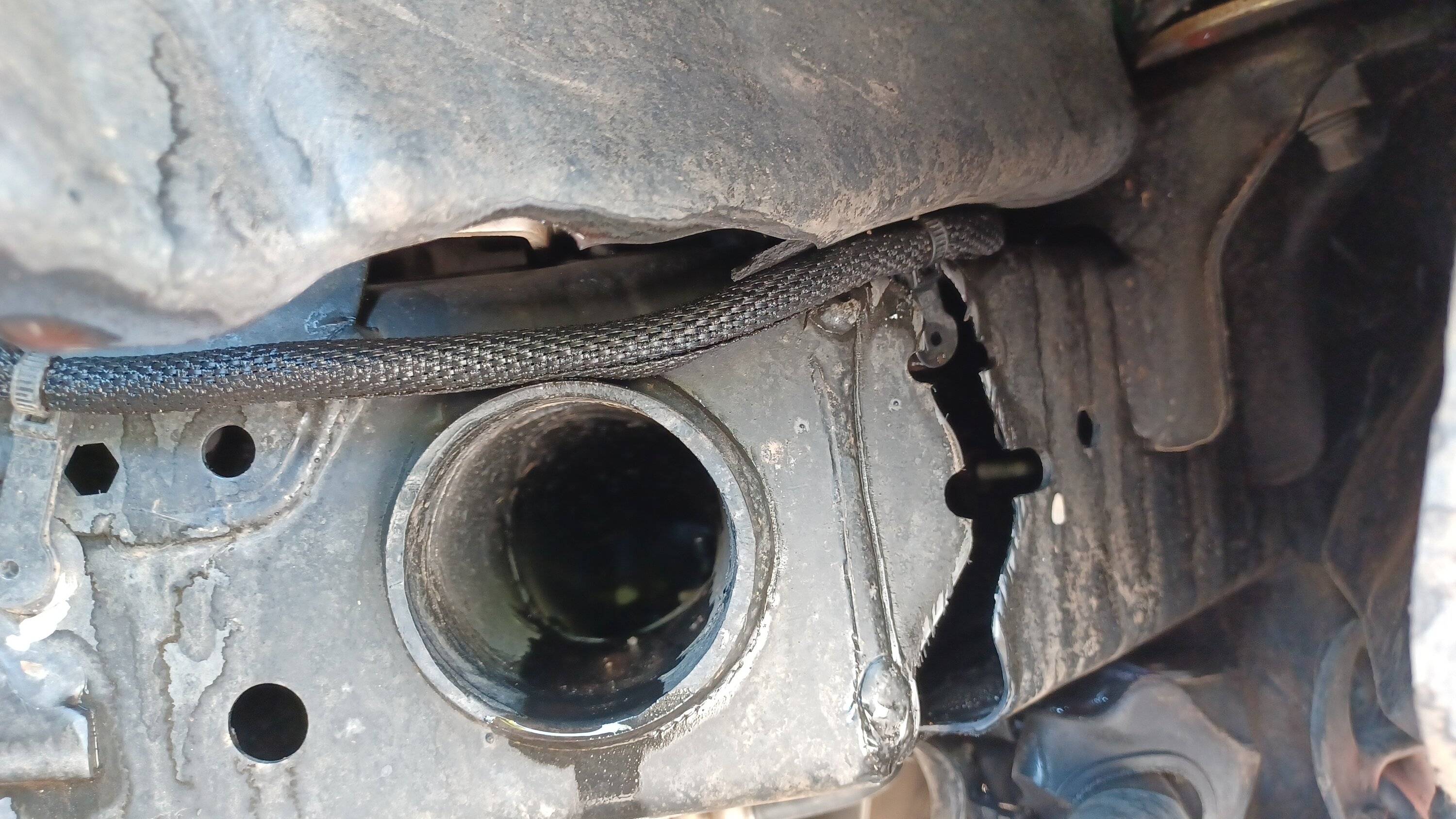

It’s a sad day for my baby. I got rear ended by a Ford F-250. I don’t know what hurts more…

This frame is definitely bent.
Obviously. There’s not that much flex in the bed without doin the frame. Ooh. But it’s behind the axle? That’s not really “frame” for the purposes of making it drive right.

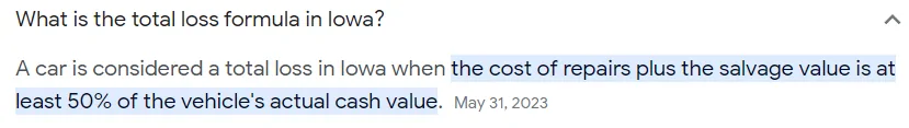

States don’t have anything to do with totaling a vehicle…. Maybe there’s some weird exception somewhere. Strictly a business decision by insurance.
I’ve seen a lot less effed up trucks get totaled…. Frame involvement is usually a can of worms they don’t want to worry about.
You are right and wrong..........
While that's generally true..........States often control what insurance companies do. Each state has their own rules. And if in your state the insurance company will not total your vehicle and yet it meets what the state sets out as a totaled vehicle, you can go back and say yes, the state of xxxx says it's totaled. It matters for salvage titles and other things.
If the insurance company won't total the vehicle, you can sue and depending on the state, you may have some leverage (see below for Iowa's rule)
Jeep Gladiator It’s a sad day for my baby. I got rear ended by a Ford F-250. I don’t know what hurts more… 1691297190628
Armed with that and diminished value, you can often win and get a vehicle totaled, DEPENDING (and on the state as well)
This from an attorney specializing in such things -
Of the 50 states, 22 leave the total loss threshold up to the insurance companies to define (with some qualifications), while the remaining 28 (and District of Columbia) define set thresholds.
So this is one of those things where there is no one single answer - it depends on where you live, your insurance company and other factors. You can present facts and figures and negotiate - even convince them in many cases, in extremes, you may be able to sue. And using diminished value plus estimates from other shops - you may win (or not)
One of the crumple zones, perhaps. I'd bet that's not the only spot.
It's your truck...... but if it was mine I'd be going over it with a fine-tooth comb and looking at every single body mount, look for leakage (hydraulic mounts on these) and other suspension points, anchor points for everything, including engine mounts. Impacts put the rules of physics into play - objects with mass when at rest want to stay at rest so if the frame is shoved forward and the engine wants to stay put - things can get messed up, including axle tube damage and transmission case cracks. Look at where the axle tubes go into the cast differential center housing, things like that.
Maybe nothing but you don't want it repaired only to find trouble in 6 months after you've settled and signed the papers holding them harmless of any future claims.

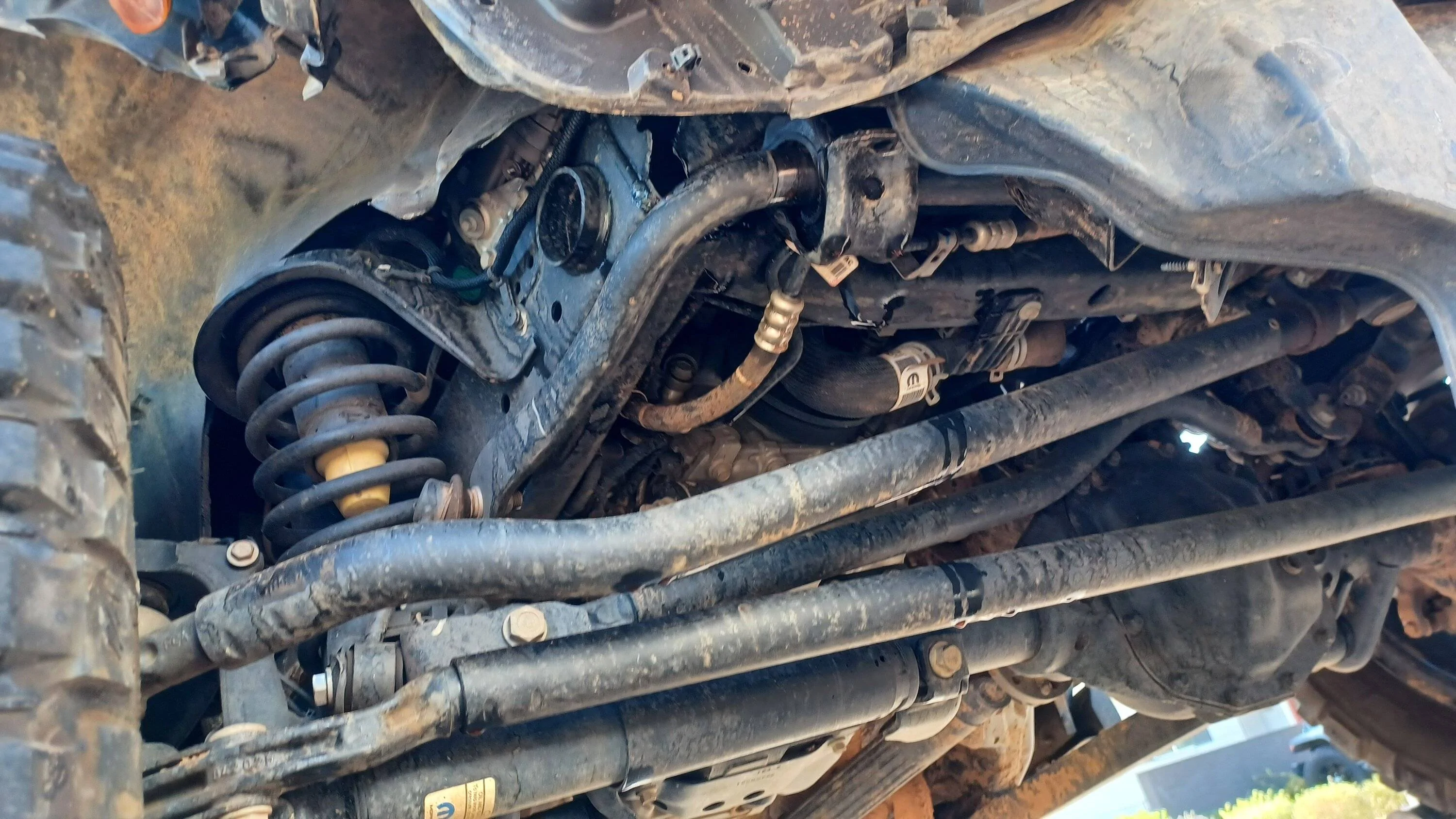

Jeep Gladiator It’s a sad day for my baby. I got rear ended by a Ford F-250. I don’t know what hurts more… 20230729_161728
Jeep Gladiator It’s a sad day for my baby. I got rear ended by a Ford F-250. I don’t know what hurts more… 20230729_162347
Jeep Gladiator It’s a sad day for my baby. I got rear ended by a Ford F-250. I don’t know what hurts more… 20230729_162352
