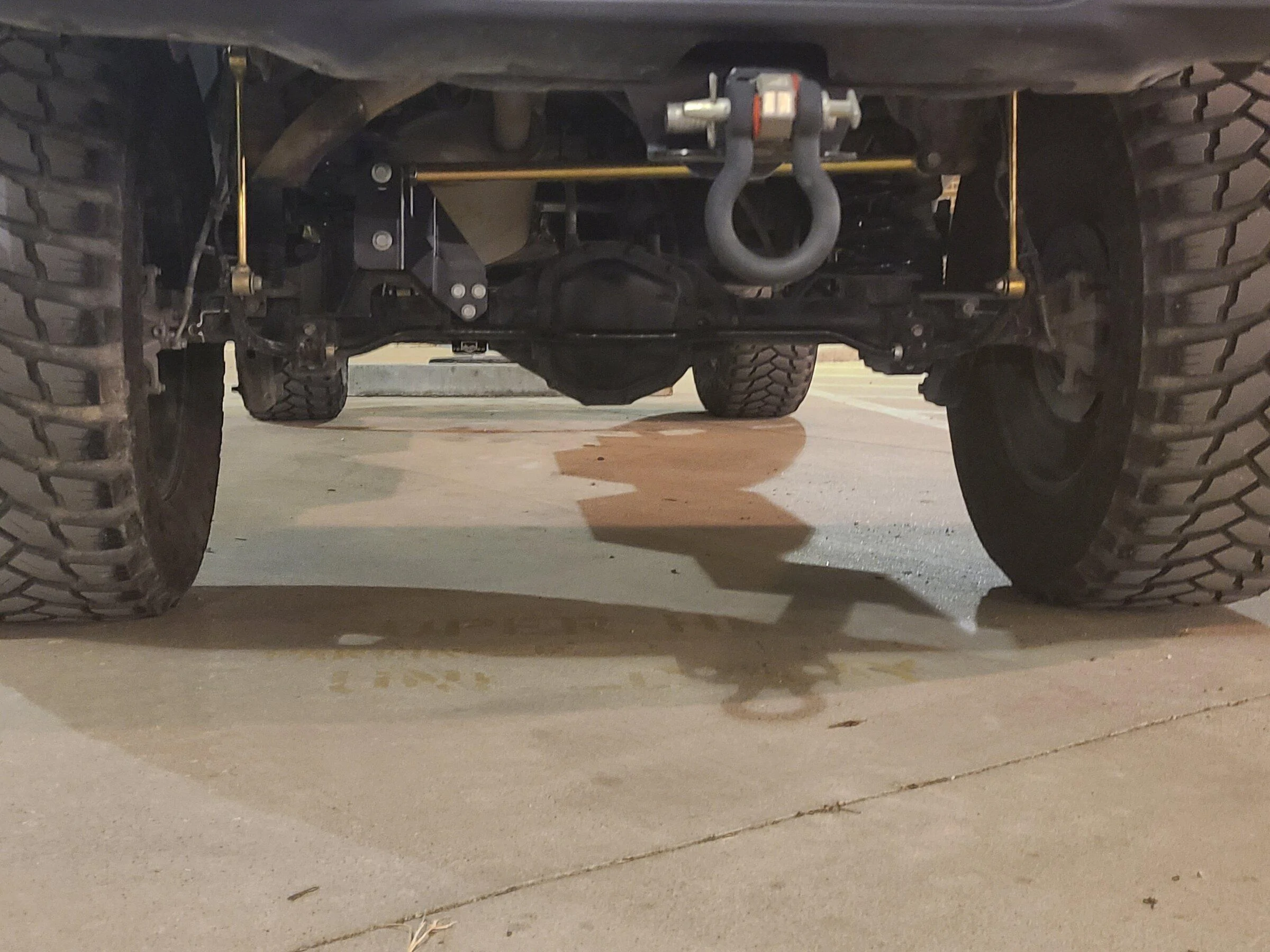

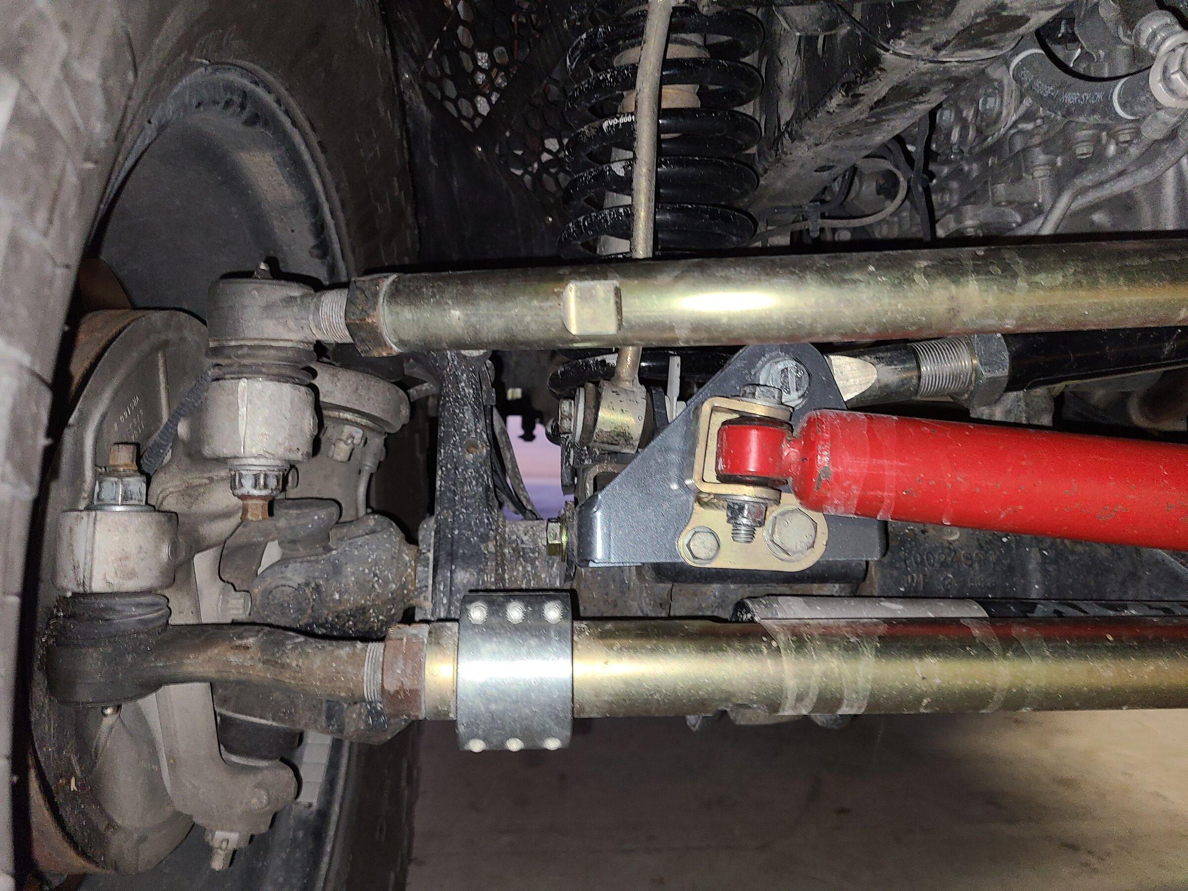

The same thing happens to mine like clockwork - this my 3rd Winter in the Gladiator and it has happened every year. I won't get into what's DW or not but I have replaced just about everything on my suspension and my steering components battling it. The latest round of mods were the Synergy drag link flip and the Teraflex rear track bar bracket. I have been more satisfied with the improvement from those 2 brackets than pretty much any other change I've made.
