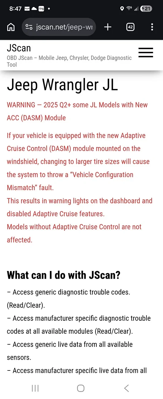

Well, 2 long power cycles didn't work. I guess I'll try getting another Tazer. Apparently there are "some" JT's and JL's between 25.5-26 model year that experience this problem. MDH on this build is 020710. Feb, 7- 10am. Tazer supposedly has a "fix" for these builds that are affected. Maybe the dealer could be an option too. Frustrating when things dont work like they should.

Here's a screenshot of what I found on J scan support page. Z automotive apparently has a fix for these vehicles that are affected by the faulty module that FCA wont replace. From what I can find, FCA realized there was a problem with some of the modules and corrected it but if you have a "bad" one, youre sol. I have an email out to ZA to see what they say.
