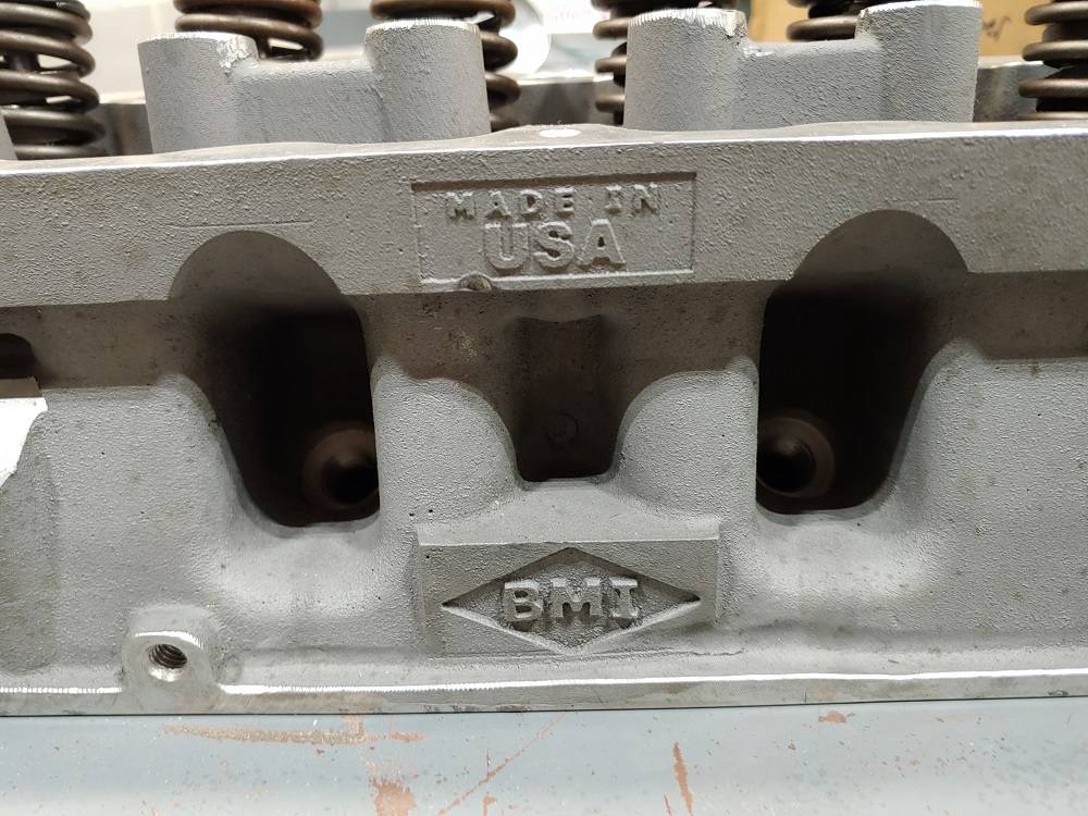

The original 0331 was the problem (2000-2002) the TUPY was the solution - still a 0331, but thicker deck.
or
This head although this is one of only three known to exist -

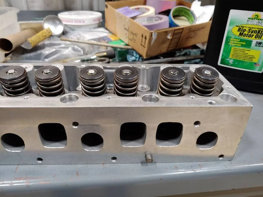

Jeep Gladiator Jeep Technician (And Gladiator Owner) Discusses Common Questions and Problems on TrailRecon BMI-head
Jeep Gladiator Jeep Technician (And Gladiator Owner) Discusses Common Questions and Problems on TrailRecon clifford-head-2

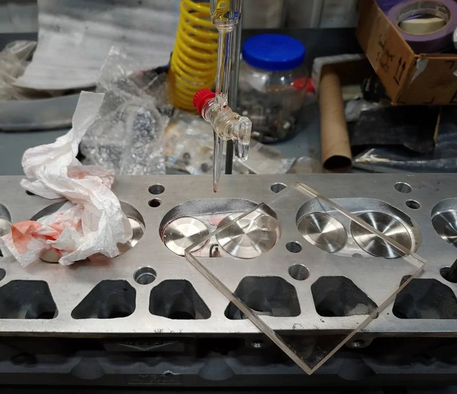

I was curious as to what the chamber size was on this head - matches stock perfectly. (but I had the 4.0 head for my Eagle's engine shaved by 0.024" so it's not really stock CC any more)
