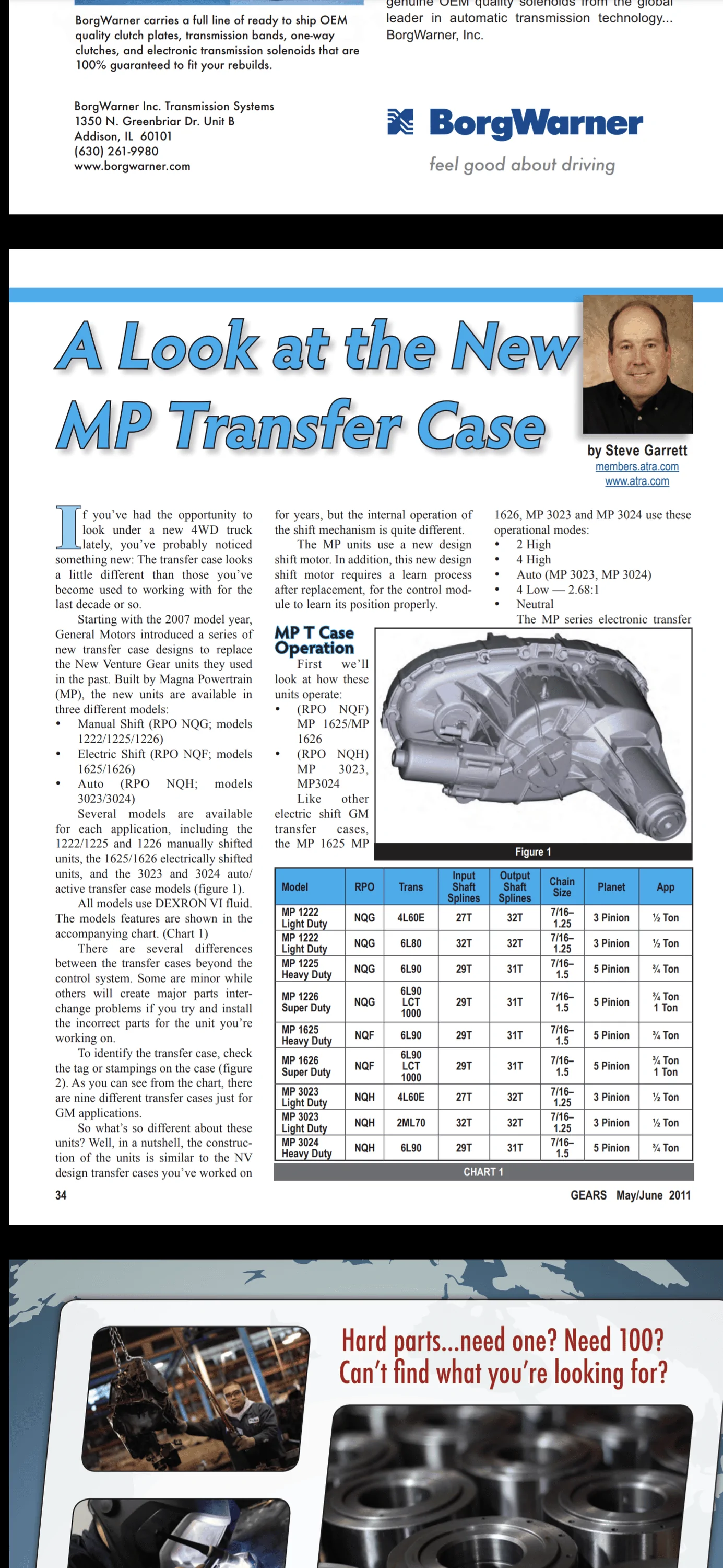

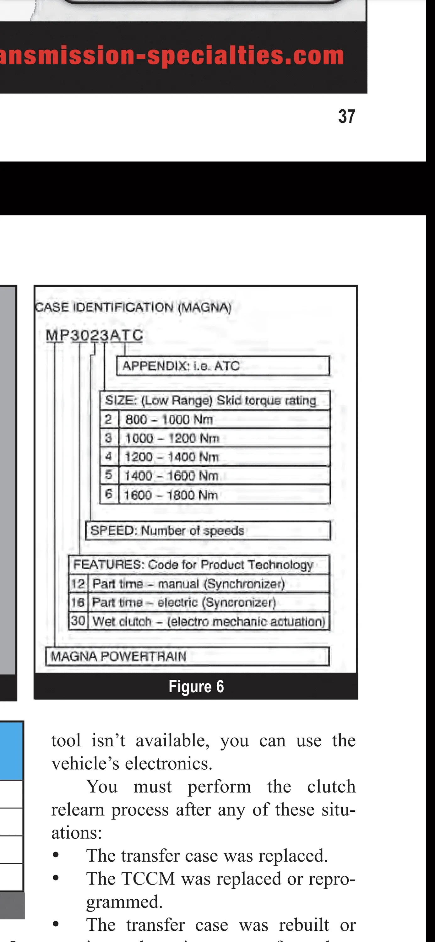

Found this article that helps with decoding model number.
Jeep Gladiator JT Diesel Selec-trac Screenshot_20221024-174629
Jeep Gladiator JT Diesel Selec-trac Screenshot_20221024-174616
