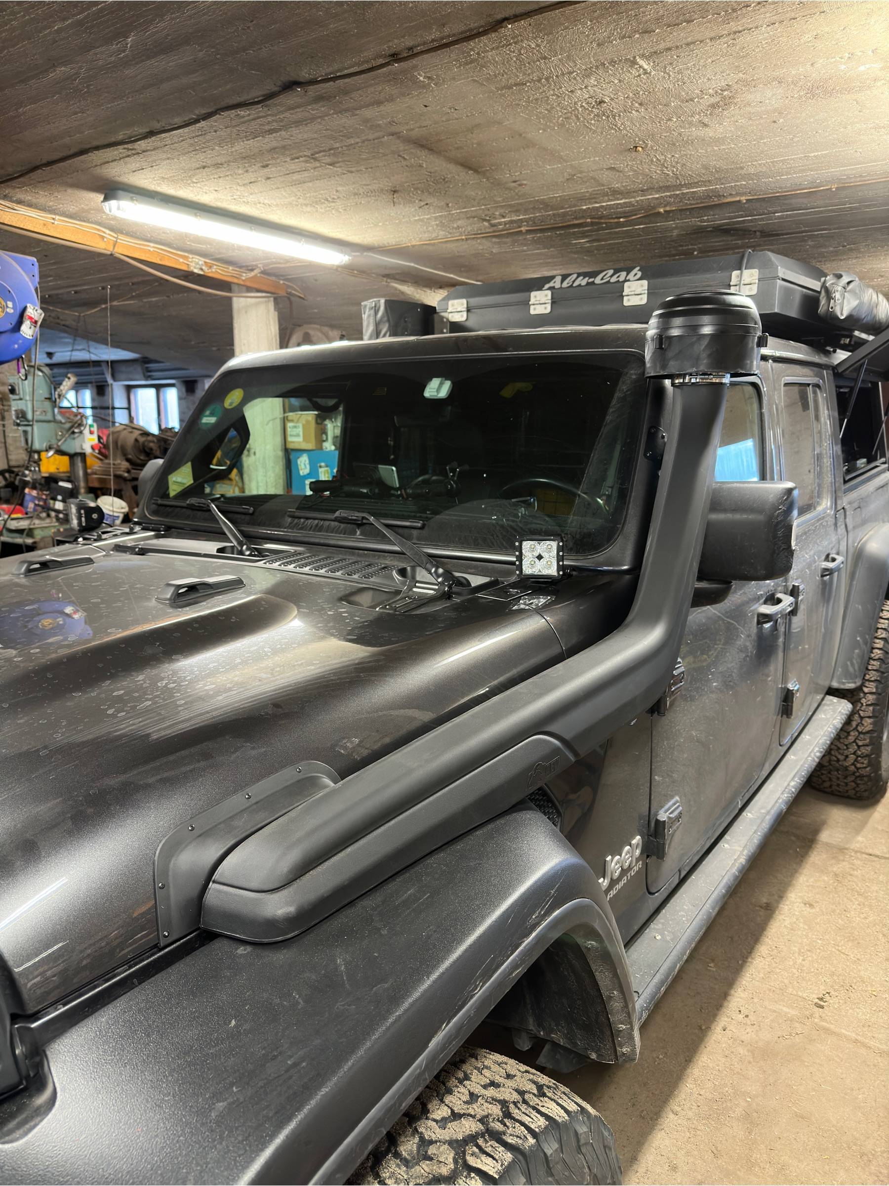

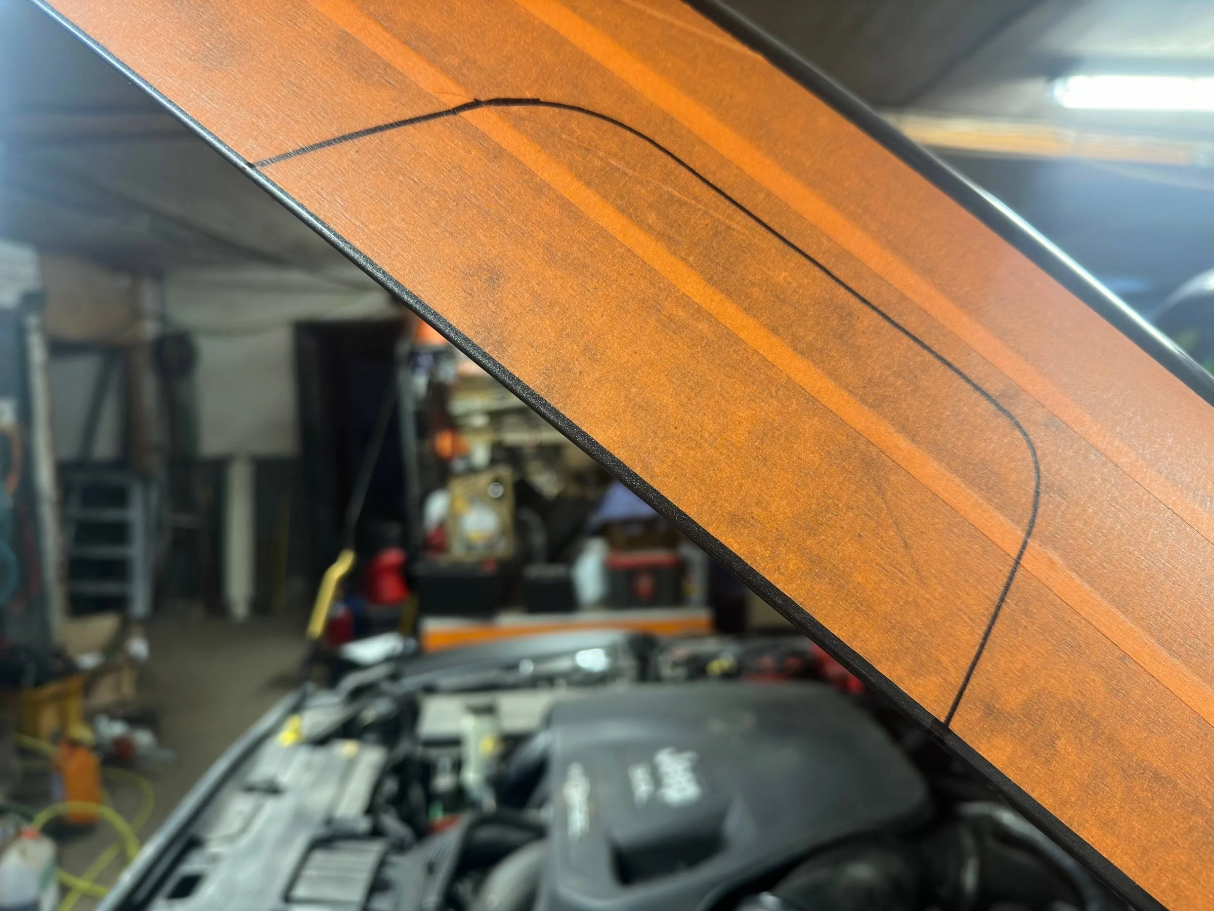

AEV Snorkel fitted to Mojave/Euro hood.
Just had to draw the hood cut by myself and also cut the inside lip from the bezel.

Yeah but the AEV snorkel is the ugliest one ever made other than home grown ones I've seen ?

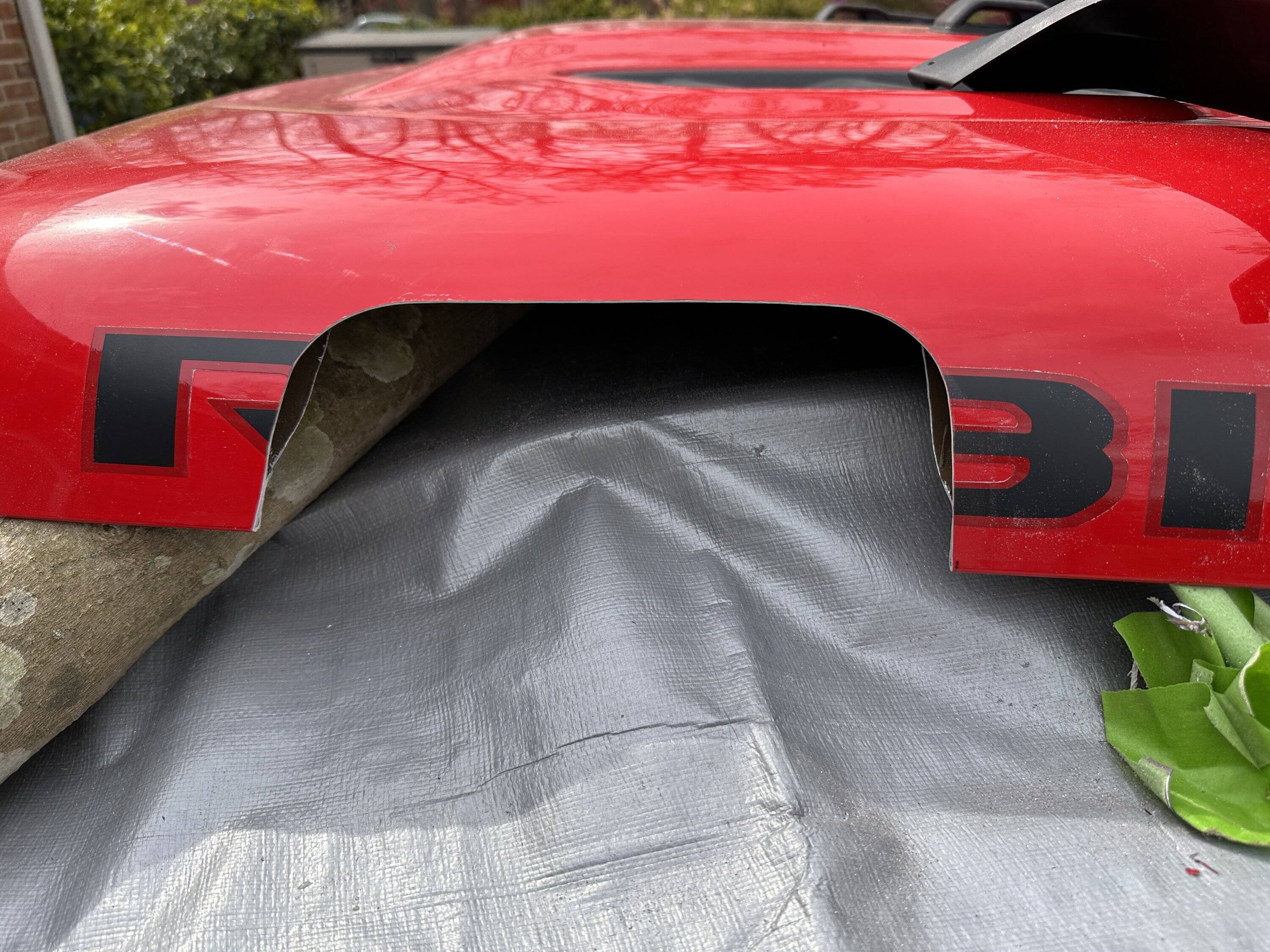

Not trying to beat a dead horse but that is the cleanest cut I have ever seen.
What was your procedure? Hole saw then nibbler on the straight cut?
Yep, but I also cut short of my line and used grinding stones and a sanding drum, if I remember correctly, to make it smooth, checking the fit with the piece from AEV.

So, how much did you cut under the line?
I sure do not want to over cut but don't want to do too much post processing either.

So, did you cut at the line on the template, just under or over?
It’s been a while, but I’m sure I undercut a little. You can always remove some little by little. You can’t add it back once it’s cut. You’ve got some leeway since the cowling overlaps the hood a bit.

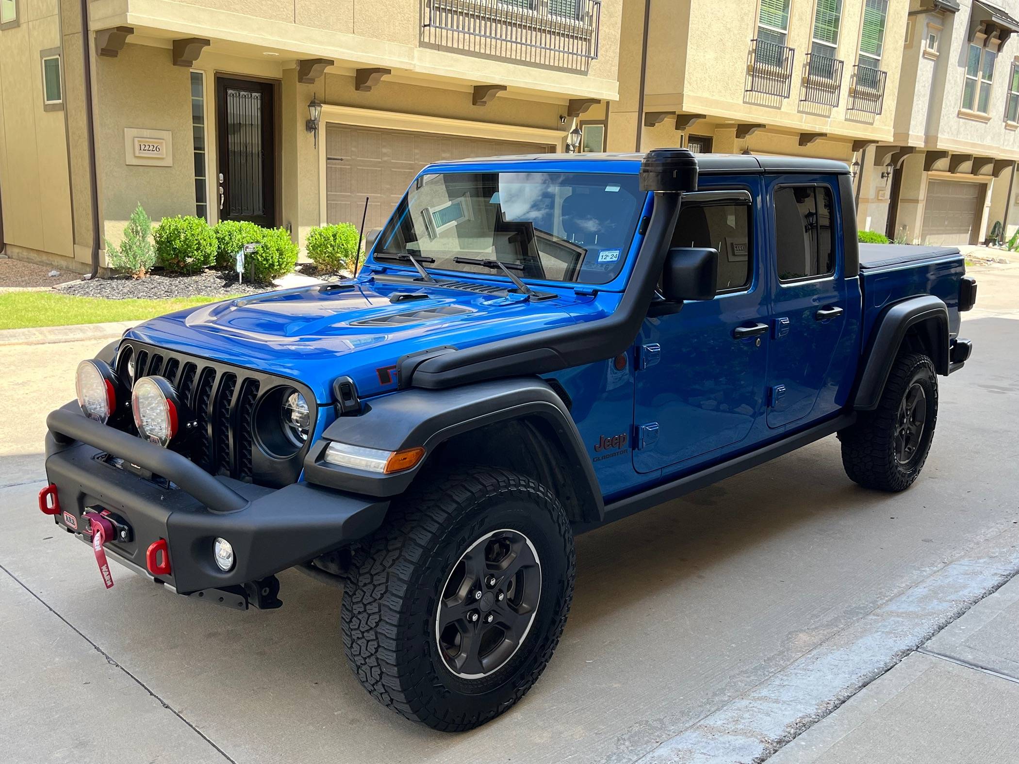

WOW... I just install it over the weekend...
2 DAY, sorry but it takes me about 10 hr. ... but on the end it was done.
Question do I need to take to delephip for TSB install "update the software" on the PC.

What year JT? Think it was the early Eco's the need it.
