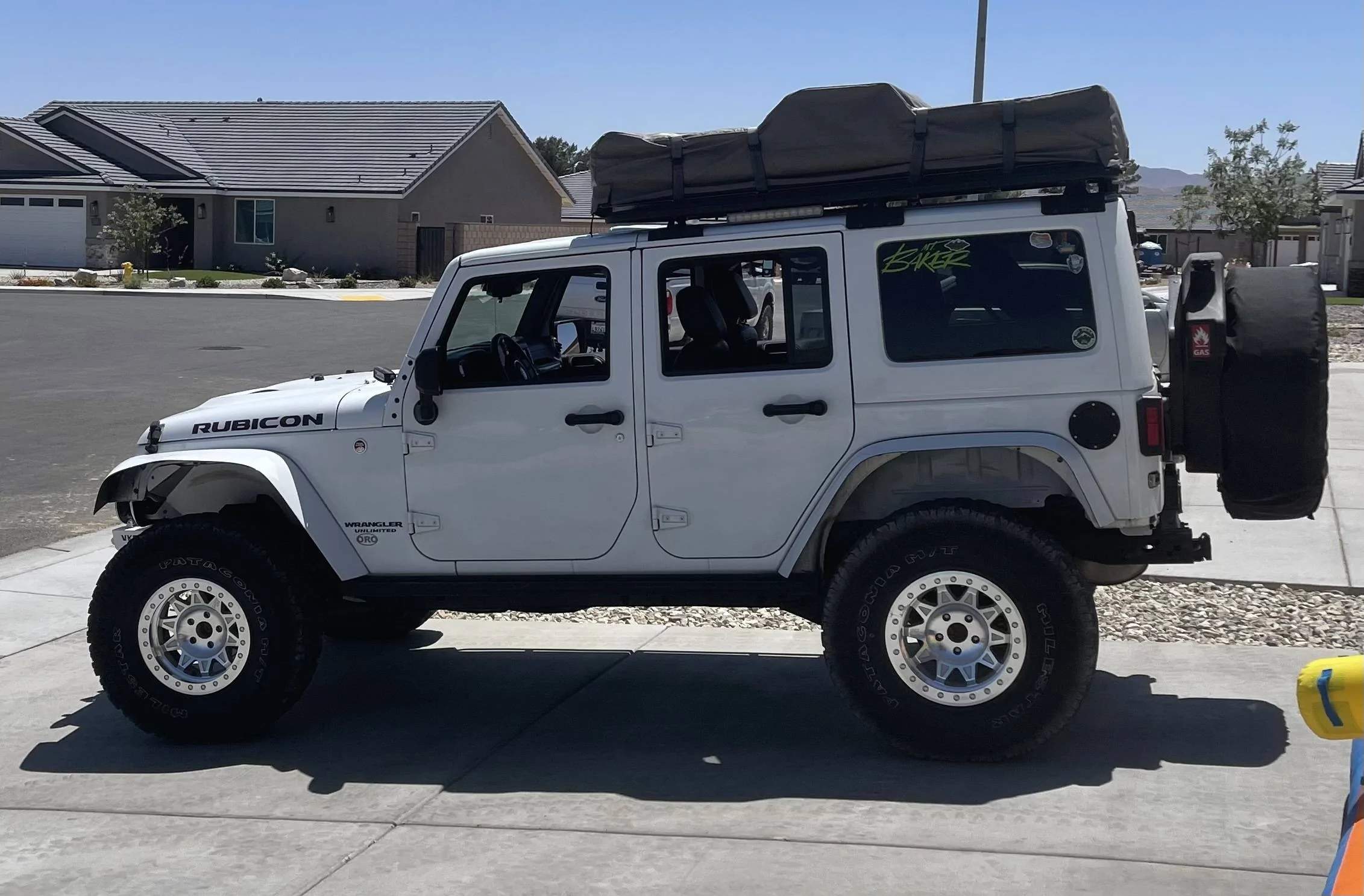

Not trying to be the bad guy here…. Just saying it’s a lost cause. I have added frame mounted rocker guards, a leer topper, decked system full tank and me in it we are way too close to weight rating (I’m 225). No wife, kids or dog to point the finger at. This “truck” is a joke…. It’s only saving grace is the wrangler is equally as easy to hit the weight rating on ??‍♂
We are continuing the build regardless. Definitely going to be trussing the front and rear axle’s as a precautionary…. Outside that, not going to bat an eye at it. The brakes are more than adequate for a fat build.
Pretty much any overland build is going to exceed the rating.
Here is our jk sitting 300+ over limit without gear. (And to think this was 37’s- 40’s would have put us another 110 over weight….)

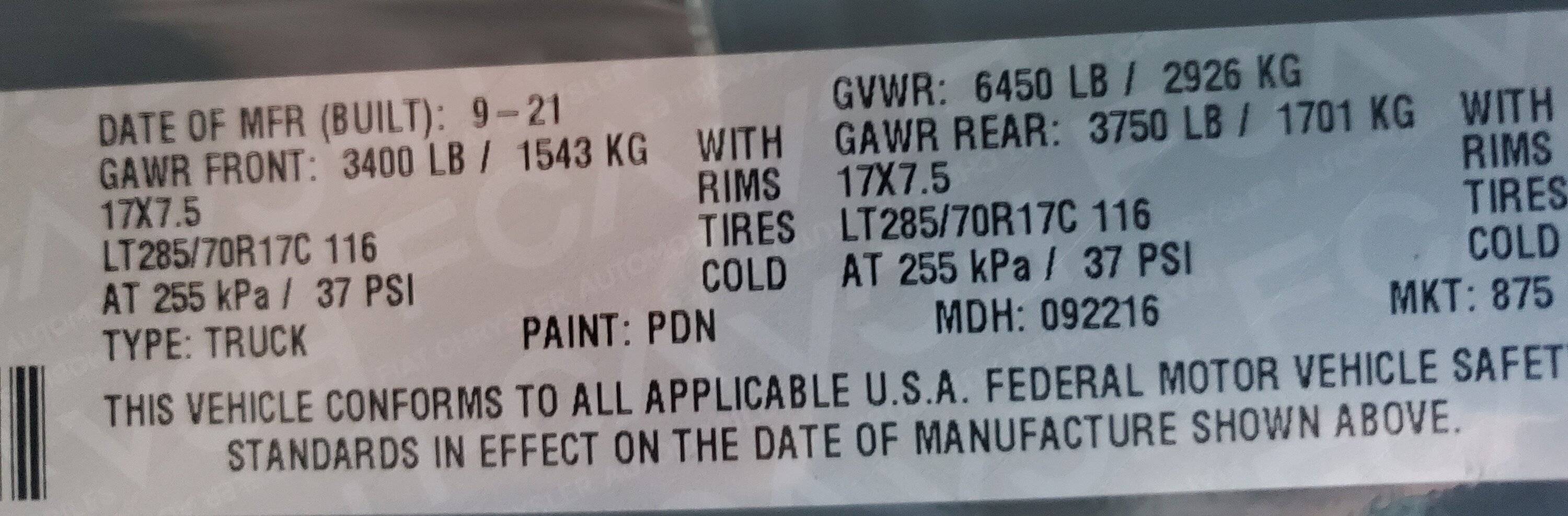

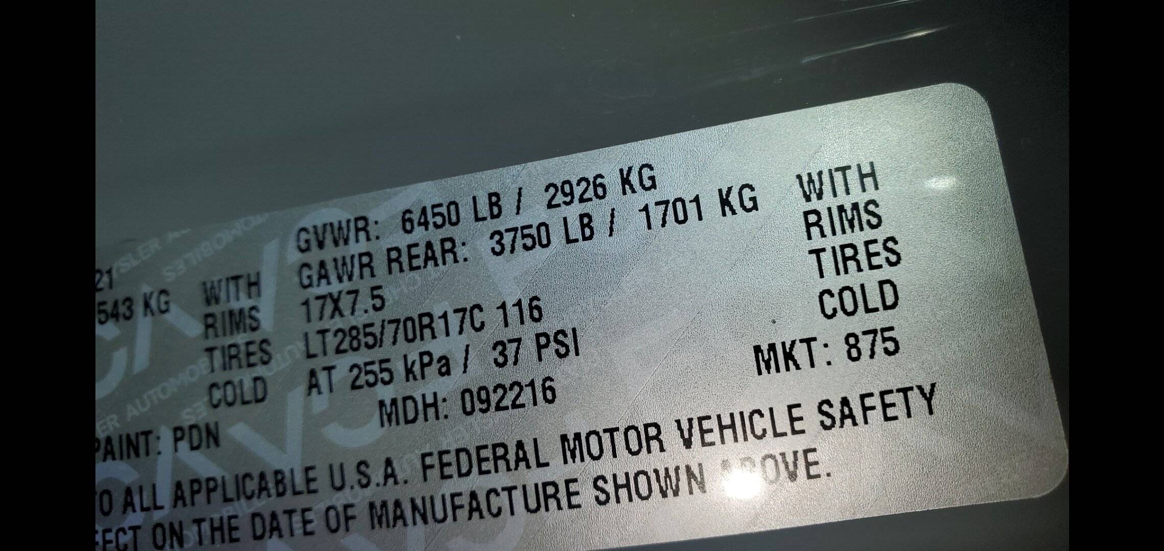

Don't see payload on the sticker. It says GVWR is 6450, so that's different from anything I've read. Where is the payload sticker??
Jeep Gladiator JTRD Base Weight vs My Weigh w/limited Adds 1671597721852
You also mentioned "base weight" - where did you get that number?
That's a stripped down truck, no options at all, no bed liner, base tires, etc.
Sadly that's what the auto rags use is the base weight.

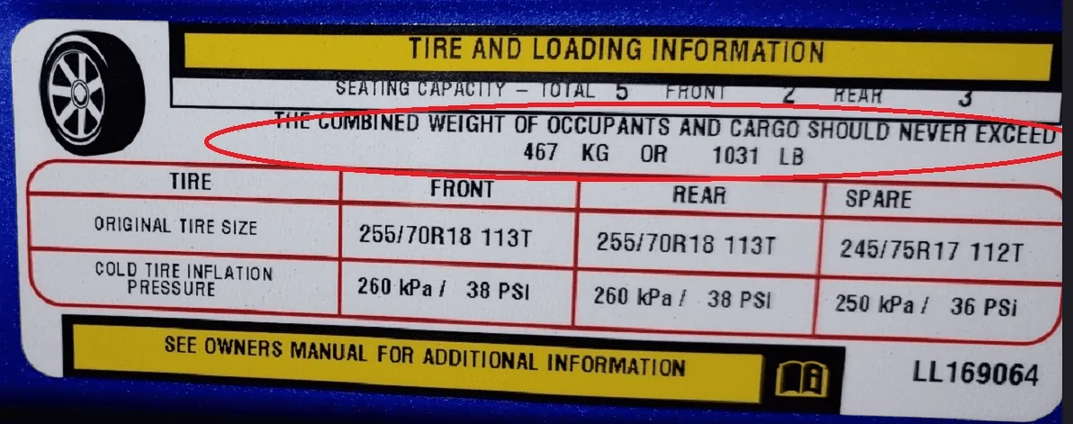

Specs say the base weight is 5,072. I added the Mopar 2" lift kit, Falken 35x12.5 MT's, and ASFIR skid plates (70#). I just weighed in at a CAT scale at 5700#, full tank, nothing in the Jeep, not even me. How did it get that heavy? And with GVWR at 6,250 I'm now worried about adding Alu-Cab Canopy Camper plus all the accessories and gear, and staying w/in GVWR. I've read all the posts about GVWR and that many people exceed that, but that's not the point. How did I go from 5072 to 5700 by only adding those few items? Has anyone weighed their stock JTRD?
The answer is pretty simple. You didn't start at 5,072 lbs because that number does not include any factory options. The base weight of your JT is the GVWR listed on your sticker, minus the payload number on your Tire and Loading Information sticker (as circled in post #10). In short, you only have that payload # to work with to stay under the GVWR.

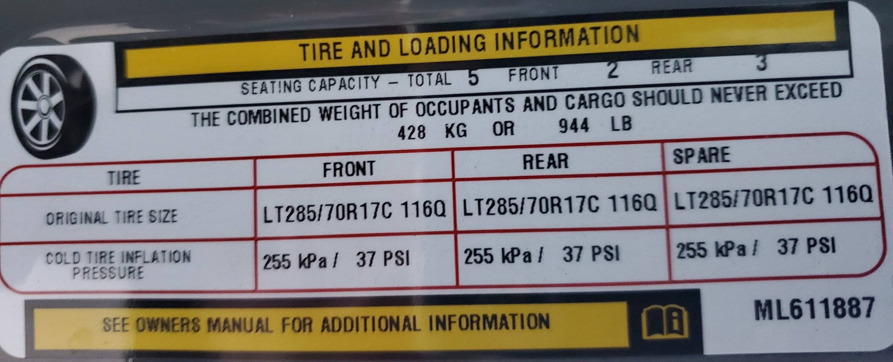

Here are the door sticker numbers:
6450 (GVWR) - 944 (payload) = 5506
Add 70 for skids = 5576
My CAT weight was 5700 (full tank & DEF, no passengers)
So the lift kit and bigger tires added 124#
Mystery solved. I appreciate all the feedback!!
