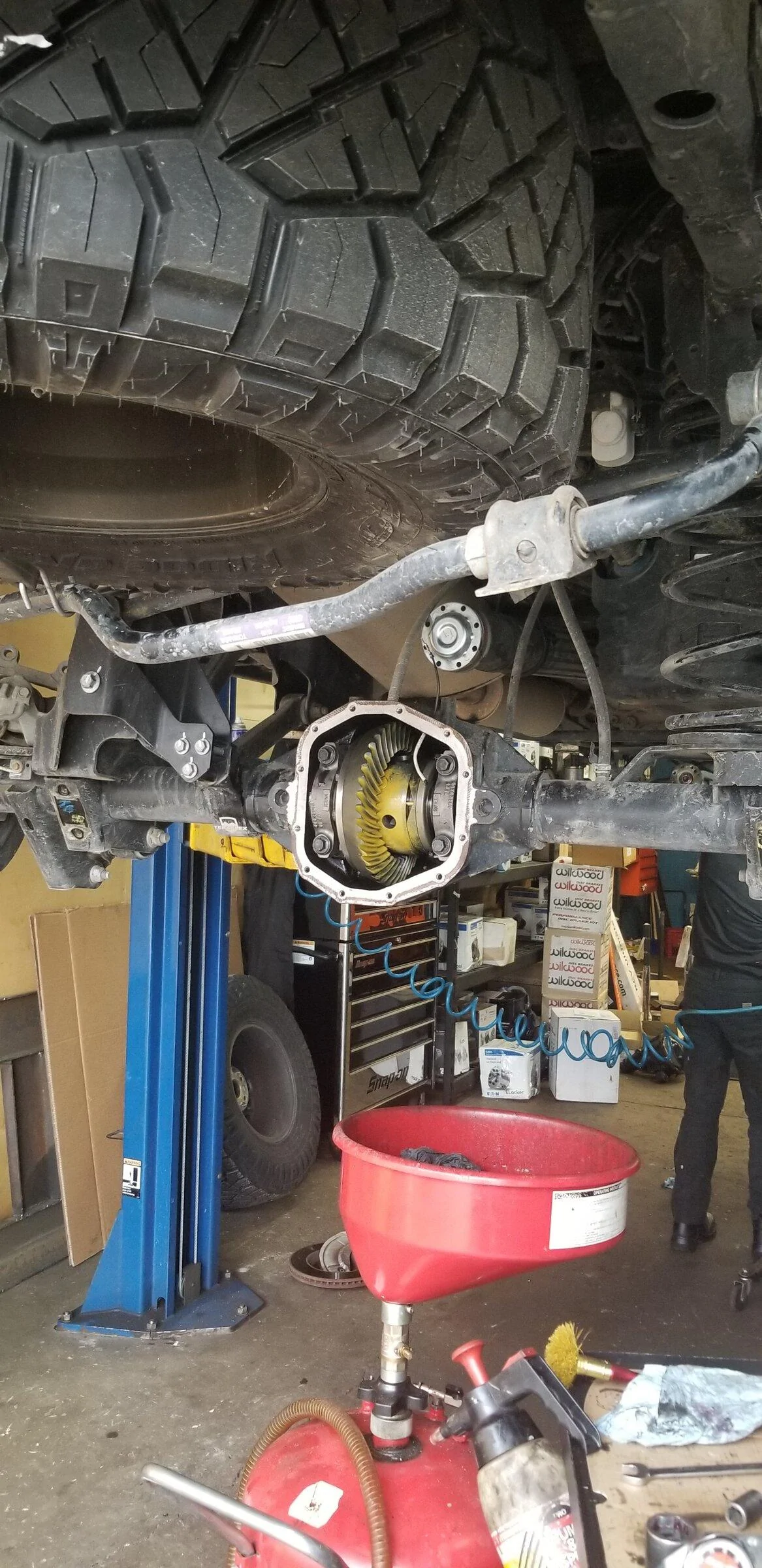

Just had Enrico's install Dana 4.88s on my Overland JT. Previous on stock with 3.73 and 35s I had lost so much power and mileage was terrible. On hwy I rarely saw 8th gear and moment a hill came, I'm on 4th/5th. Struggling!
Today with 4.88s I can feel the power again. Taking it easy for the first little while but already on hwy at 80km, I'm already seeing 8th.
For overland or sport owners thinking or have 35s, I'd definitely recommend 4.88s.

The diffs installed were around $2400. Worth every penny!
I already had the tazr lite installed, permanently attached. It was easy to reprogram the diff ratio, took a few minutes to look at the instructions. Do it all on the steering wheel controls.
Don't have issues with service leaving the tazr in. Just give them a heads up before so they expect it.

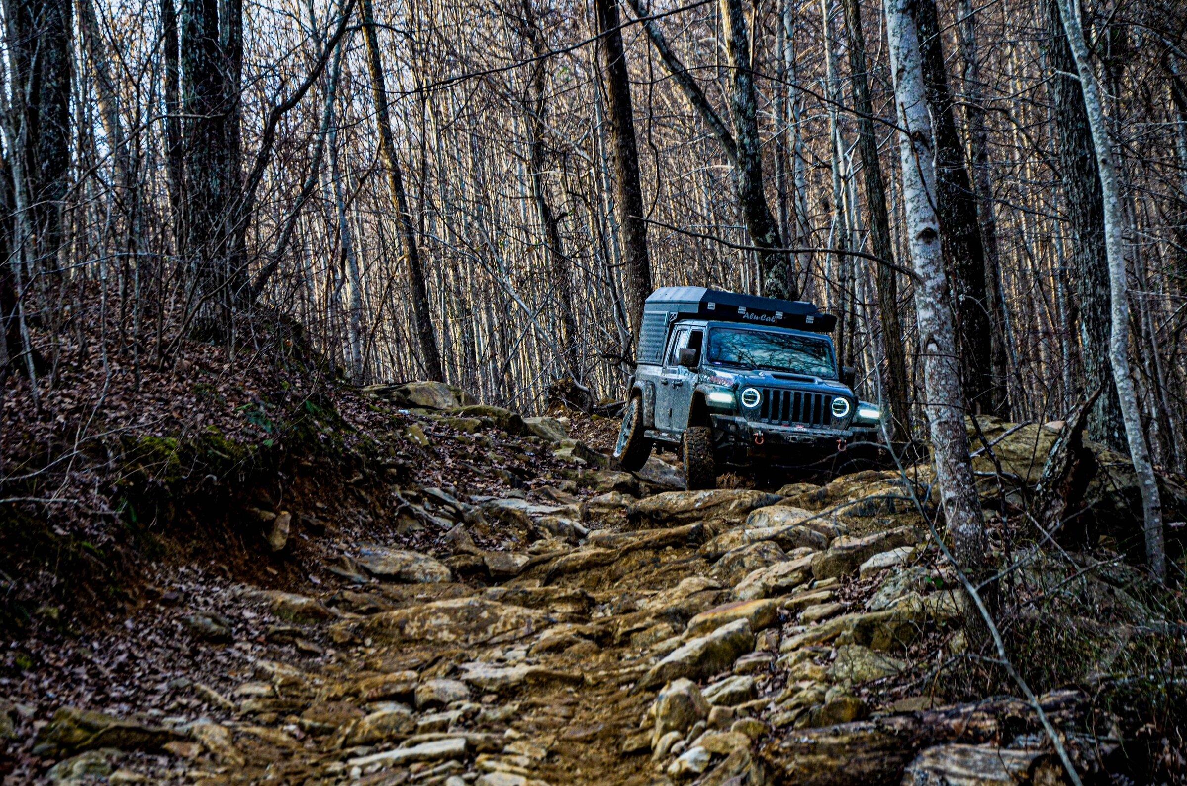

I get 4.88s at the end of March (assuming they are in stock by then like they are supposed to be). I am looking forward to seeing the mysterious 7th and 8th gears people talk about.
