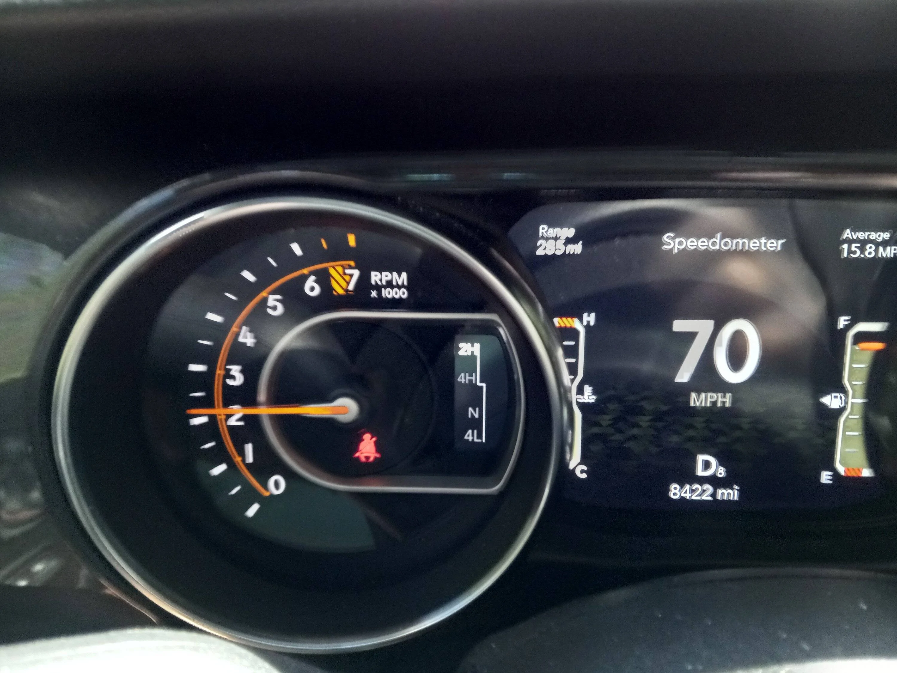

I would really like to get some feedback from you regarding the 4.56 gear swap. I have 3.73’s in mine and I’m having the same issues you were. I’d really like to re-gear so I can have some better power down low. This is my daily and I plan on staying with a 32ā€ tire but will probably jump from a 255 to a 285 down the road just for a wider stance. I was thinking about 4.88’s but I think that will be too steep with 32’s. What RPM are you running at 70mph with the new 4.56’s?
Just for you brother. This was today... I'm gonna call it 2,150 rpms
Now that’s what I’m talking about! Big thanks!!! Of course I’m running the slightly shorter tire, so I’ll be running a little bit higher, but that’s not bad at all.
