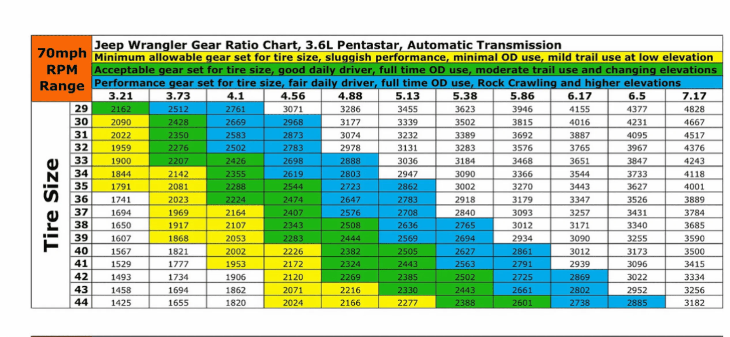

I’ve been going by this chart I found online. You have 4.56’s with a 33 inch tire and you’re running 2150 RPMs at 70mph. According to this chart, you should be running at 2698 RPM, unless this chart is calculating everything for 7th gear and not 8th because it is considered “overdrive”. Anybody out there familiar with this chart?
Gotta be an old chart - there's too many of that sort floating around.
No way I am running over 2200 at 70 mph
Please stop posting this chart. Its for the JK with 6 speed auto, not the JL/JT with 8 speed auto so its completely wrong and provides false info.
Thank you for clarifying the chart. Please understand that I wasn’t trying to provide false info. I only posted it hoping someone would be familiar with it because I wasn’t sure what platform it was for or where the calculations came from.

With the 8 speed the chart is closer to 80MPH speed in 8th.

I don't know where anyone got the impression that this is how an 8 speed should behave? It's a double overdrive with 7th being equivalent to the top gear in most transmissions. That's why a stock JL has 32s paired with 3.45s. It's not supposed to hold 8th under load. Be it a hill or a headwind it should be in 7th. Why gear it so low that it's in 8th at any speed over 40mph? It runs through the gears alright, and is out of shifts by the time it reached half of freeway speed? 3.45 and 32s is equal to 4.10s and 37s. Even the JTs standard 3.73 and 32" combo is equal to 4.10s and 35s. Sure if you never drive over 65mph you aren't losing much by running super deep gears thanks to the double overdrive, but most road trips have the cruise set at 85mph in our Jeeps so I'll keep my gearing on the taller side like it is from the factory.

3.73s and 32s is equivalent to 33s and 3.85s, 4.56s aren't even close to the same revs as stock. It won't be dead on with 35s either. That would be 4.07s. The math is simple. 4.10s would match 35s to the stock revs. I felt the revs were too high in the wife's stock xr with 4.56s and 35s, no interest in 33s and 4.56s personally.

This is not true. Heavy D has this exact setup and his motor isn’t screaming down the road. And he has stated that his mileage has actually improved.
I know a few above have stated that 8th isn’t really supposed to be used etc.. However, by re-gearing with lower gears, it will make 8th a lot more usable. With 3.73, my truck stays in 7th a lot on the highway and rarely falls into 8th. However, by doing a 4.56 it will now use 8th and be running close to the RPM that it was running with the 3.73 in 7th.
