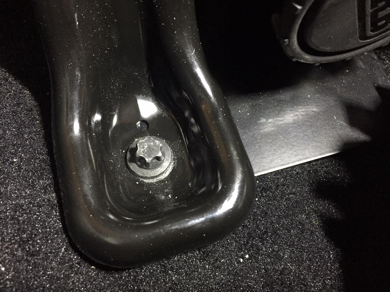

It's not difficult to take apart. The seats are 4 hets nuts and the center console is 4 10mm. 12 bolts and the whole thing is open.
If you meant "hex" nuts, mine are neither hex nor nuts. Mine are bastard male torx head bolts that require a torx socket that no Lowes or Home Depot in my city carries. I had to order the right socket on Amazon and fortunately got it the next day.
That’s messed up. I have assume they do that for the people that park with their doors off? Why else would they make it so hard? But then why use standard torx to take off the top?
Mine have those too. I let Armorlite know that my bolts were different than their install directions. They called up Jeep and I guess the machine that has torx female screws kept breaking bits. You will even see some Jeeps with different male and female on the same truck.
I had all like you did, the torx driver worked well. So did a socket but torx is ideal to not round off.
I discovered this when I went to install my Innovative/ARB under-seat compressor. Hoping to get the install done that day and I couldn't even get past STEP 1, removing the seats. Arrrrggggg.
Their instructions, geared for a Wrangler, called out a regular T50 torx so I contacted them to ask what size socket was needed for the Gladiator. They had a customer's Gladiator in their shop for an install and that one had fasteners that matched the Wranglers they were used to. I don't think they believed me until I sent a photo like I posted here.
Edit: I just looked at their website and now they do call out either the T50 or E12 socket.
Oh I agree once I got the E-Torx sockets, which are not easy to find, it was easy...but what a hassle in a brand new vehicle!

For those looking for a Star Socket Set, Female Torx Socket Set, this set is very decent quality and priced right. Case they come in is decent too..
When working on newer vehicles (especially, Euro's) a set like this is a must.
MAXPOWER 1/4-Inch Drive Star Socket Set, Female Torx Socket Set, 7 Pieces, Cr-V, E4-E11 https://www.amazon.com/dp/B07GFD2YD...abc_VW6790YV1SM2DFRDHGR4?_encoding=UTF8&psc=1
But you need an E12 to remove the seats! This set only goes up to E11. And 1/4 inch drive is a bit whimpy. To get the back seat out I needed the long handle of my 1/2 inch drive (w/ a 3/8 adapter) to loosen some of those bolts.
I opted for a full set of male and female torx:
https://www.amazon.com/gp/product/B082WMZH9L/ref=ppx_yo_dt_b_asin_title_o00_s00?ie=UTF8&psc=1
