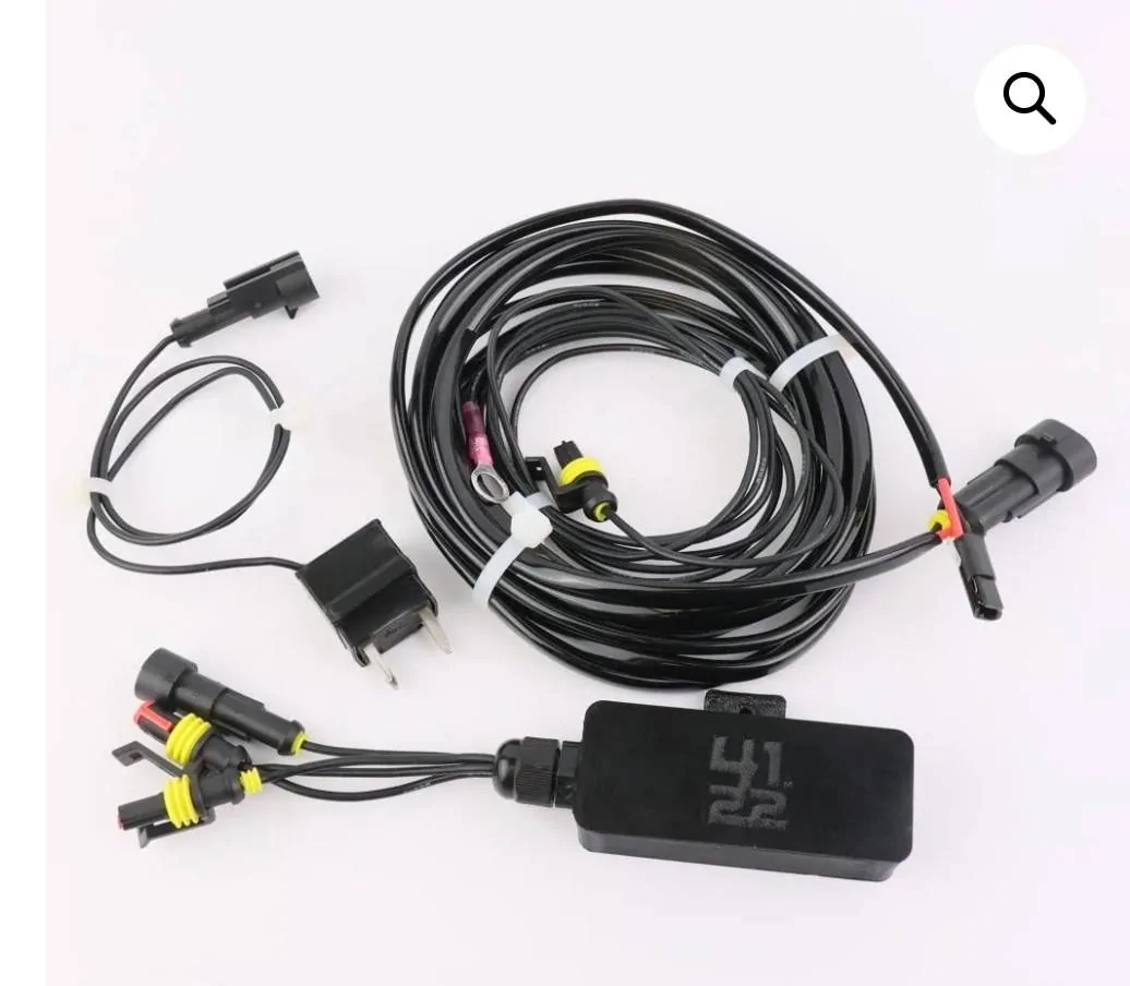

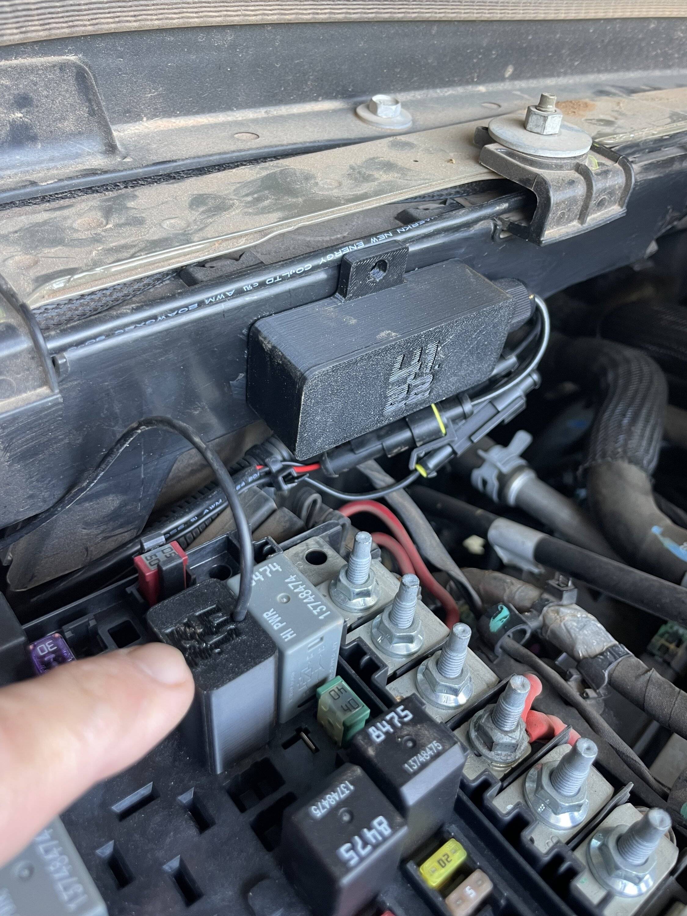

After reading many threads of folks here having their rigs stolen, it’s pretty appalling how easy it is to steal a Jeep. Found a reply that recommended the 41.22 kill switch and recently received mine.
Some folks on that thread asked I post my experience
Finally got it installed today - super simple and took about 45 minutes to make it tidy. Run a wire through the hole in the firewall, hook up a ground wire to the body, mount the control box and replace the relay. Adding a picture below so you can see a few of the details.
switch works as advertised.
Yes, I know this too can be defeated by a pro, but I’ll wager most doing this are not pros and anything that makes it harder is a good thing.
check it out at https://41twentytwo.com/product/vehicle-kill-switch/
Your pic shows the relay and a Control Junction Box.
But when looking at the website, it looks like there are more wires involved. So there seems to be a little more to it than running a wire into the cab ?
Could you possibly give a little more detail or is it just that simple ?
Thanks for the write up. It's a hot topic. I'm looking at the 41.22, but I'm not sure I want to loose remote start.
It really is that simple. There is one ground wire - the red connector - connect that to the body. There is the relay, plug it in. There is one wire that runs to wherever you mount the kill switch (in the cab for my case). You connect the kill switch to the wire with included connectors. Done. Super simple.
