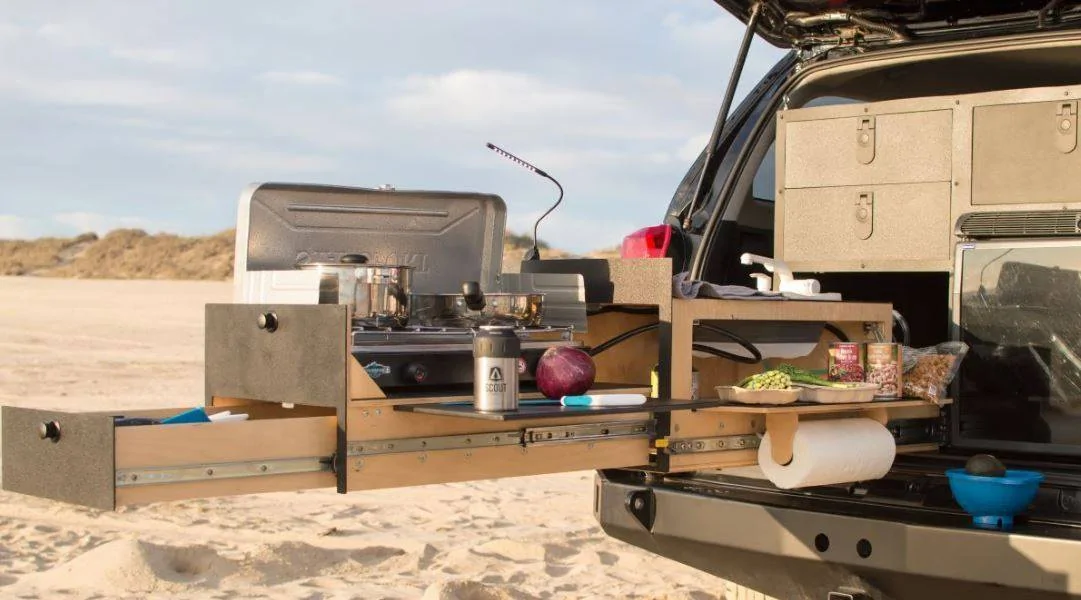

Ressurecting this thread again as I am going through my build thought process. I think I have narrowed it down to one of the following.
PullKitchen
Overland Kitchen EXL Truck & Van Kitchen System — Overland Kitchen - The Adventurous Kitchen

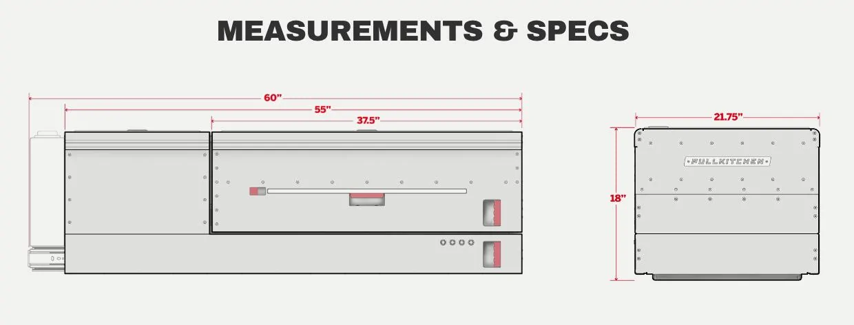

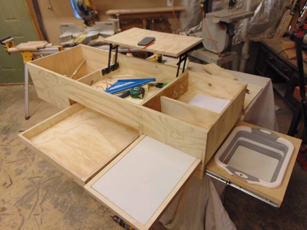

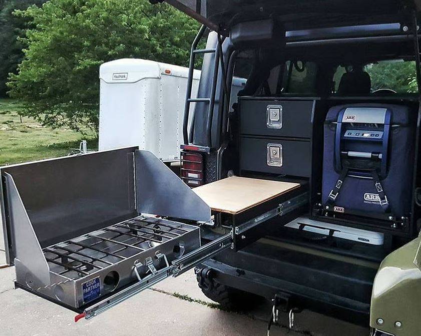

I bet you I have drawn up 20 different designs for a slide out kitchen and I still haven't been able to settle on anything.
I really only have four requirements;
- I want the stove to be mounted
- I want all kitchen related items to be stored in the slide out
- Maximize flat space
- Everything needs to stay low enough that the Mrs can reach it without needing a step stool.
My biggest hurdles are stove length and height. Our stove needs at least 35" of room when hooked up to a tank, which really cuts into storage space for everything else when you only have realistically 56" of overall length, so I think I'll need to look at a different stove thats not so long.

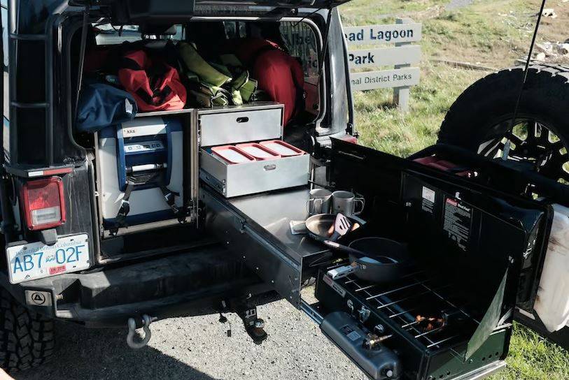

Yeah that stove is really putting the limits on your options. Take a look at Cook Partner stoves. All aluminum and excellent quality.

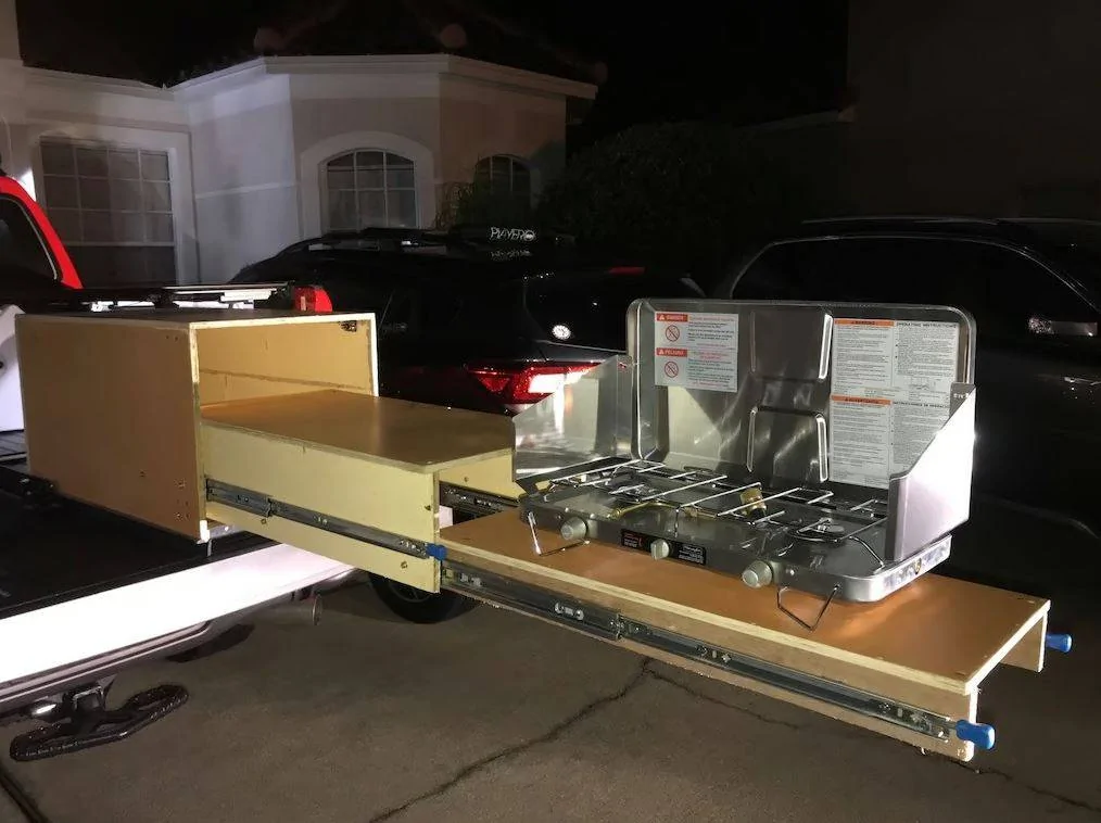

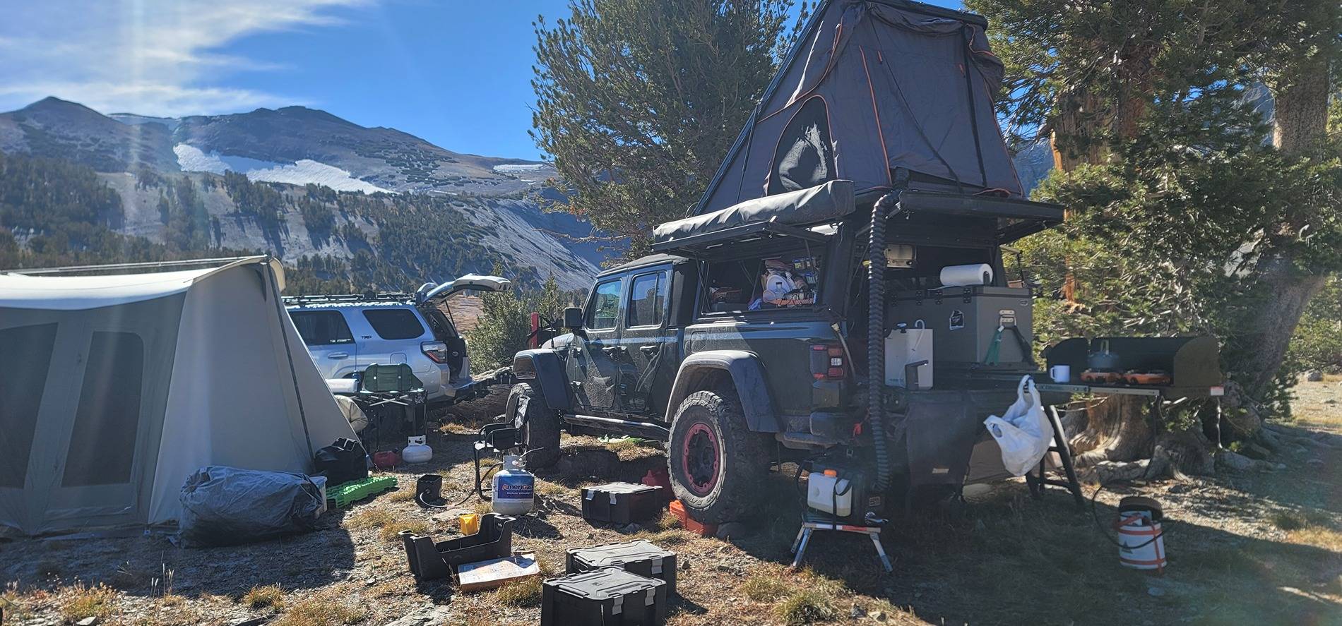

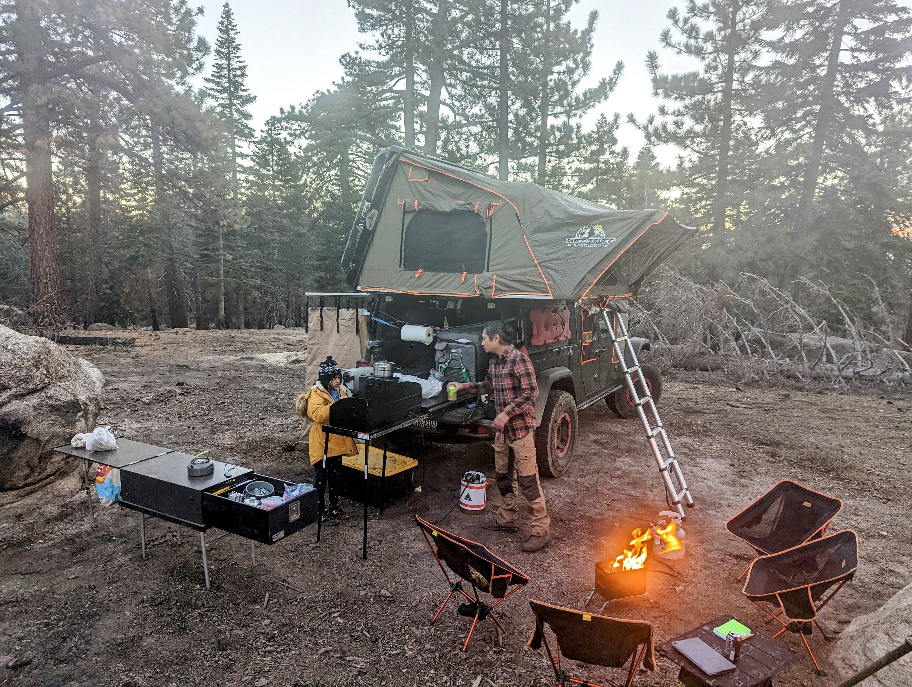

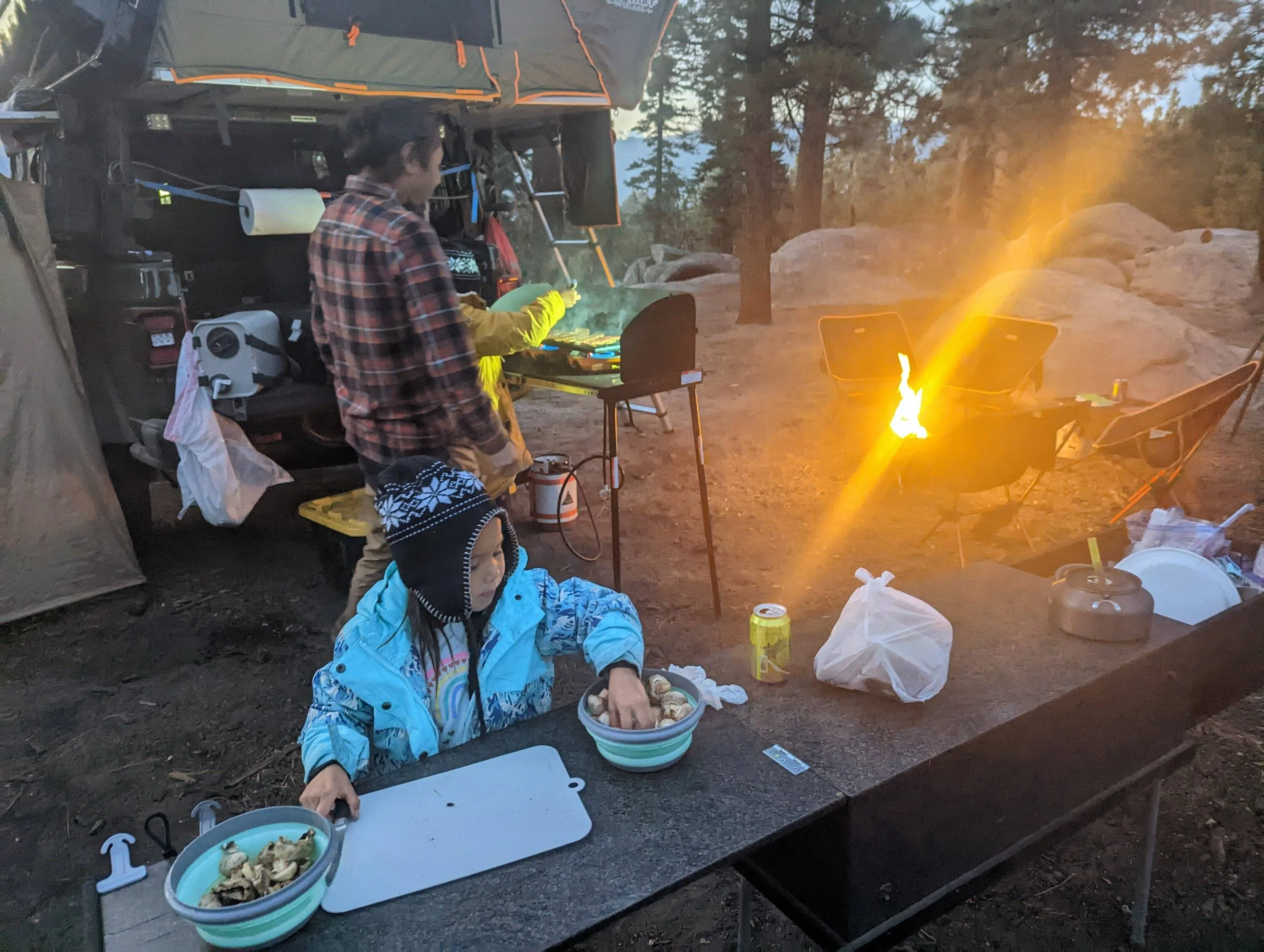

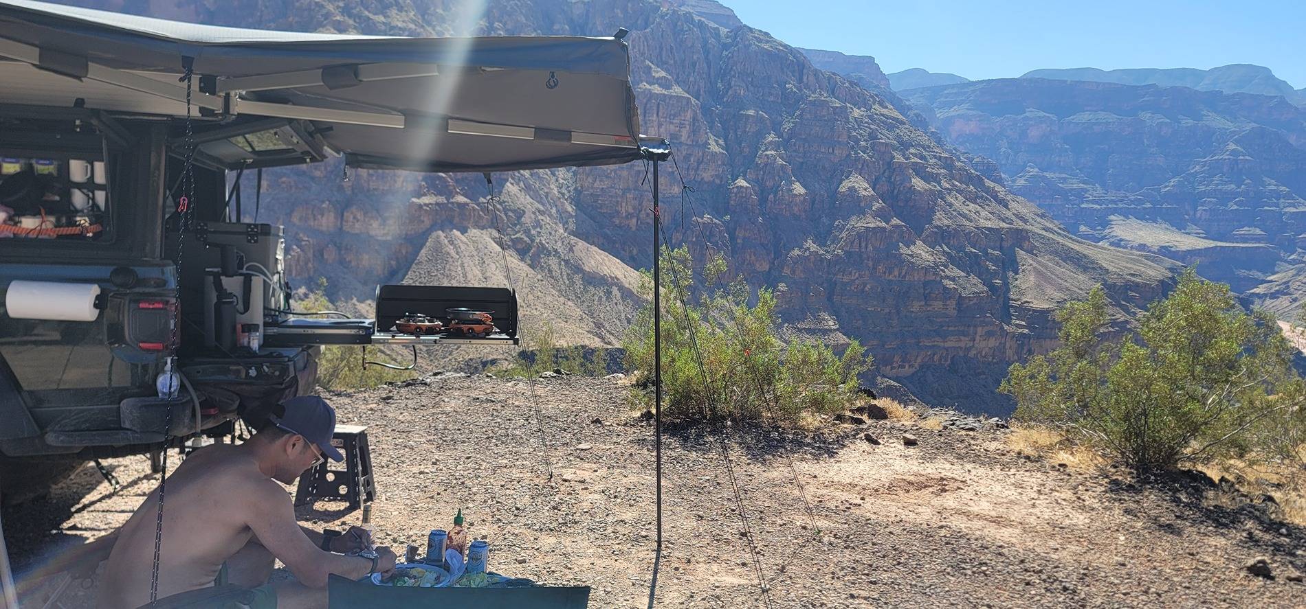

I've been running the pull out kitchen and awning for a couple of years now. It works pretty well for the most part. The awning wall is not quick to put up. I don't actually use it much. It's not good for very windy condition. I've had the awning out in 15+ mph wind, legs out and tied down. Would still prefer to be inside. I wouldn't want to cook in the camper all the time. Just when conditions are poor.
Jeep Gladiator Kitchen slideout in bed 20231012_102601
Jeep Gladiator Kitchen slideout in bed 20230929_115256
