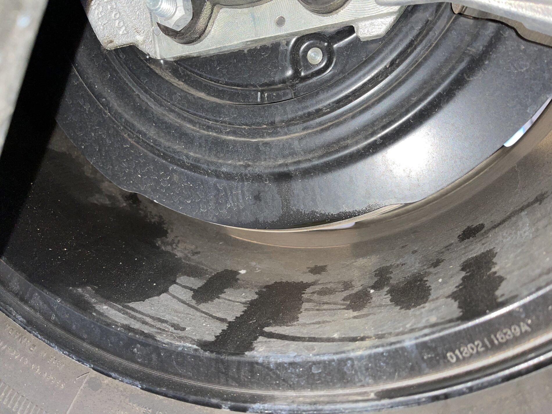

Leaking axle seal?

Same issue here. Bought last month, noticed right away. It's been to the dealership 4 times. 1. To diagnose, 2. To replace drive shaft and break pads, 3. To be rediagnosed because it's leaking again (told it was a blocked vent pipe and fixed) and going again today to be rediagnosed for the 3rd time since it's still leaking. We live 45 minutes from the dealer, they have no loaner vehicles and their shuttle doesn't go as far as I live. Starting to feel extremely frustrated!
Are there any parts required to fit the blocked vent pipe - or is that just a repair? Just want to ensure I get those parts ordered, if need be.
Might want to push the issue as far as a loaner or rental car. My dealer didn't have loaners available but they did set me up with a rental while they were working on my rig. Both times, first for the "diagnosis" and for the second time when I took it back to be fixed.
Read my post earlier in this thread. I removed the restrictive vent from the end of the hose and replaced it with a universal fuel filter to keep out dust, bugs, etc. Worked great.

Just checked my RR on my 2021 Sport S (Not max tow) and found that I am having this issue as well. Guess I'll be calling the dealership.
MDH: 042314
Update: Dropped off the Jeep at my local dealership and just got a call letting me know that the axle assembly part is on back order until December...

Why not print several of these posts or even the thread and hand it to the dealer and say "see, there IS a problem - fix it".
Vent is a cop-out. Maybe one person may have a plugged vent but a restrictive vent? These don't generate pressure on a scale so large as to need a HUGE vent. Anything that allows it to breath will work. Doesn't have to be a 3/8" hole.
Agree. The pressure rise and fall is gradual (in normal driving). The GoreTex membrane on the vent should allow for that.

Funny thing about differential leaks - I've seen ones that have been leaking for months, that weren't down on fluid. If it requires "topping off" even once a month, it's got to be one hell of a leak. A drop of lube goes a very long ways. 2 ounces would cover your wheel and make quite a large spot in the garage, but you'd likely not notice it being low in the differential.

It’s pretty easy to check the level and clean the rim to keep it from building up. Sure a new vehicle shouldn’t do this but it will get fixed at some point. Not convinced the new axle is the fix but we will see. I was the first at my dealer with this but I know others have it but haven’t looked to find it. I think it is more widespread. I won’t let it ruin my love of this truck. I reached out to my dealer this morning for an ETA on the axle. Waiting to hear.

I think I saw in this thread, but want to clarify - the person who is/was tracking - this is a 2021 model year only, correct? And wasn't it determined to be only the max tow and Rubicon axles? Or did I see that wrong?

I've got a '21 Overland, and it leaks, pending a replacement part delivery on 8/6.
