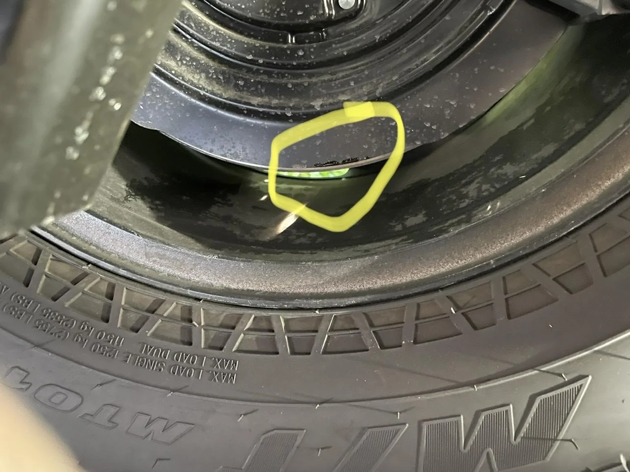

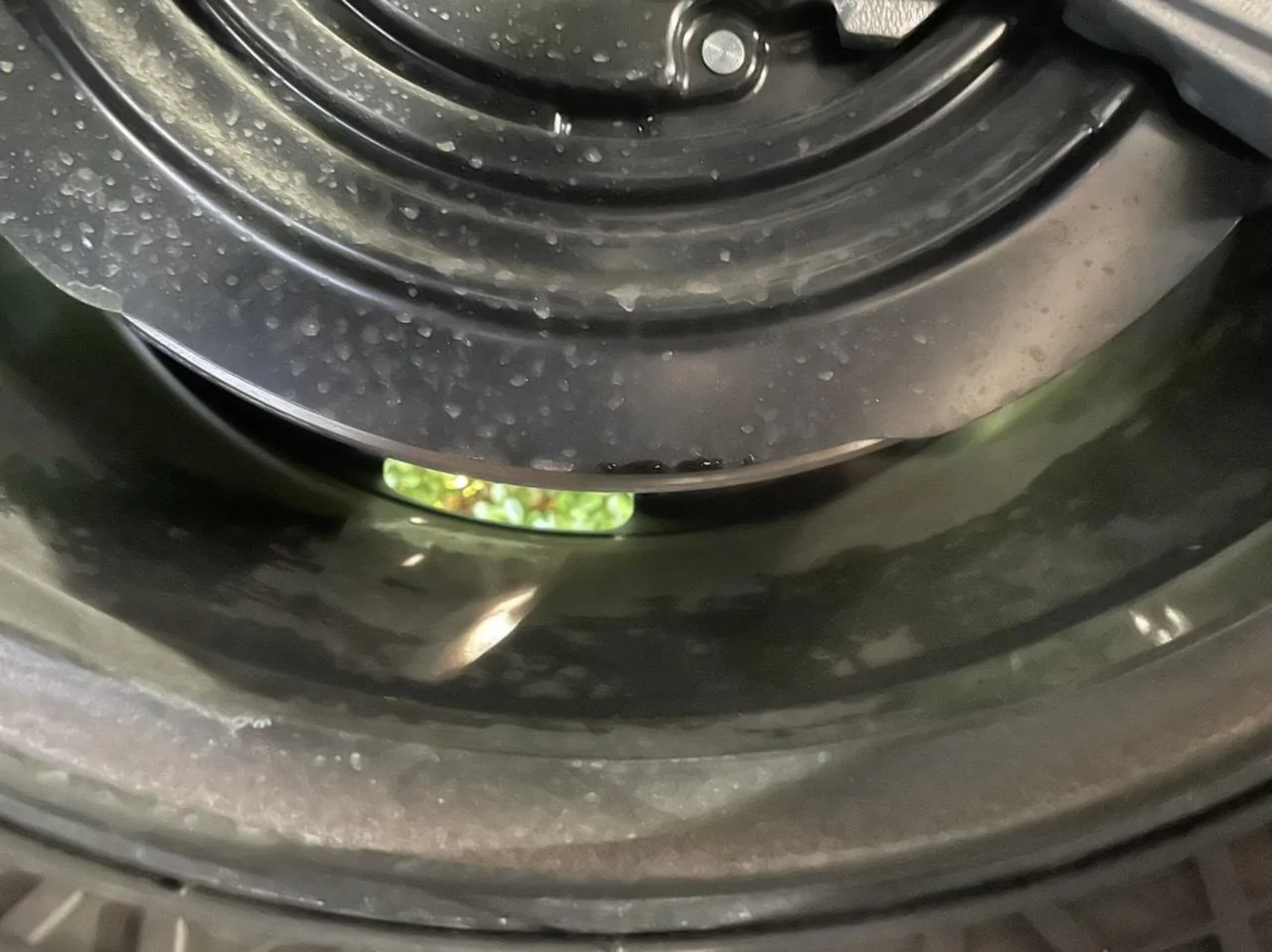

Looks like after a whopping 300 miles I’ve got this issue on the right passenger side - circled the wet fluid but the inner wheel looks badly stained as well. At least I think that’s oil stain but feel free to correct me if I’m wrong. This is a Mojave build 12-2020 with MDH 122115
That is it and looks just like mine. About the same miles on my 21 Mojave too. Dealer ordered new axle shaft but they are on back order.

Got it checked out today. Referred the dealer to this thread. They had it diagnosed in about 2 minutes and (back)ordered the axle shaft assembly 68474264-AA.
They topped off the fluid and I have the truck back but hope they get these axles in soon. Sounds like they’ve got a lot of Gladiators to address.
