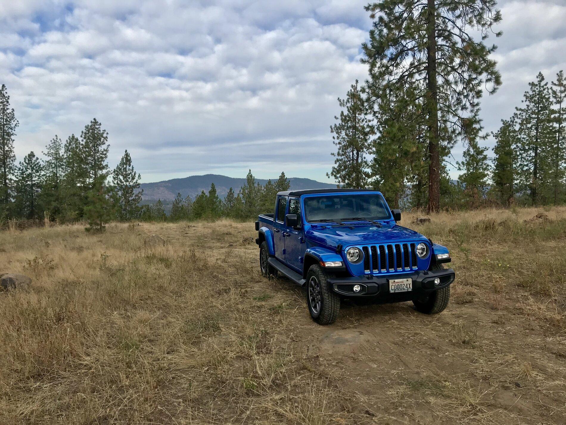

New Update: The shop called to tell me my truck was fixed. Great! After 6 weeks of driving a rental with a roof I can finally get my ride back and feel the wind in my hair. Before turning in the rental I found my Gladiator out in the lot and crawled underneath because it’s impossible to trust anyone these days. The axle leak appeared to be fixed and cleaned up. But wait, what is that other mysterious fluid pooled up by the rear passenger tire? I touched it with my finger and it was oily and yellow-green. When I looked up I saw it leaking from the shock. I went in and they said my truck was fixed and ready to go. I said probably not, grab a mechanic. They determined that my shock was blown, somehow after sitting there for 6 weeks waiting for the axle seal to be fixed, and that they would need to replace both rear shocks. They initially told me that I could drive it and they would call me when the back ordered (of course!!!) shocks came in. As I was getting in my truck and handing over the rental keys the guy said he had some bad news. They needed to keep my truck there until it was fixed because the leaking shock fluid might get on the brand new axle seal and deteriorate that and then that would need fixed again. So I have owned my truck for 3 1/2 months, driven it for 2 months, and it’s been in the repair shop the rest of the time. No ETA on shocks. I’m considering rescuing the hostage that is my own truck and buying respectable parts, like Bilstein.
Newer update: I’m back on the road! It was about 6 weeks for the seal repair and several days for the shock fix. So far everything is good but I am definitely keeping a watchful eye on it. The length of time for the repair seems in line with most in this thread. My big complaint with this whole situation is that the vehicle is new with only a few thousand miles on it. I really hope Jeep/Dana get this figured out because I rely on my truck as a daily driver. The rental Ram had cooled seats and the HEMI, which was fantastic, but there’s just something special about the Gladiator.
