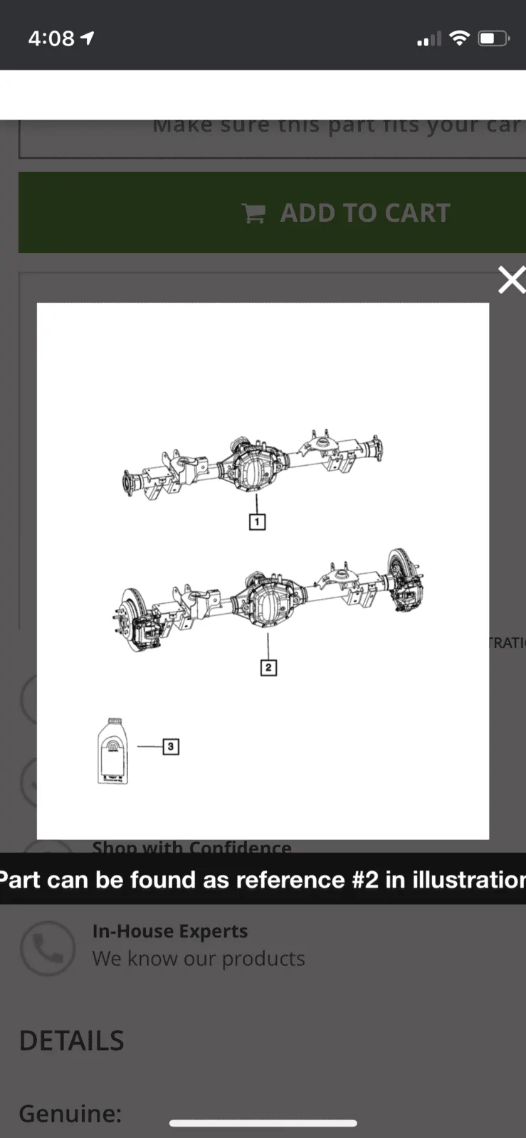

Update after returning from the dealer after 1 right rear axle assembly replacement, subsequent rear brake show replacement and reoccurrence of the leak.
Dealer confirmed the leak and after talking to Jeep corporate decided to order the rear complete axle assembly. Part number is 68422837-AF for my Mojave. And as always, on backorder. They hope to have an ETA next week.

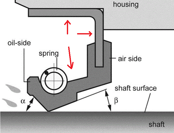

Here’s a shot in the dark… I think it’s the oil. There may be additive/chemicals missing in Mopar’s gear oil that addresses keeping seals conditioned and tight; keeps them from shrinking from heat. When you look at other oils, in this case AMSOIL (I use it but not selling it or even promoting it) I recall having this discussion in length with the rep. I just went out to the garage and read the back of the 75/90 Sever Gear oil and there’s nothing specifically stated there about seal conditioning but I’ve seen it in other write ups or material about it.
Then again - why only right? So far not a left seal has leaked.
You don't need seal conditioning - that's marketing for one thing, otherwise aimed at older vehicles. New seals are supple. Seals SWELL, not shrink in heat.
I do not like anything that adds chemicals that supposedly "treat seals" as they are almost always solvents & solvents + rubber = bad, IMO. I've seen mushy seals or seals that were "tightened" by additives and caused to split.
Axle seals are already an interference fit over the shaft. And pressure from the inside presses them even tighter. These may also have a preload spring, forcing the seal against the shaft.
I would never use a fluid that "conditioned" seals in a new vehicle. That's for old vehicles with worn or hard seals and the owner is trying to get by a few more miles before the inevitable.
