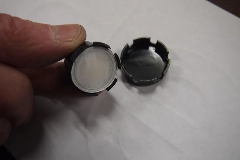

Afraid my Mojave is starting to show signs of this same leakage on the passenger side rear axle. So far just seepage & not dripping yet. Build date was 2/21/21.
Just out of curiosity, I disconnected the vent hose at the axle fitting. Like you I discovered there is excessive resistance to both blowing & drawing air through the hose, though it can be done. Just way, way more effort than you would expect for a case vent of this type on an axle or transmission.
Next removed the plastic vent cap assembly (pictured below) at the top end of the hose attached to the truck bed framing, and it is the source of the restriction.
Popped the cover off of the end of it, and found that there is some sort of paper type membrane completely covering the end of the vent housing. This doesn't seem right to me at all.
Are there any Chrysler/Jeep techs on this forum that would know if this is normally the way these are constructed & if so why?
It seems that this could cause excessive pressure buildup in the axle housing as the gear oil warms up, and very possibly be a contributing factor to this rash of axle seals leaking.

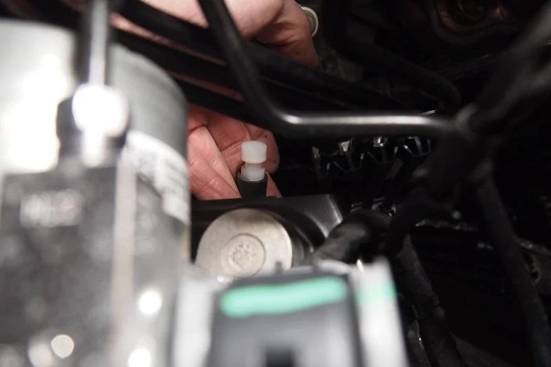

Just for comparison, I looked at the vent hose & cap for the front axle on the driver side spring tower (shown below). This one is the style that I am familiar with seeing used on vehicles, being just a plastic fitting with a loose fitting cap that allows unrestricted air flow.
I again removed the hose at the front axle fitting to test this one, and it has no resistance at all to both blowing or drawing air through the hose & vent cap.

Nice to know the front axle does not have the vent restriction. I found those vents on line and will probably get one for the rear axle. For now I stuck one of these fuel filters on the end of the rear axle vent hose. It was a decent friction fit in the hose and should not go anywhere and keep the goobers out.

That sure is weird...and it sounds like it is not some sort of breathable filter fabric material just to prevent a splash and/or dirt and debris from going back down the tube. I never traced the vent tube to the end on a newer vehicle but on all of the older jeeps and vehicles when I was growing up we would just route them up high as possible and stick a cheap fuel filter or similar filter on the end. My only other thought is that perhaps that little plug was outsourced to the lowest bidder and they used the wrong material for that white membrane.
With Jeep's obsession with the whole water fording thing, I also thought it might have been intended to be some sort of filter material to keep water out. But it also doesn't allow any air to pass through or vent, so find that idea very hard to believe.

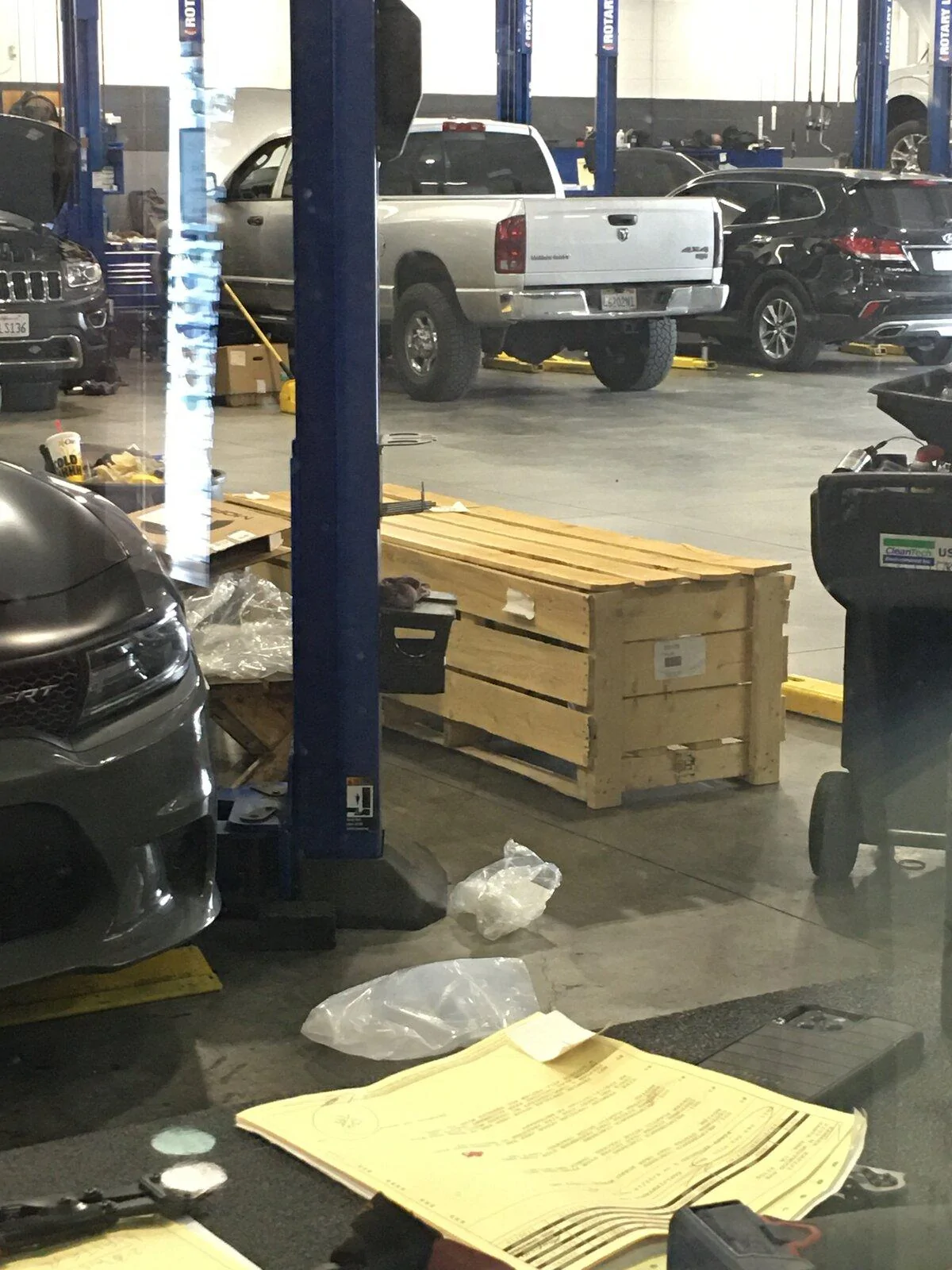

Update...
Dropped by dealership this morning to check on progress. They just rolled out the crate. The crate with my new axle. I thought it would be a new assembly but it was the whole new rear axle!! Jeep doesnā€™t want it taken apart and instead wants to research and study the issue. New rear axle should be done by Tuesday or so...

Update...

I'll be damned! I am truly surprised they are changing the whole thing. Interesting.

Yep. I was shocked too! Once I get it installed, Iā€™ll be carefully monitoring the issue. Praying it never leaks again.
