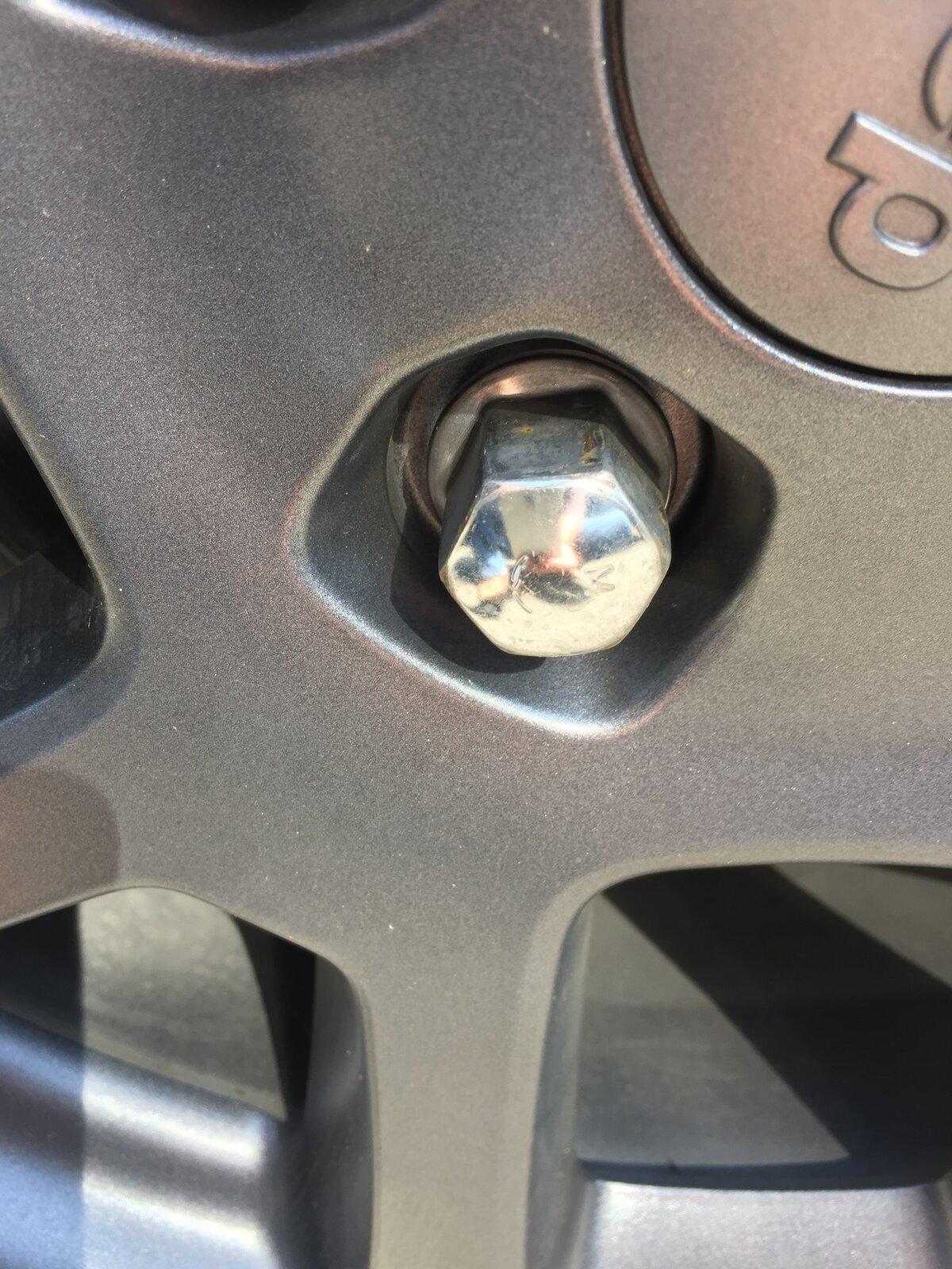

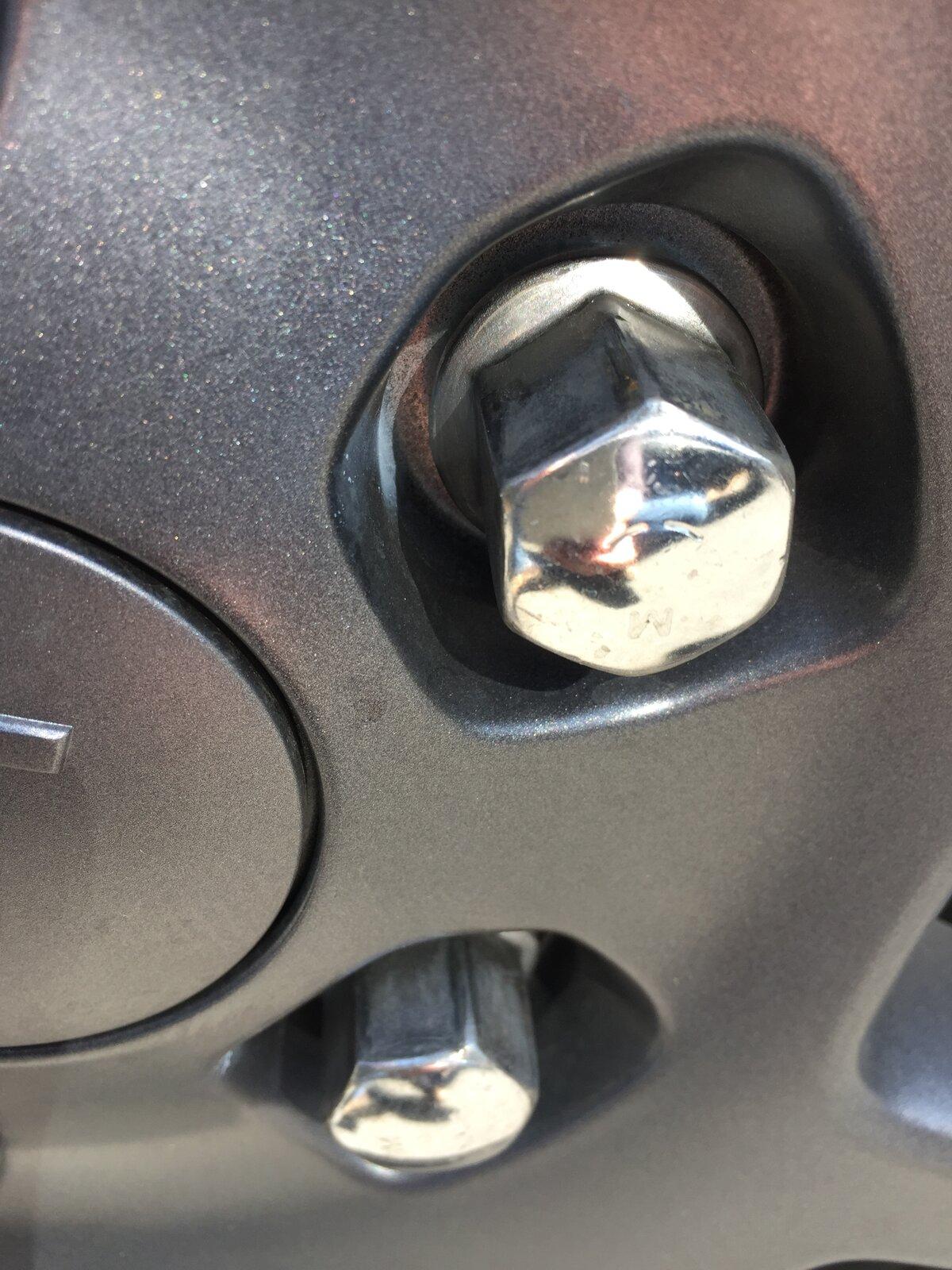

Took the gladiator to the dealer yesterday for the leak and to complain about the damaged/abused lug nuts. They spent an hour looking at it.
1 - They said the factory overfilled the rear end and that caused the leak. Directions to take it home and check for leaks and bring it back within 500 miles.
2 - The lugs are not "damaged". SO I don't know if this is normal (The tires have been rotated one time and only by this dealer) or am I just being a prima donna. I attached pictures for any opinion.
1 - Found a puddle on the rim today :-(
Called the store manager and voiced my concerns about wasting my time and about not being happy with the lugs. He said they would take care of me...
I'll keep you posted.
Ugghh on them saying it was not a leak....then finding a fresh new pusddle.
On the lugs....I mean maybe I don't see it because of glare or whatever.....but those lugs look fine to me. I see a few tiny marks but I have similar small marks after changing out my wheels and removing my own lugs. Looks like normal tool marks to me.

There's nothing wrong with the lugs, I wouldn't pursue that any further because you're going to end up getting labeled as a difficult customer.
The factory lug nuts have a thin metal chrome cover formed over the actual nut. They will get dinged up with normal use and is normal. Yours look fine to me.
As far as the leak keep after them.
Ok - I hear that.
Its not great that after one time I have a lug that is starting to rust.
Does anyone know if I can purchase better lug nuts.
Something that does not have a thin chrome cover?
