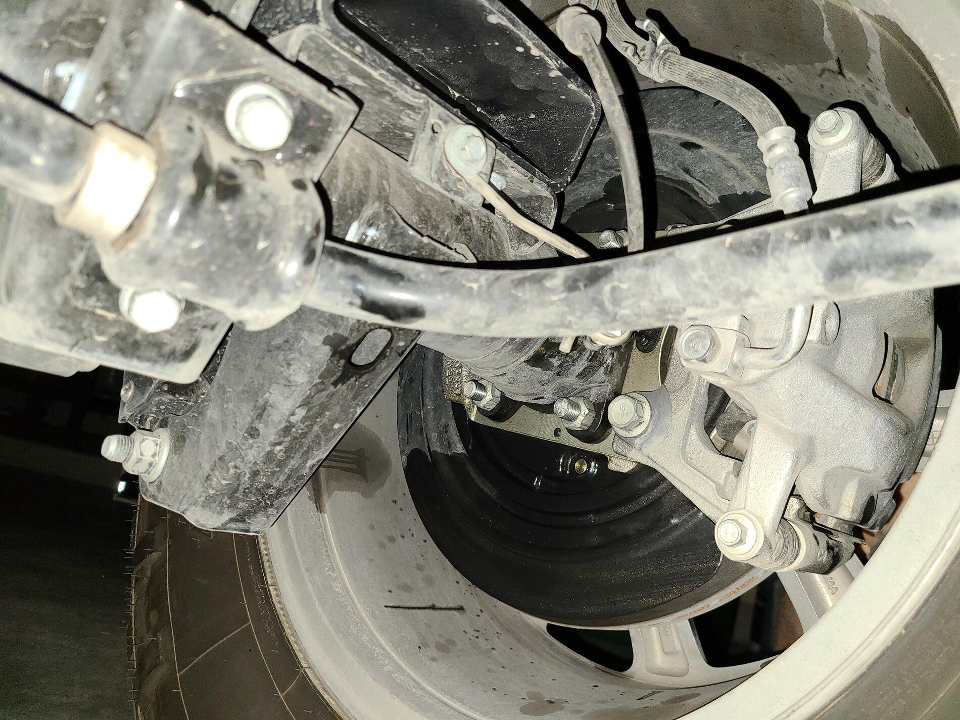

Well, crawled under my JT a while ago to look at spring part numbers and discovered my right rear axle seal is leaking. Less than 1K miles on the truck. Guess I'll be calling the dealer tomorrow.
We noticed the same leak today, passenger rear axle. Just 1250 miles on my 21 80th Anniversary model. Suggestions?
Jeep Gladiator Leaking axle seal? 20210410_194906
Schedule the warranty repair....but driving like this for a little while won't harm anything as long as the leak does not get significantly larger.

Contact your dealer service department for warranty repair. They will likely end up replacing the whole axle shaft assembly.
Something I did was remove the valve on the end of the vent hose and temporarily replace it with a 5/16 disposable fuel filter until I get another vent cap.
I found the vent valve is very restrictive and I suspect the axle may be building pressure causing the seals to leak.

Welp initial appointment made for tomorrow....I tried to talk them into just ordering the axle shaft assembly and being ready to do the swap (based on a pic I was ready to send them) but they still did the "we need to take a look at it".....so I'll just have to play the game and end up with two visits. Hopefully they won't offer any resistance on doing the repair.

Yep, My dealer kept my Gladiator a whole day to "diagnose" what was obvious with a quick glance.
They set me up with a rental car so not going to complain too much.
If I read the paperwork right it took the mechanic less than an hour to change the axle shaft. They kept it most of a day for that too.
