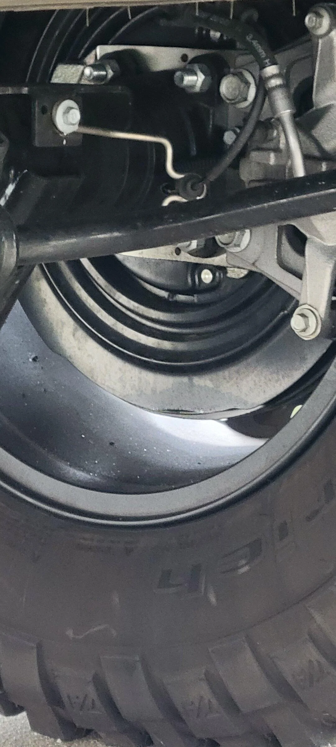

Well, crawled under my JT a while ago to look at spring part numbers and discovered my right rear axle seal is leaking. Less than 1K miles on the truck. Guess I'll be calling the dealer tomorrow.
Have had same issue, right rear axle seal. Jeep build date 9-20. Purchased 2-21. First noticed leak mid May 5-21 at about 3k miles. Took the Jeep in for first service 11-21 at 8k miles and reported axle seal leak. Parts were ordered with repair completed 12-21.
I monitored the differential fluid level throughout and it was never low. I would imagine the axle lost 2-3 onces from the time I noticed the leak until the time it was repaired.
