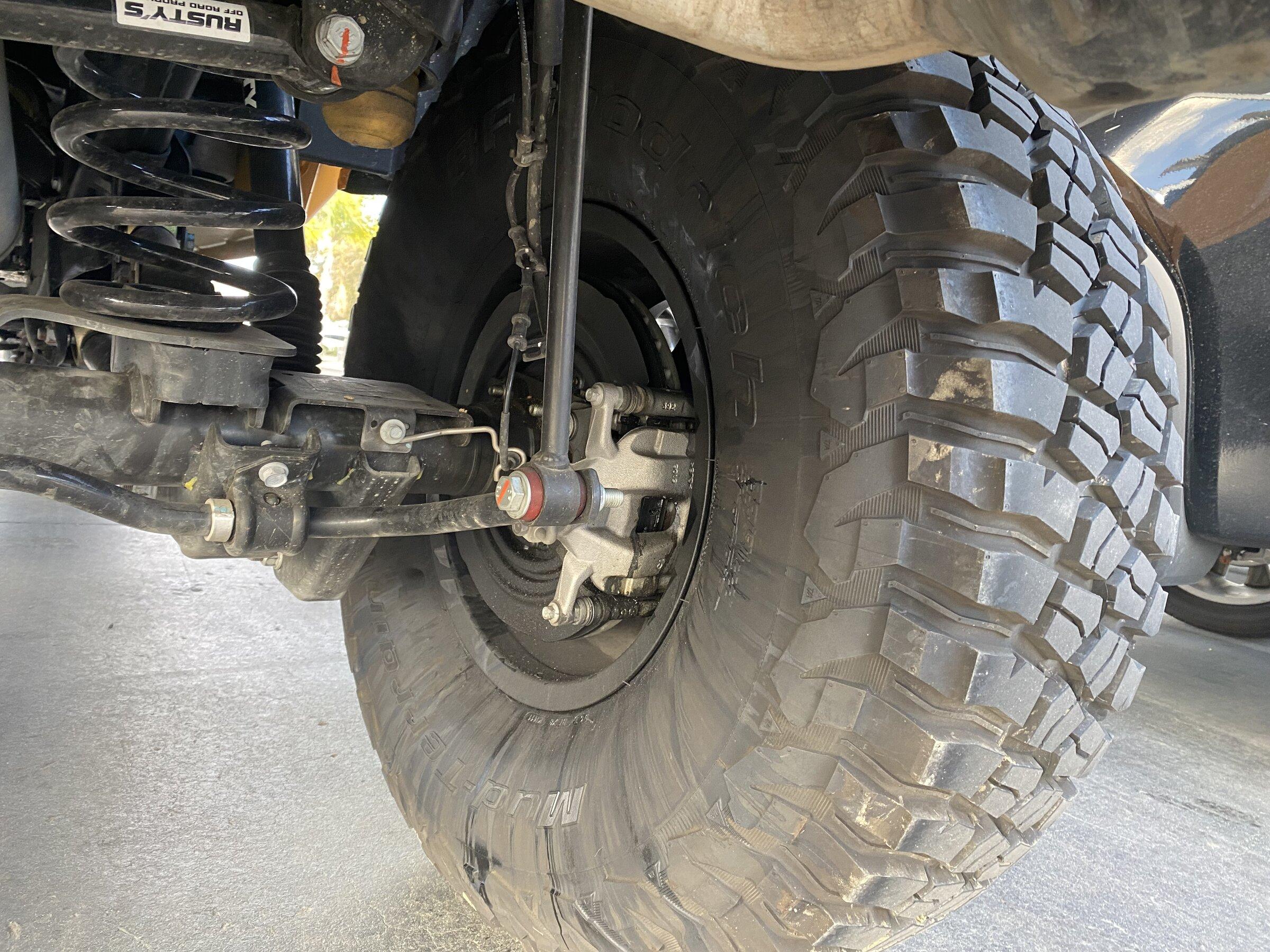

I got my 21 Mojave with 6747 miles serviced last week and noticed a weird sound like a bad belt in a tire and pulling to the right afterwards. I got underneath it today and found the RR axle seal leaking. I don’t think the leaking seal has anything to do with the pull to the right now, but I’m wondering whether the noise is the axle shaft. My MDH is 121307.
I spoke to the service manager because I was not happy that the tech just rotated the greasy wheel from the back and never said anything about the leak. He had me bring it right over and they immediately ordered a new RR axle shaft. It’s supposed to be here tomorrow and install on Wednesday.

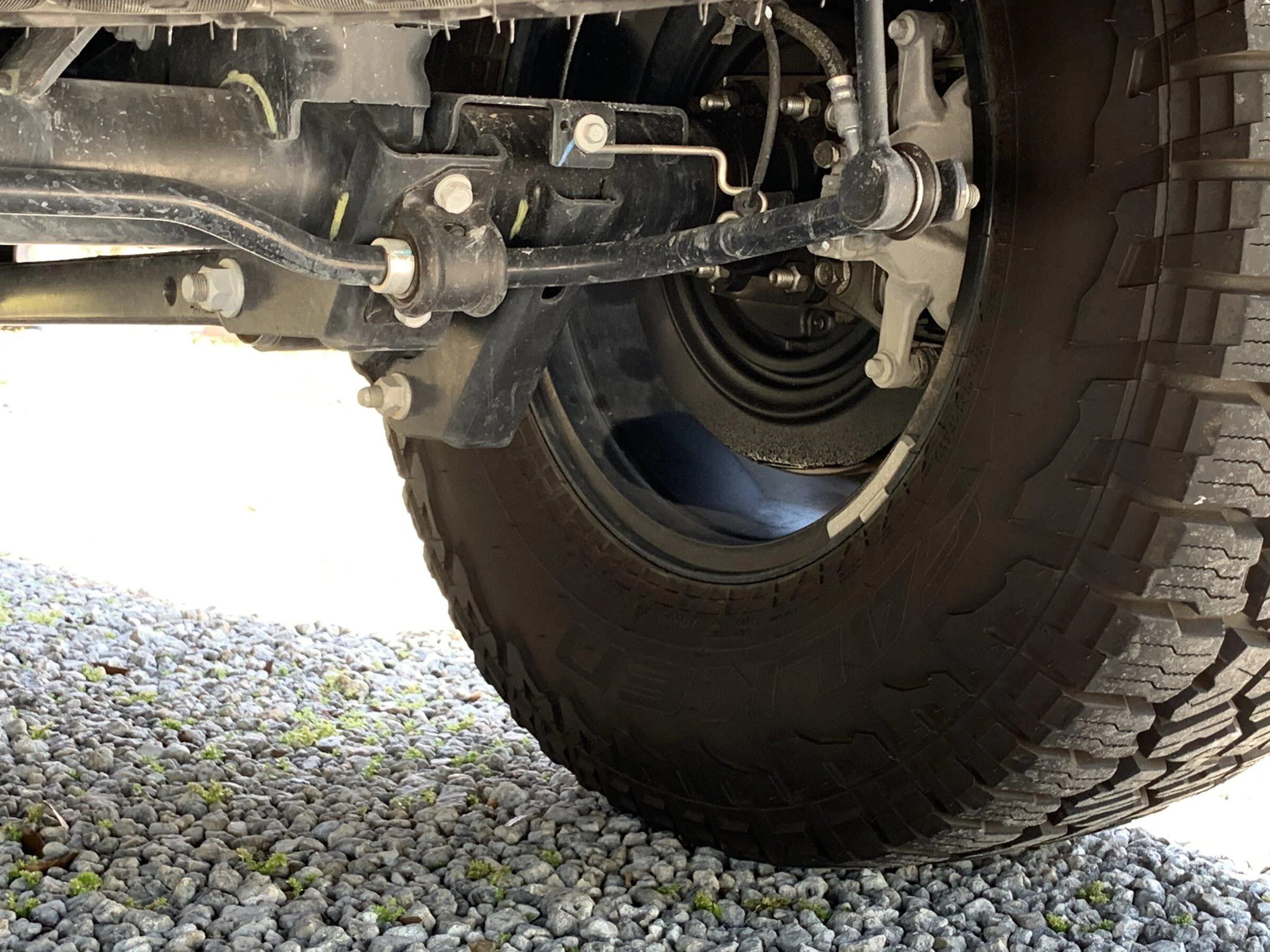

Turck gets dropped off today to get the second leak fixed. Thery are going to check it over well to see if it was a tech error or somthing with the housing that caused the second leak.

Less than 2k mikes. the first one was at 10,200ish and the next one was at 11,900ish. the first one started a lot sooner than 10k, i just didnt notice it until then.
also the first one was finished at the end of october, took 4 weeks to get parts. this one i found on dec 1st, got parts in last week. dropped off today

I took mine to the carwash and used the high pressure soap a rinse and cleaned the backing plate and housing off, after doing that it looked like brand new with no fluid on it at all, then kept an eye on it for a couple days, then i saw the drip on the bottom of the backing plate
