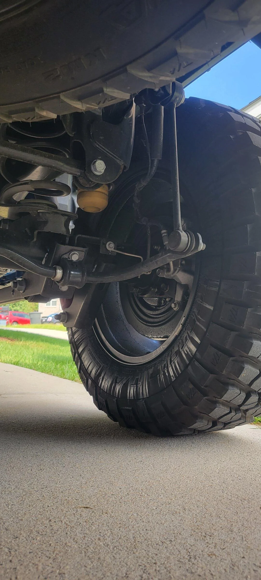

Yeah it gets worse over time, My first one got so bad it Coated the inside of the tire.
40,440
53,854
2 or 3 ounces combined with road dust would completely mess up a rim and the back side of a tire. It seems like a lot, but...........
And IMO, the dealership should not only fix the leak but wash the wheel, tire, and other parts that get coated with crud due to the leak. When I was doing that sort of work the goal was to not only fix the leak but give the vehicle back in such a condition that there were no signs it had ever had a leak.
I agree, I just assumed the dealership would clean the oil and dirt off the inside of the wheel when they repaired it. But they did not… I told the service writer that it was BS that the tech didn’t clean the oil off the rim before he put it back on the truck! I will remove the wheel this weekend and clean it myself.
Mine's coated the inside of the tire, but believe it or not, still not low. My axle just got here's so they're installing on Thurs this week. Only took like 2 weeks to come in.
Mine was really low, I didnt notice it until I saw it splattered on the shock. I was walking around it and just noticed on accident. Glad I did before the rear gears exploded
