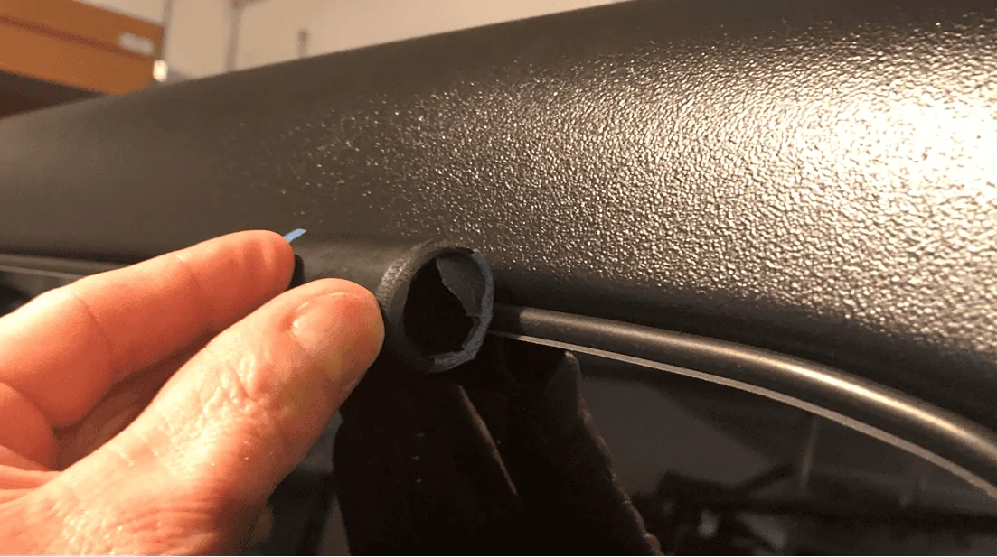

I used rubber vacuum hose as opposed to silicone. If I were to do it again, I think the silicone hose maybe be a little easier to work with.
The "trick" to a perfect installation is getting the hose installed to a consistent depth. You don't want to push the hose too far in, but you need to push it in far enough to stop the leak and have it stay in place.

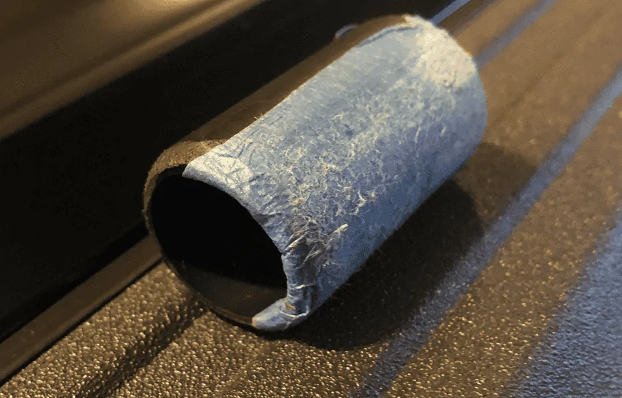

To accomplish this, I made an installation tool. The tool is a piece of 1" OD polyethylene (plastic) pipe cut to a length of about 1.75". Round & smooth the ends with a file & sandpaper. I then wrapped it with blue painter's tape to ensure it would not scratch anything. You'll likely need to replace the painter's tape a few times as it gets worn out.
Apply the alcohol lube solution and place the hose over the gap. Roll the tool over the hose while applying pressure to push the hose into the gap. I started at the top center of the window and worked my way to each side. Once you get the center started, keep applying lube and moving the tool over about 1/2" and keep working your way to the ends.
The corners are are little tricky because you can't keep the tool flat on the glass. You need to tilt the tool and use the rounded ends to insert the hose.
Tool:
Results:

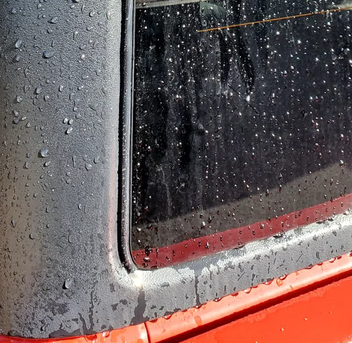

Well, I’ve got the leak. 2021 Gladiator with an Oct 2020 build date. I knew something was up when I came back to my parked truck and the front windows were fogged over. Started searching for a leak and found the back window was the culprit. Got a small container of Damp Rid and placed it behind the rear seat. Windows stopped fogging up, but of course still gotta fix the leak. Been parking inside the garage at home since I discovered the problem.
Ordered the silicone tubing from Amazon… they lost my package. lol. Ordered it again and it was delivered today. I’ll be using this method tomorrow and see how it goes. Thanks for posting.

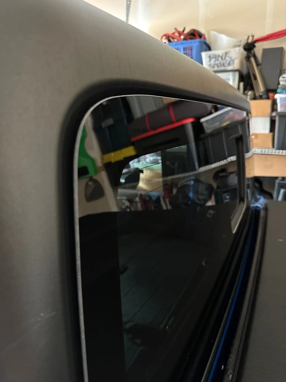

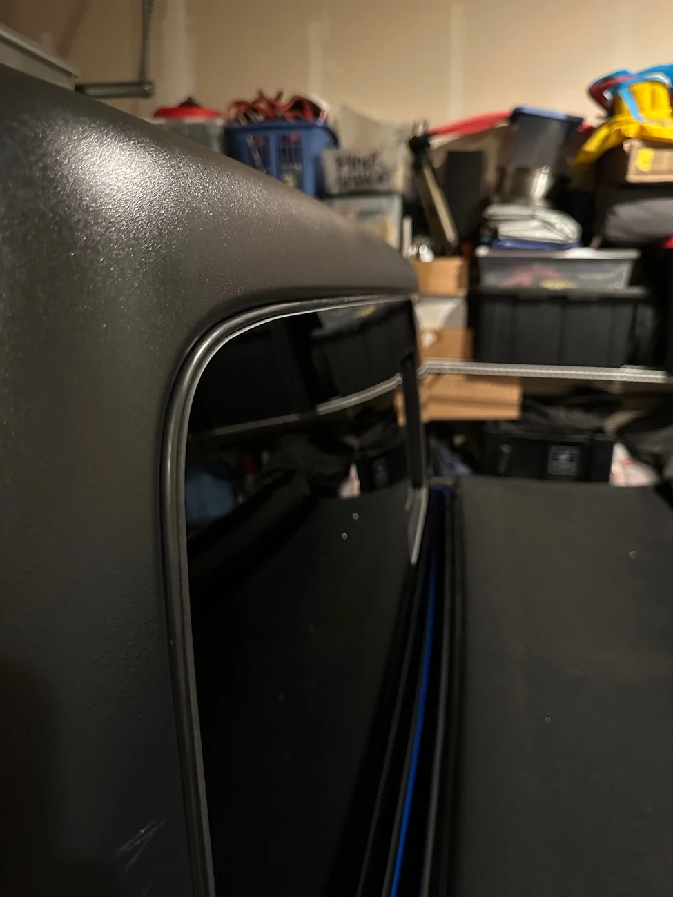

BEFORE
Jeep Gladiator Leaking rear window : fixes for those who don't want to play dealer roulette, wait 2 months, have their top scratched, seats ripped etc.... IMG_8436
Jeep Gladiator Leaking rear window : fixes for those who don't want to play dealer roulette, wait 2 months, have their top scratched, seats ripped etc.... IMG_8437

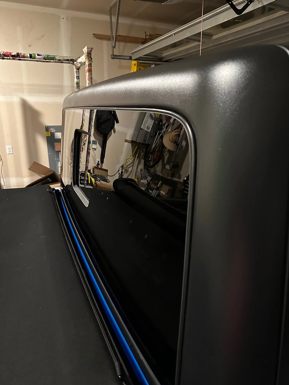

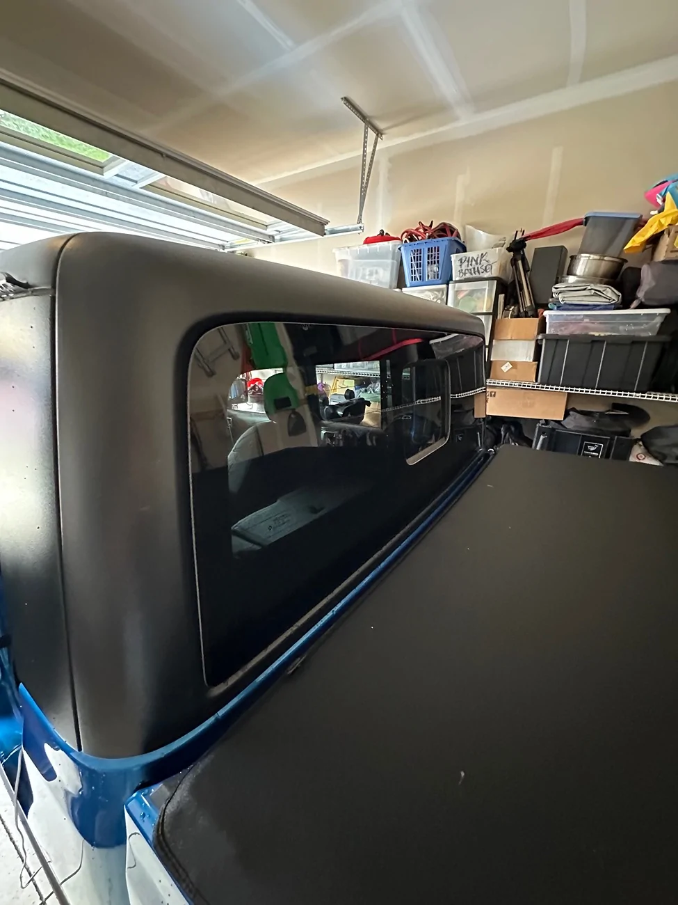

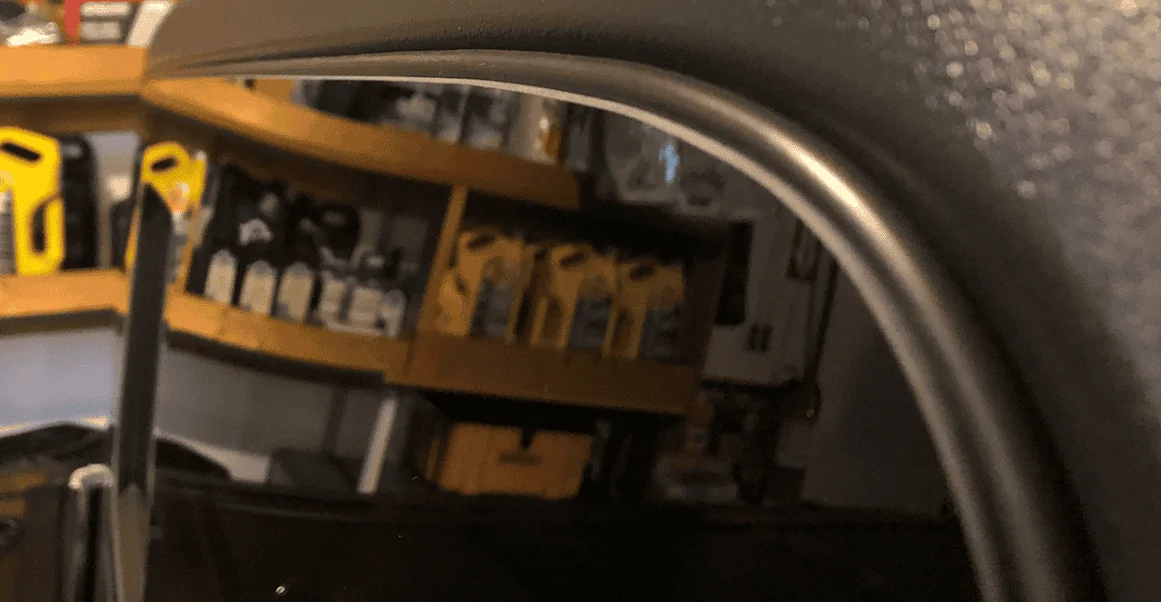

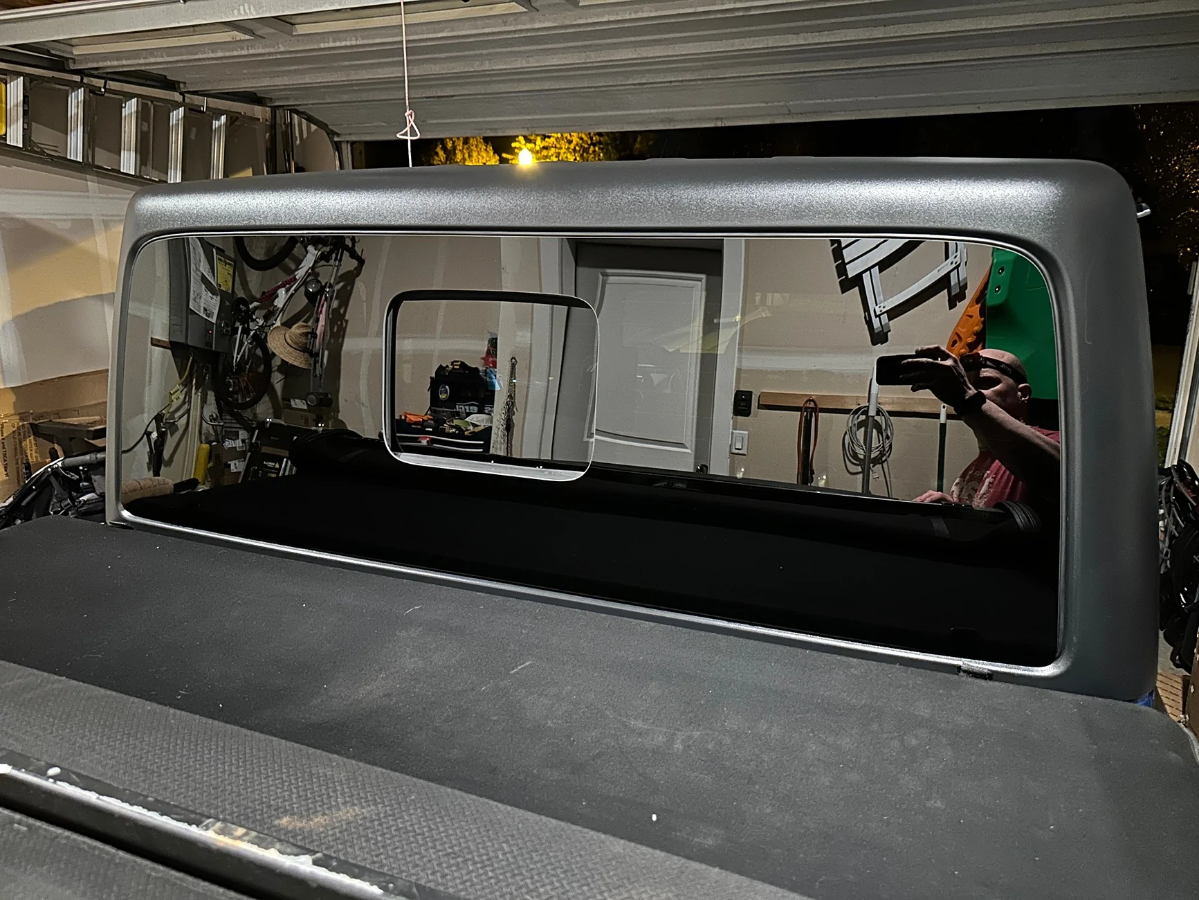

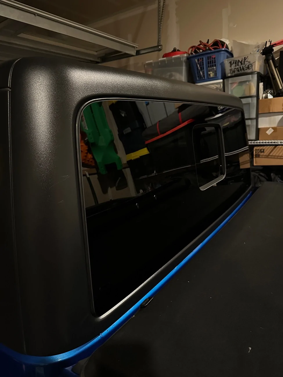

AFTER
Jeep Gladiator Leaking rear window : fixes for those who don't want to play dealer roulette, wait 2 months, have their top scratched, seats ripped etc.... IMG_8836
Jeep Gladiator Leaking rear window : fixes for those who don't want to play dealer roulette, wait 2 months, have their top scratched, seats ripped etc.... IMG_8831
Jeep Gladiator Leaking rear window : fixes for those who don't want to play dealer roulette, wait 2 months, have their top scratched, seats ripped etc.... IMG_8837
Jeep Gladiator Leaking rear window : fixes for those who don't want to play dealer roulette, wait 2 months, have their top scratched, seats ripped etc.... IMG_8834
Not picture perfect, but it looks pretty damn good! I’ll test it for leaks today with the water hose. Very tedious work and has a learning curve. Thanks to all who have come before me to figure this out.
