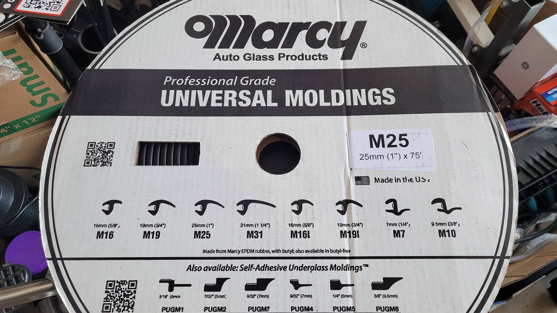

Can you share what size you used. A link to the actual product would be great. For those that want to try this approach.
Here is the link to the weatherstrip. I used the 25mm. It is just wide enough to cover the beveled gap.
https://www.gtglass.com/products/auto-glass-universal-rubber-molding-25mm?variant=709141430297
Jeep Gladiator Leaking rear window : fixes for those who don't want to play dealer roulette, wait 2 months, have their top scratched, seats ripped etc.... 20230325_173337
. that actually looks pretty good. Did you have to do anything special to get it to hug the radius of the corners?
I didn't do anything special around the corners. The rubber is very pliable. It helps to do it on a warm day in the sun. The bottom corners were too tight of a radious, so I left it alone. Once I put my hard tonneau cover over the bed, you can't really notice it.
I got some of this stuff but in the M19 3/4" version, and I found it near impossible to install. The channel that fits over the glass naturally closes on itself and I can't for the life of me get it to stay open long enough to press it over the window. I ended up giving up and went back to the silicon hose, and will try again another time when I can feel my finger tips again.
I'm guessing it's rubber...could you put it in a bucket of hot soapy water and install it as you pull it out of the bucket? Make it pliable and slippery might make it easy to install.
