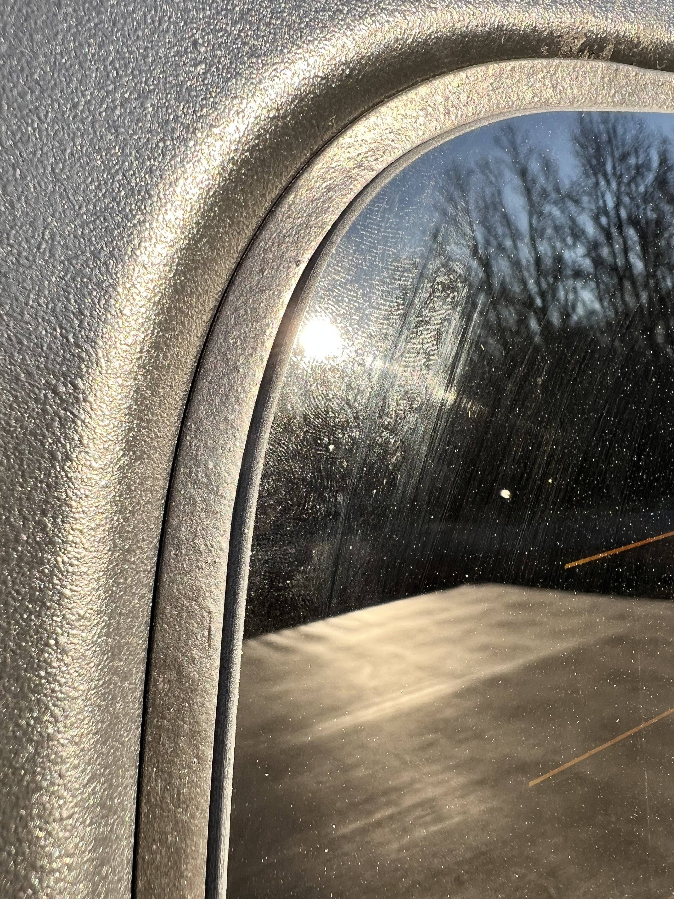

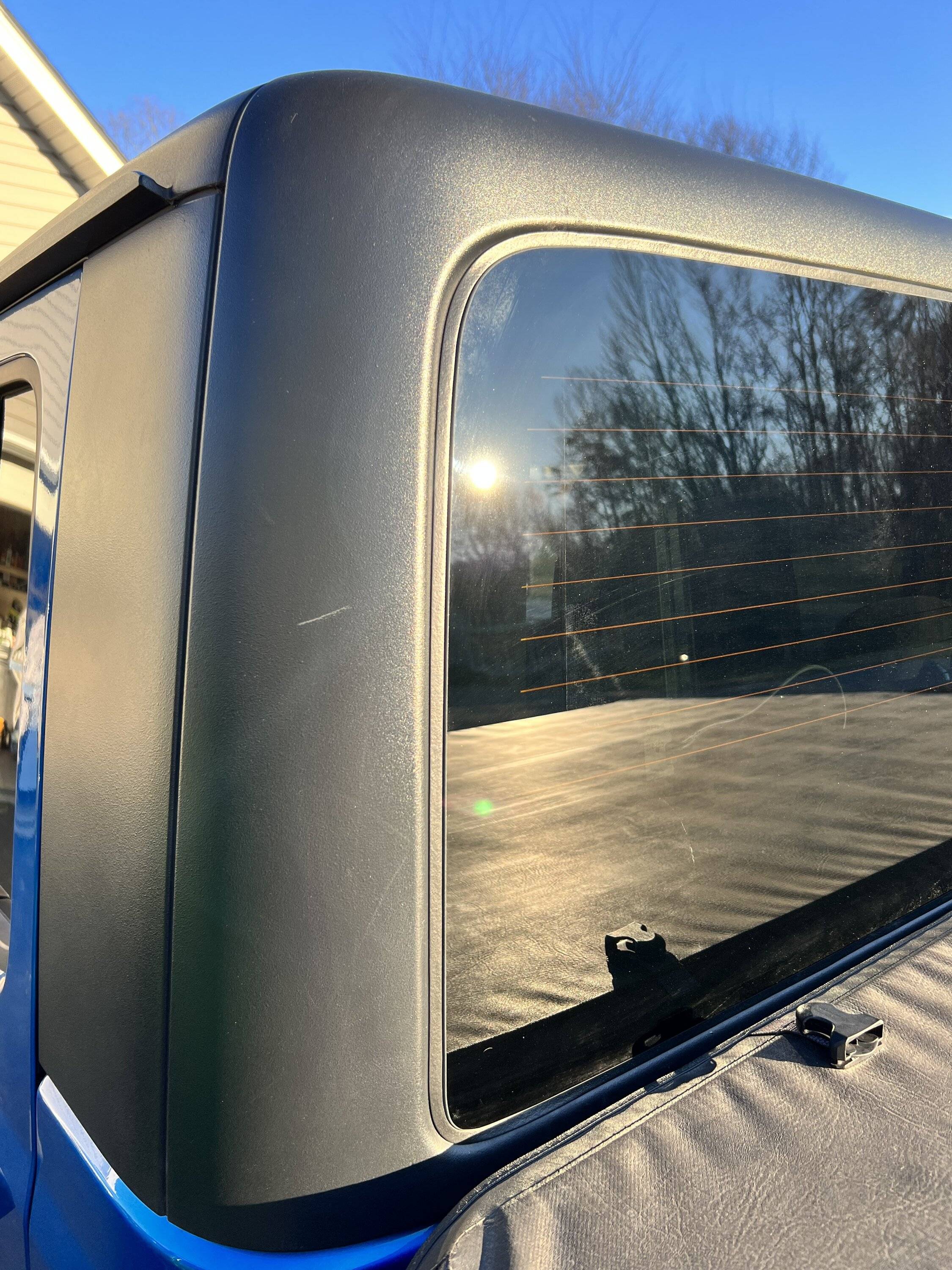

I got lucky and got my rear window repaired under warranty. It was sent out to a glass company where they replaced the rear glass, sealed with the black sealant stuff they use on windshields and then put a seamless gasket around the window. I do not know where they got it, but it looks great.
