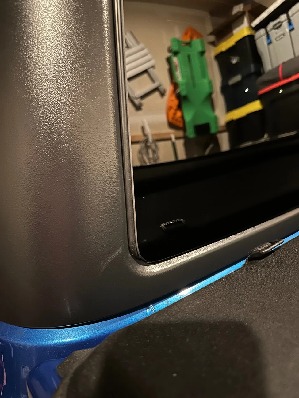

That actually looks better
Thanks. I had to snip the ends of the tubing at a 45 degree angle to make it fit into the groove. We’ll see if it stays there. It should. You could easily do yours if you decide to.

I completed this Saturday and happy with the results:
Jeep Gladiator Leaking rear window : fixes for those who don't want to play dealer roulette, wait 2 months, have their top scratched, seats ripped etc.... IMG_8830
My installation accessories:
Neatsfoot oil was what I had for my boots, so I used it. It worked fine as a lube, but I hadn't washed off the residue in the picture. The hitch pin was perfect for pressing the tubing in a pretty consistent depth.
Thanks again for the idea and input.
