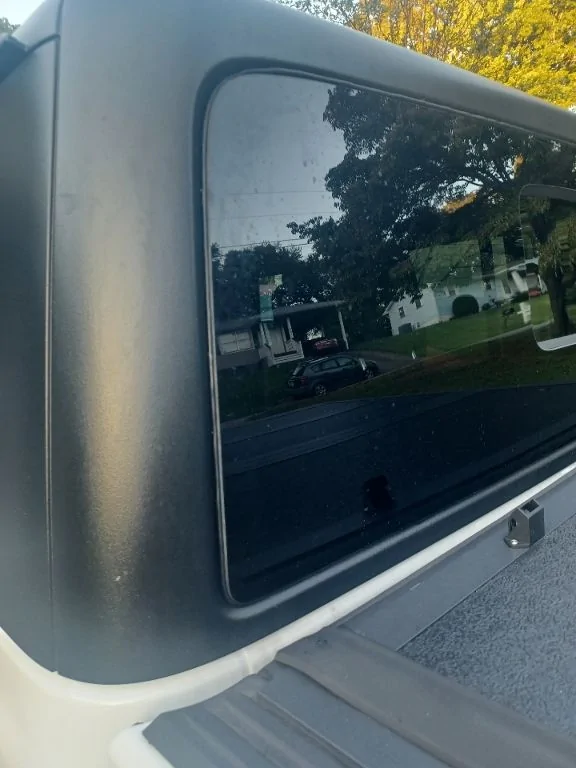

2.5 years in.... has not leaked. Hose still looks the same.

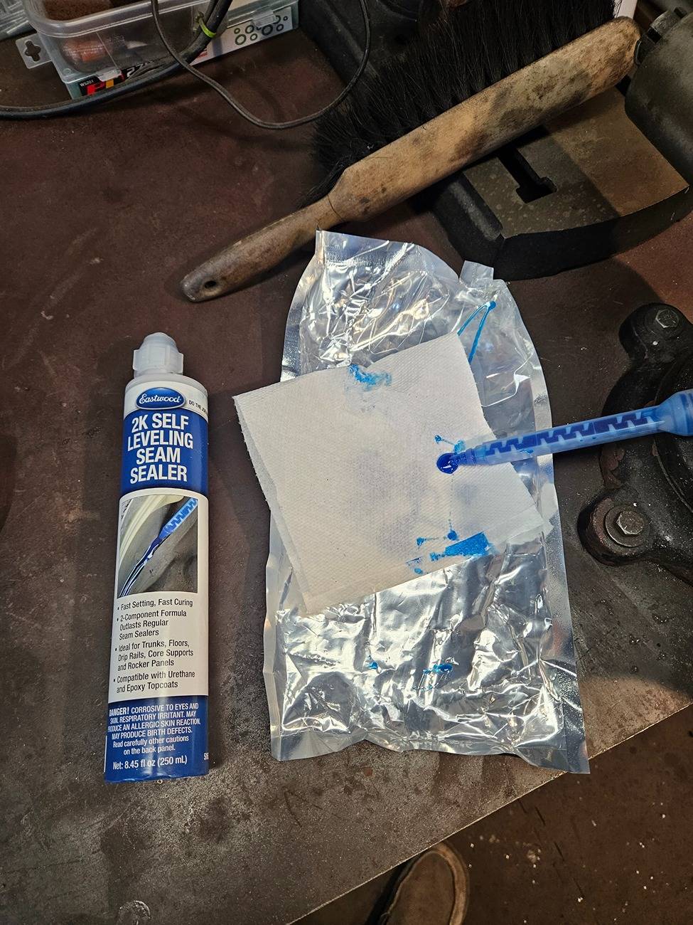

Finally got around to applying the Eastwood self leveling seam sealer. The shit is messy if you ain't careful. I cleaned the area with q-tips and alcohol. That channel is deep. I made my corner dams from modeling clay. To open the tube. You have to remove the plug in the end with pliers. Screw the mixing end on. Take lots of paper towels with you to wipe up. Start on one end and work across, then go in the opposite direction. I made 3 passes, slowly squeezing the cocking gun. You better have the JT level as possible. Because it will find the low corner. If you get any on the glass. You can use a razor blade to remove it. Now I have to wait for it to set up before I remove the dams. Which will be later this evening.

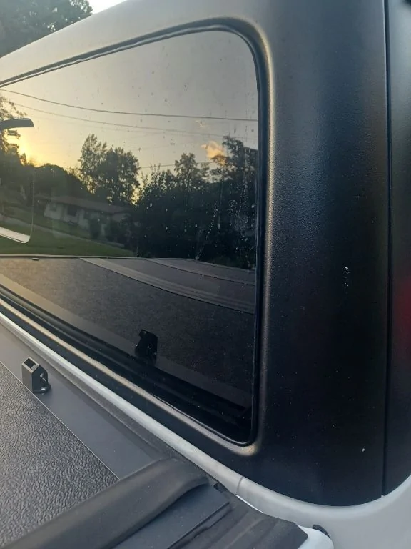

I have the silicone hose in now for 3 years and it blends into my black roof perfectly. Yes, it is a pain to get in even all the way around and took me a half dozen tries figuring out exactly how far I could push it in without it dropping into the crevice but once you get it right it will blend in perfectly.
