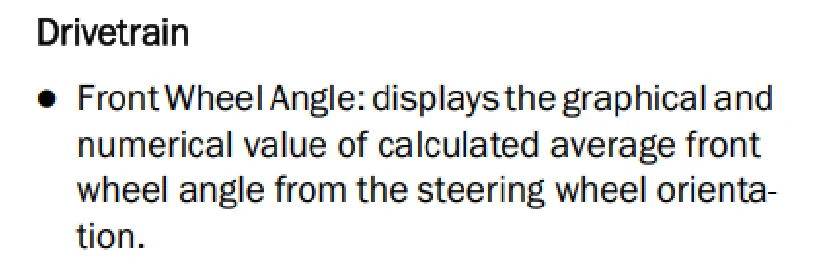

Hmmm.... I didn't know about the centering the steering wheel option. That's awesome. But then again, the app probably has a lot more things since it's updated. Good information!!!
I'm not sure I'd trust that one.
I was messing with displaying my steering angle in the dash display the other day while driving, and there's a good bit of movement, in both the steering wheel and the tires, before it reports a degree of angle change.
Assuming the JScan reads from the same source, I wouldn't rely on it to heavily for alignment setup.
Yea. There is a noticeable lag between the movement of the tires & steering wheel and what it displays on the dash. It would be interesting to see if that same lag is in the app as well.
Nope - different.
What the off road stuff reports is the average tire angle calculated based on the steering wheel angle. It's not a direct read, it's a calculation.
It's a ratio as well, based on the steering gear ratio so xx degrees of steering wheel movement figured on a yy steering sector ratio gives zz tire angle - calculated average since there is Toe out on Turns to consider - right wheel angle will be different from left wheel angle so it's an average. Right may be 16 while left is 14.5 degrees and then it averages the two.
(JT is 13.3:1 ratio)
JSCAN directly reads the exact steering wheel angle directly.
