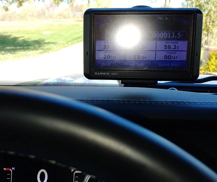

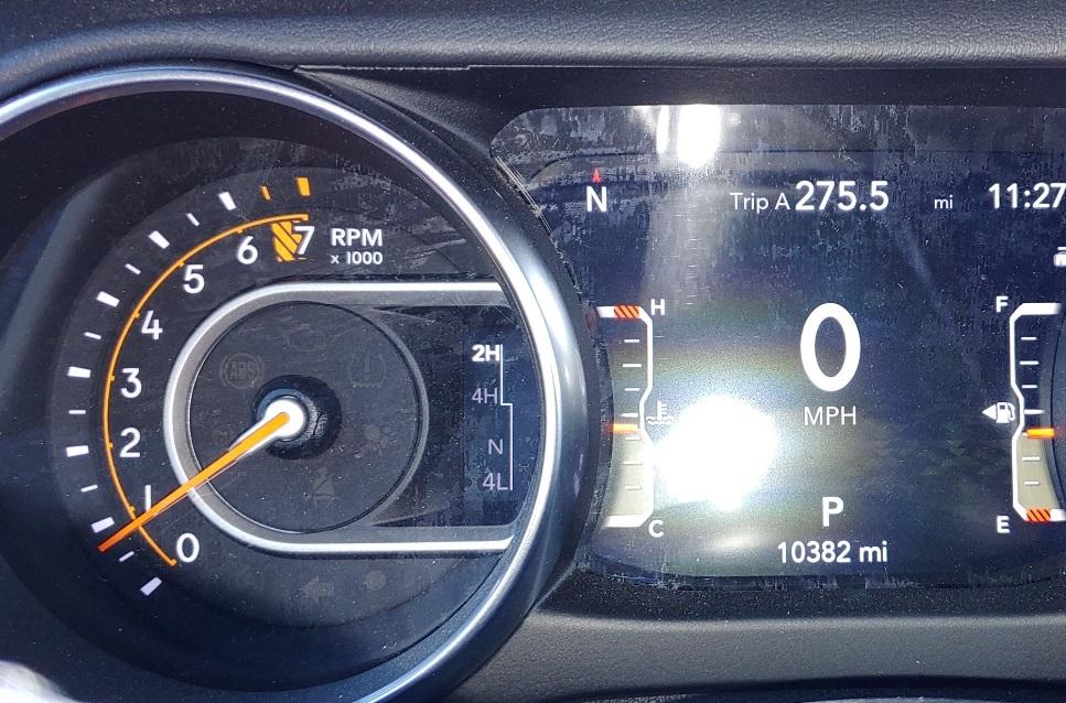

After being told directly more than once, even reading other threads "Jeep speedometers are always off anyway" or "they always read this way" or whatever, I decided to run a test. I needed to make a trip into town for some supplies for restoration projects, so fired up my phone and my Garmin GPS.
To ensure no interaction (the Garmin is dumb in that way anyway, it can't interact and when plugged into USB, it drops to charging mode and shuts off) I didn't plug any device into anything at all. I made sure batteries were charged in everything.
Phone laying in the cup holder area, not plugged in, GPS suctioned to the windshield so I could watch it and the cluster at the same time.
I drove around a while and turned my cluster display to show the big digital speedometer and trip counter A.
I watched the GPS, phone and JT speedometer and was amazed - they synced up near perfectly. When I put on cruise (I chose easy round numbers) they stayed in lockstep. When the speedometer dropped 1, so did the others. If it gained 1 mph, so did the others.
I got to O'Reilly's, did my shopping, wrote down what was on the trip counter for miles (262)and took the long way home to ensure I wasn't comparing odometers over just a mile or 10.
When I got back, I took photos of the GPS (used my phone so no, don't have that pic - forgot to take a screenshot first) and of the JT's cluster.
Note that I started at 262 miles on Trip A
Note the miles now at Trip A and on the GPS -
262 + 13.5 = 275.5 , correct?
And the GPS says 13.5, right?
Perfect match over 13 miles. And the speedometer SPEED reading in mph also matched.
No possibility that older Garmin could sync with that new JT - no way in heck. I even have bluetooth turned off on the Garmin.
There was no cable in my phone, and bluetooth wasn't connected on it, either.
So - you guys may have JTs that have inaccurate speedometers and odometers, but not me.
Please stop saying they are all off or wrong.
To be lined up to the very tenth of a mile after 13 miles of driving is pretty good. I guess if I get a ticket, it's my own fault, can't blame the stupid speedometer!

Shadow pops - thanks for the work you did in testing all that. I ended up doing much of the same with 3 devices, plugged in and not plugged in after Ren's shaming (despite my foreshadowed comments in OP).
I used Google Maps, Apple Maps, and 2 different speedo Apps, CARPLAY and NOT CARPLAY. None changed plugged in or not. I have not tried WAYZ or know what APPS others may be experiencing with the DRO jumping to live truck speed vs GPS - but mine performed as your tests and as expected off GPS only (and got tires dialed in to match). Thanks for your posts and dedication to this forum BTW.
