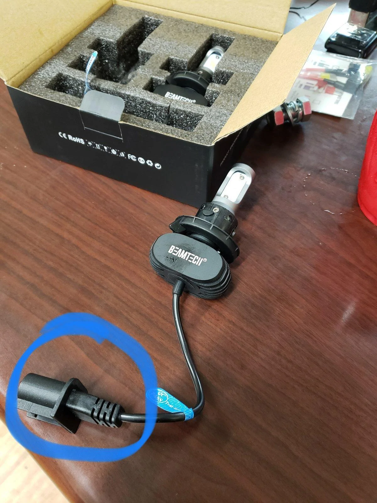

I bought some Beamtech H13 LED bulbs https://www.amazon.com/gp/product/B073ZDLKT9/ref=ask_ql_qh_dp_hza and tried to install them today and the plugs don't match up. On my stock headlight the stock bulb's wire hooks to the inside of the headlight and on the outside it's a square plug. The LED bulb has a rectangular plug with rounded ends. How do I unhook the stock bulb? It looks like I'd have to take apart the the whole headlight to remove the stock bulb's plug.

I did that. When I unplug the stock bulb the wire for it goes down inside the headlight assembly and connects to that square-ish plug. So I can't remove the stock halogen bulb unless I take apart the whole headlight assembly. I should have taken pics haha

It's weird. I've put LED bulbs in my previous Wranglers and they had an adapter to go from the standard halogen plug to the LED. It was so odd that I took off the headlight and cap and removed the halogen bulb but the wire for the bulb goes down inside the headlight and I'd have to have babydoll hands to reach down and try to unplug it. At this point I'd plug in the LED bulb and have to get an adapter so I can plug the wire into the plug that comes from the Jeep but the existing halogen plug would have to just dangle from the back of the headlight. I'm not sure if I can remove the plug that attaches to the back of the LED bulb.

Maybe. I sent a message to the seller this afternoon and am waiting to see what they say. The way my headlights are, on the back bottom of the headlight assembly is a square plug that plugs into the wire coming from the jeep. It won't plug into that kind of plug on the Beamtech LED bulb. Thanks for your help.

I just watched this video ( ) and see what I did wrong. I need to take the plug off the back of the halogen bulb. I knew it had to be something simple haha

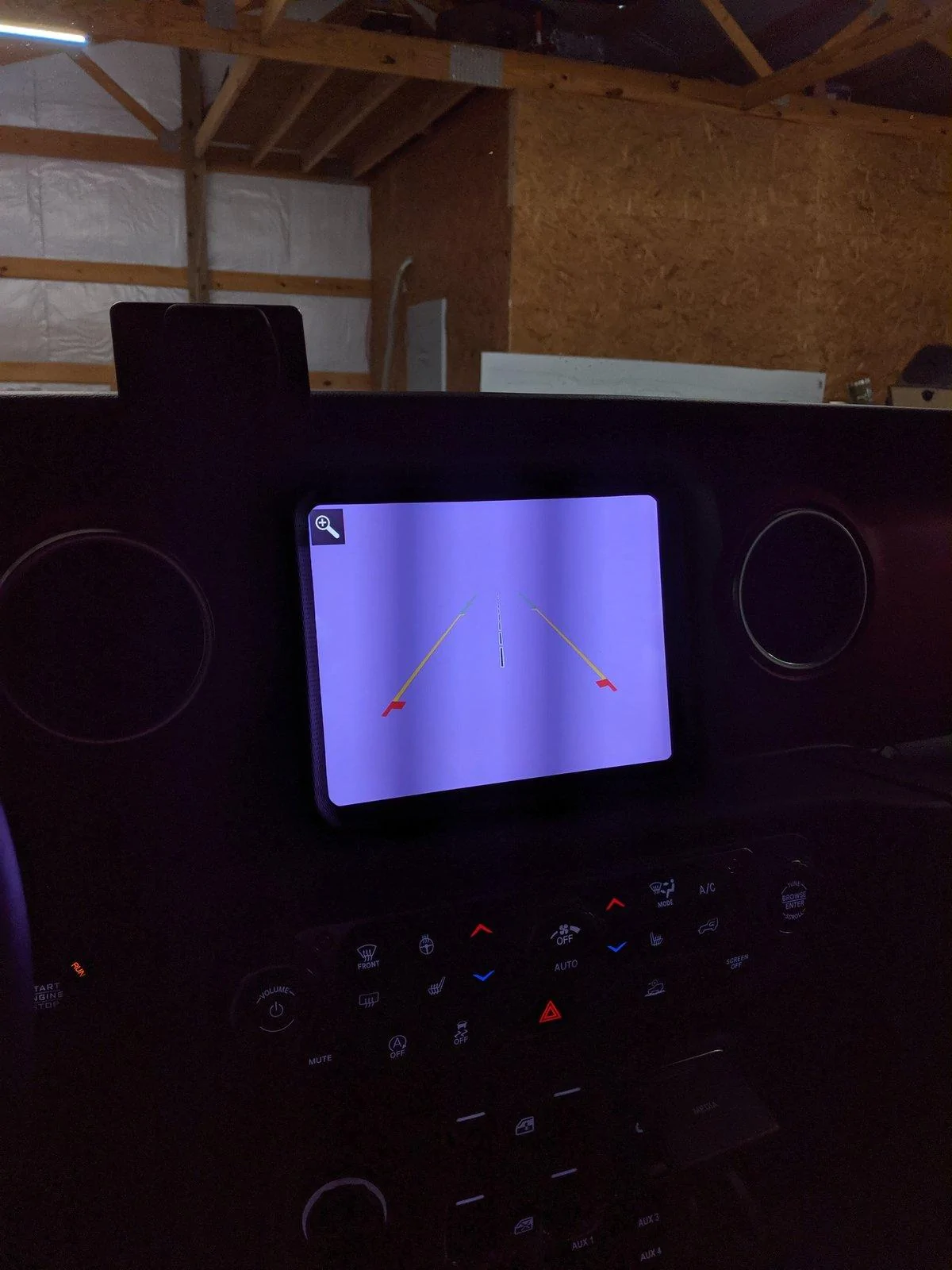

so i bought these reverse lights. put them in, pull e brake, put in reverse, nothing. it's night here. my 8.4" display is purple. no reverse lights. HELP!!! lol
well that's weird. Was your door open and nothing worked?
These cars have auto-park. So if your seatbelt isn't fastened, and the door opens below a certain mph, the car will auto park.
WARNING, DON'T KILL YOURSELF!
I plugged seatbelt in, pulled ebrake hard, put in reverse, then opened door.
If that still doesn't work for you.......i'm at a loss. Do you have a sport/overland or rubicon? you said you've got the 8.4" screen?
