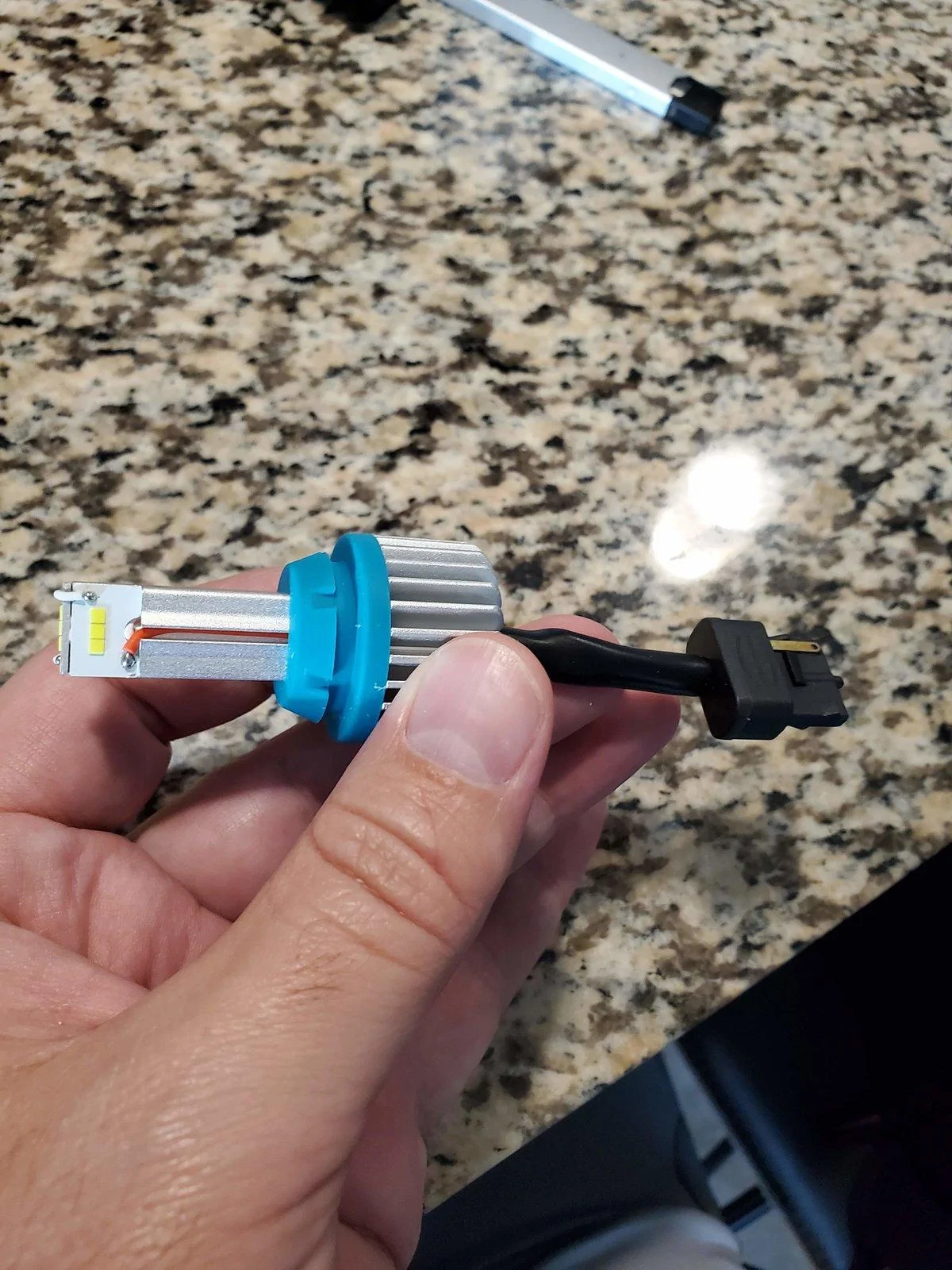

Sooooo, slightly disappointed with Headlight Revolution right now. My first order with them was for the heads and fogs. I ordered the same bulbs as @WXman and that order was on B/O for a month. When they finally arrived, the heads worked great. Got them installed yesterday and working perfectly. But, the fogs don't fit. The collar is too big and won't allow the bulb to fully "seat" into the housing. Called HR, they honestly sounded like they had heard of this happening and said they would send me the correct bulbs. So I am now awaiting those.
Fast forward to today, received my reverse and turn/brake lights. Got the brake lights in, no issues at all. But the reverse bulbs don't fit. The square connector on the bulb they sent me is way too big for the circular connector on the housing. So now I am waiting for HR to call me back and see how they are going to handle this one. The bulbs that fit work great, just frustrating to get two sets of wrong bulbs. :(

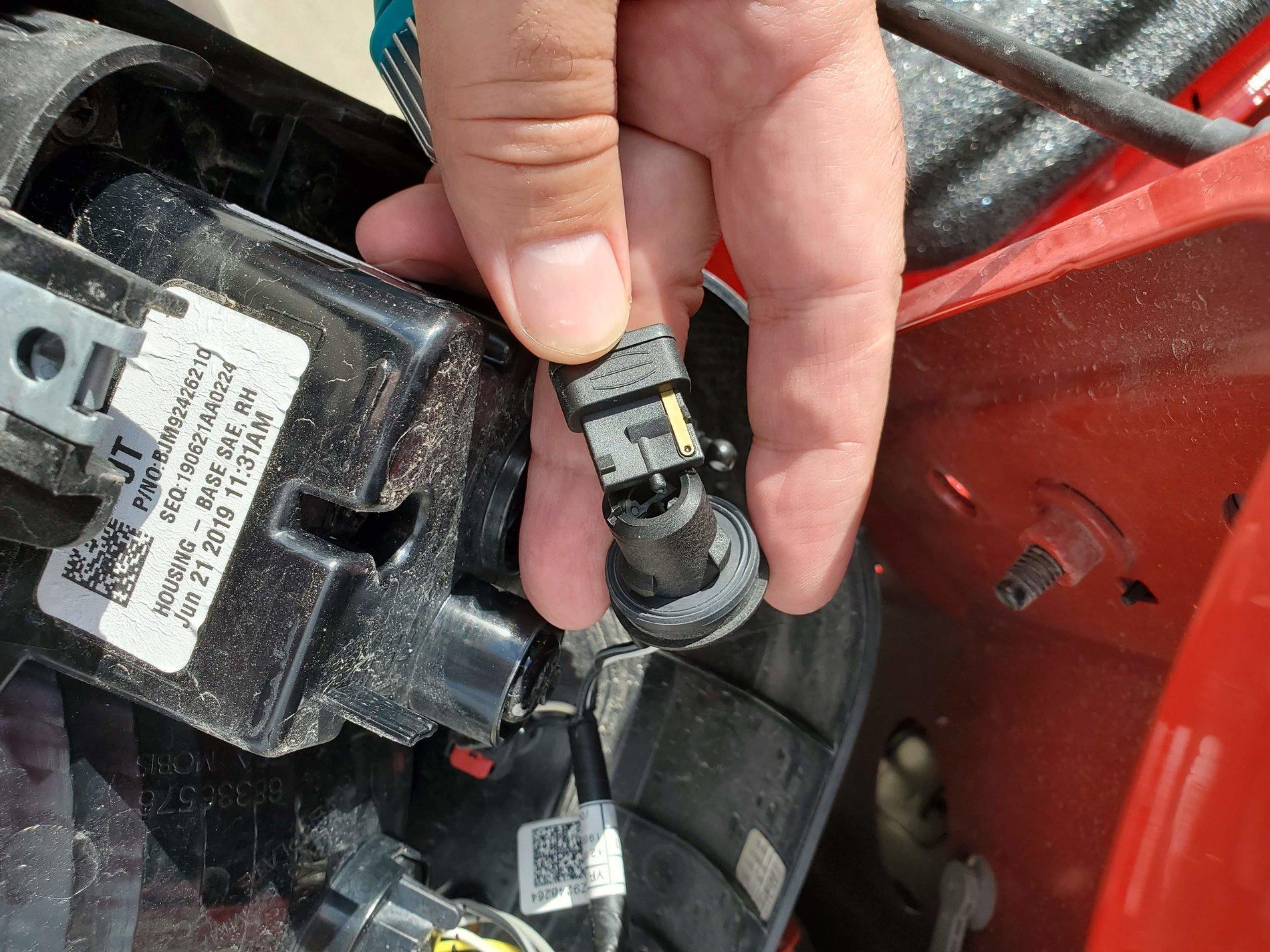

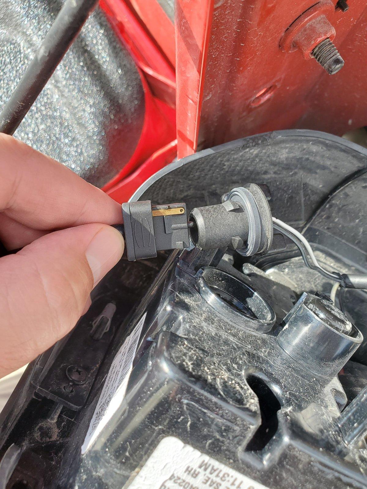

Yes, definitely watched the video; that is how I found out about the reverse bulbs. I think I even clicked the link from their video to their website to make the purchase. After re-watching the video today and freezing it on the part that shows the new LED reverse bulb, I compared it to what they sent me, it doesn't even look like the same bulb. And here is a picture of that connector from the new bulb next to where it is supposed to plug in to the OEM harness, no way it fits:
EDIT: HR called literally as I was hitting send. They saw these pictures in the email I sent them and said this was news to them. They thought all JT's had a standard bulb in non-LED models but apparently not. They are sending me some T15's same 1000 lumens. So, we shall see.

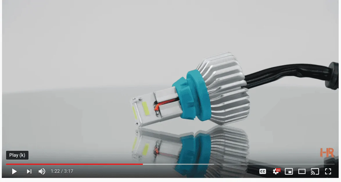

Just another point of interest, here is the bulb they installed in the video and a photo of what was sent to me. They don't look the same, the bulb in the video looks shorter and stubby, mine is longer and has a metal sheath wrapped around it. I brought this to their attention several times but... idk.
