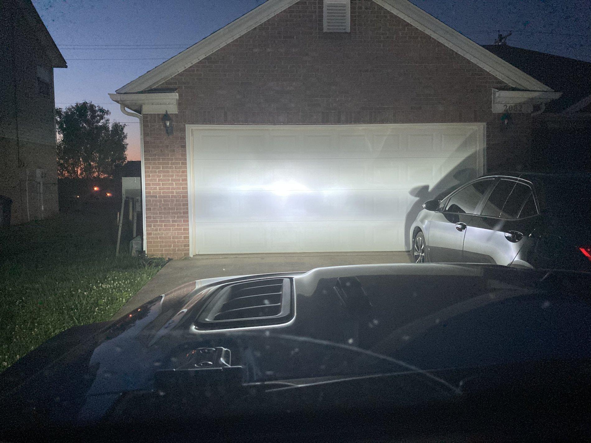

I’m not good at pics but I gave it a shot.
Low Beams with Fog Light

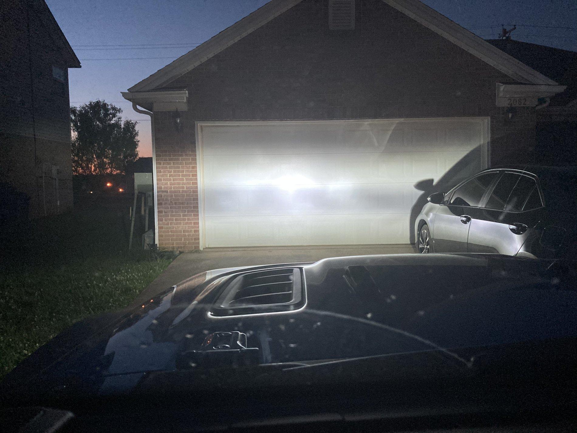

Jeep Gladiator LED Bulb Replacement - IT WORKS! E17FBBD2-6C88-448B-9D0A-903383E43641
Low Beams without Fog Lights

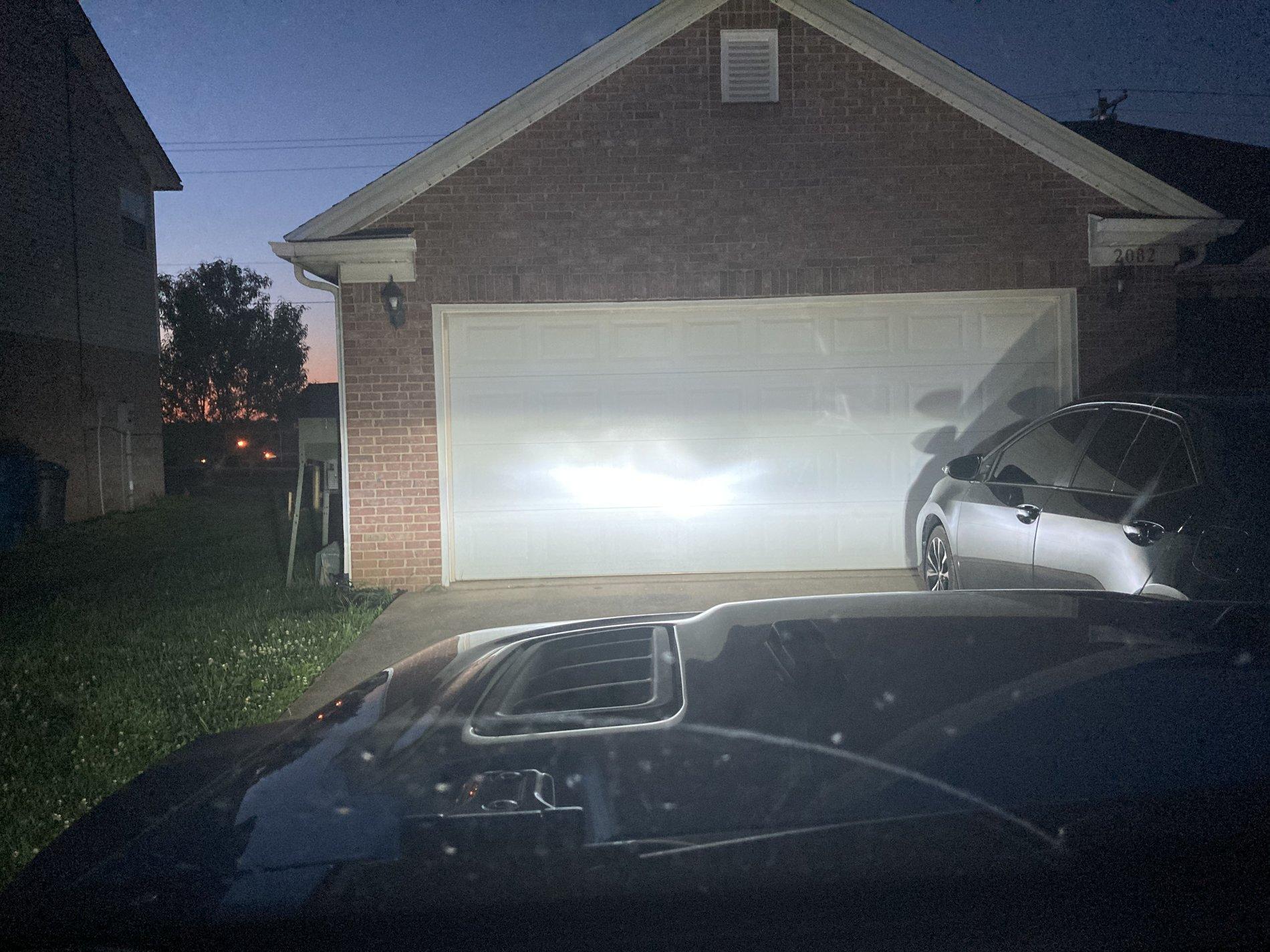

Jeep Gladiator LED Bulb Replacement - IT WORKS! 8C477CB8-117C-4216-BDB7-7DACAC2FAE45
High Beams without Fog Lights

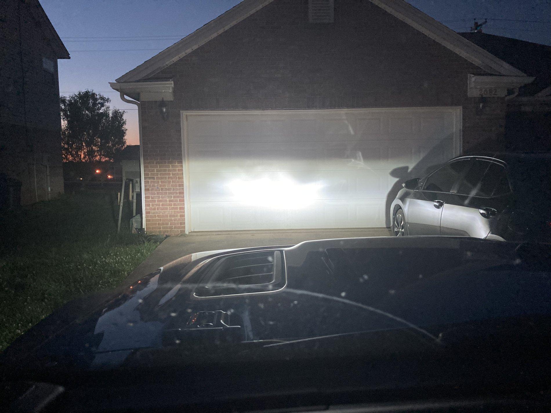

Jeep Gladiator LED Bulb Replacement - IT WORKS! 117697A1-84F2-46C9-9C4A-F9DF4ACC965A
High Beams with Fog Lights

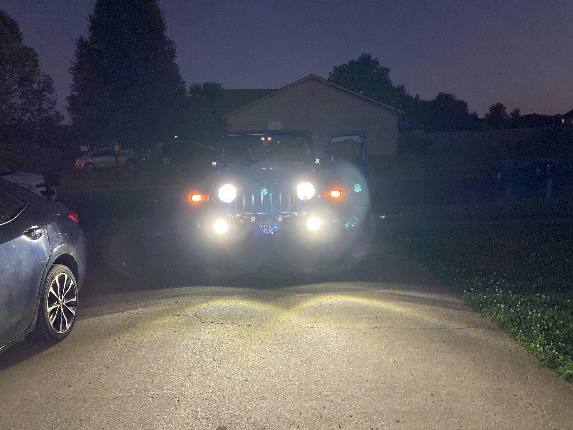

Jeep Gladiator LED Bulb Replacement - IT WORKS! E4453F85-3773-4329-BE4C-B71FC1E62782
Low Beams with Fog Lights
Jeep Gladiator LED Bulb Replacement - IT WORKS! 72F94E25-7146-4589-8426-F1DE465D1549
Jeeperjamie
Jamie
Feb 12, 2020
135
4,754
5,412
Kannapolis nc
2020 jeep gladiator
Weyerhaeuser
Pictures look good. The bulbs look pretty good as well. Definitely better than stock. :like:
