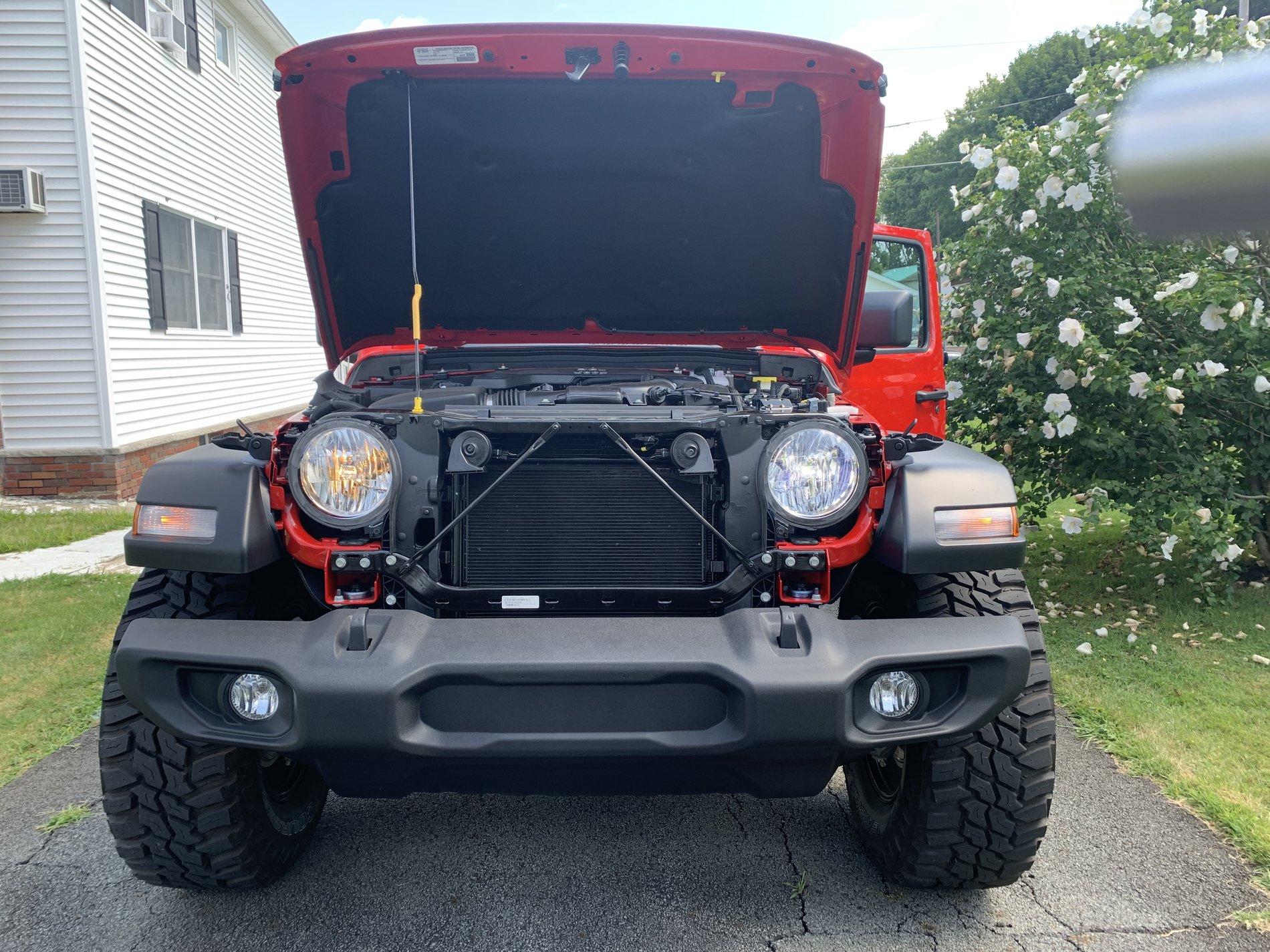

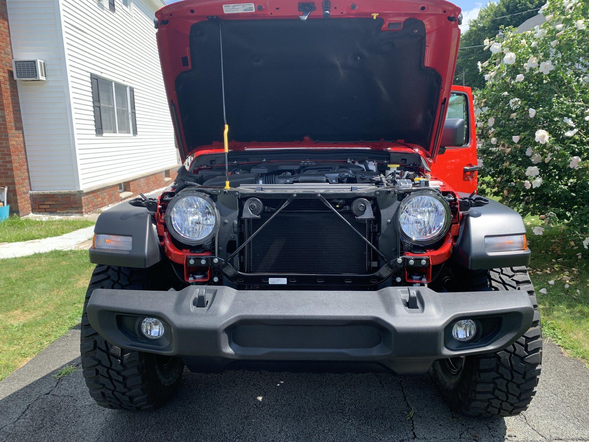

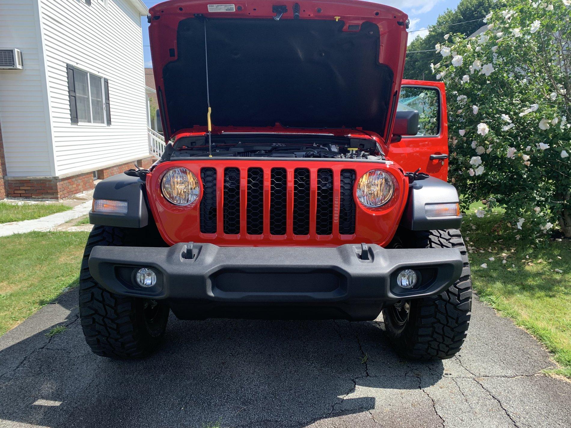

Just installed mine as well. Seems like they will be good. Better idea tonight. I feel like the plugs can only be connected one way. Can’t speak on the hi low beam situation until it gets dark out
