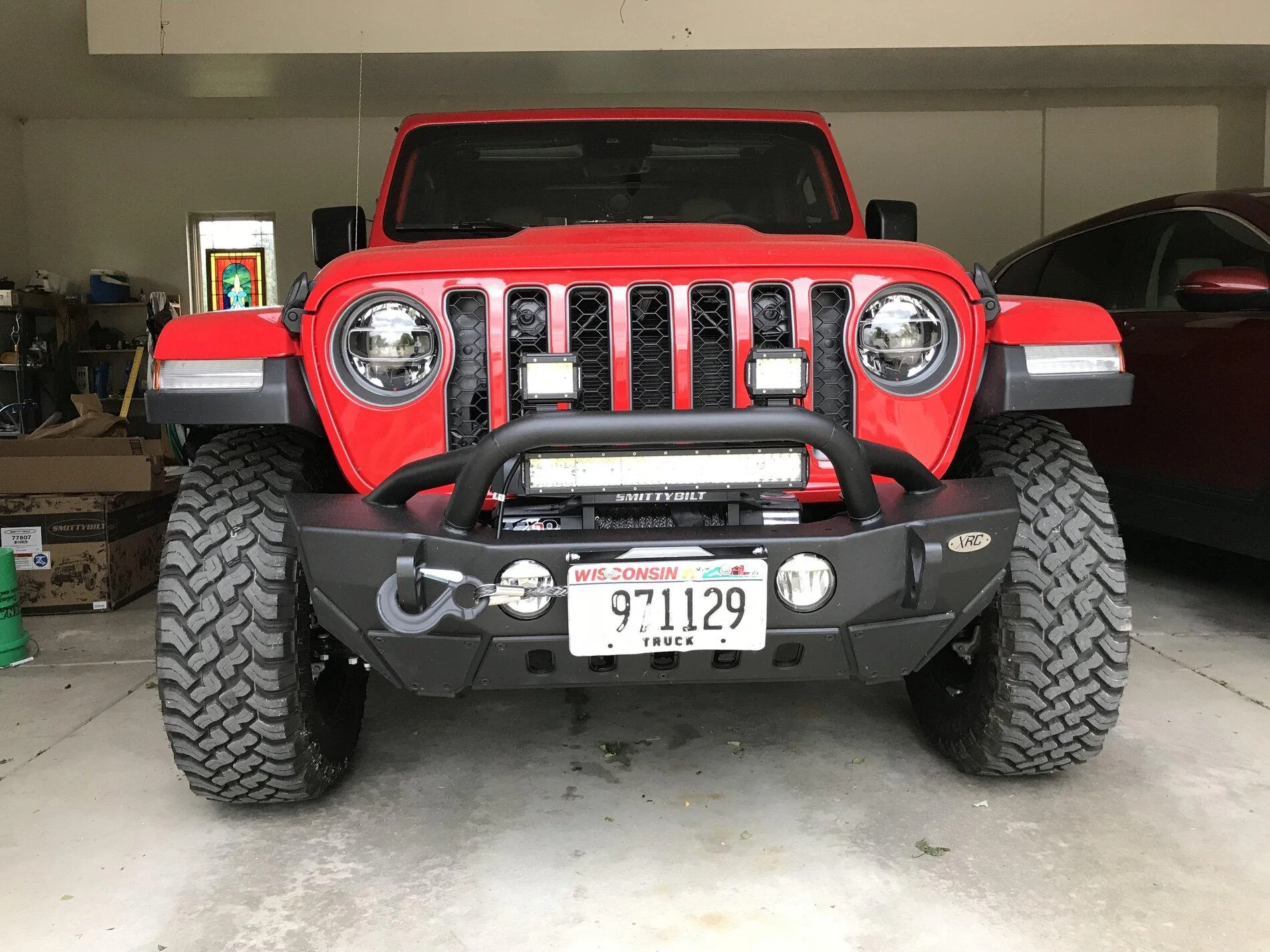

I like the SB X2O, it has a better waterproof rating than than a lot of the others. for me that means a lot as I run in wet areas and deep water fording is common. I've had two two and both have worked flawlessly.
I'm going to get another as I add a a Road Armor Stealth rear winch bumper.
Stealth Rear Winch Bumper, 9500lb Remote Winch - Texture Black 2020-2021 JEEP JT Sport JT Gladiator JT Rubicon JT Rubicon (roadarmor.com)
I'll take my 10,000 X20 and put it there and get a 12,000 up front.
I frequently wheel alone so the rear winch option is really desirable when you just want to get back out of a bad situation rather than doing the hokey pokey pulling forward then turning around and pulling thru again.

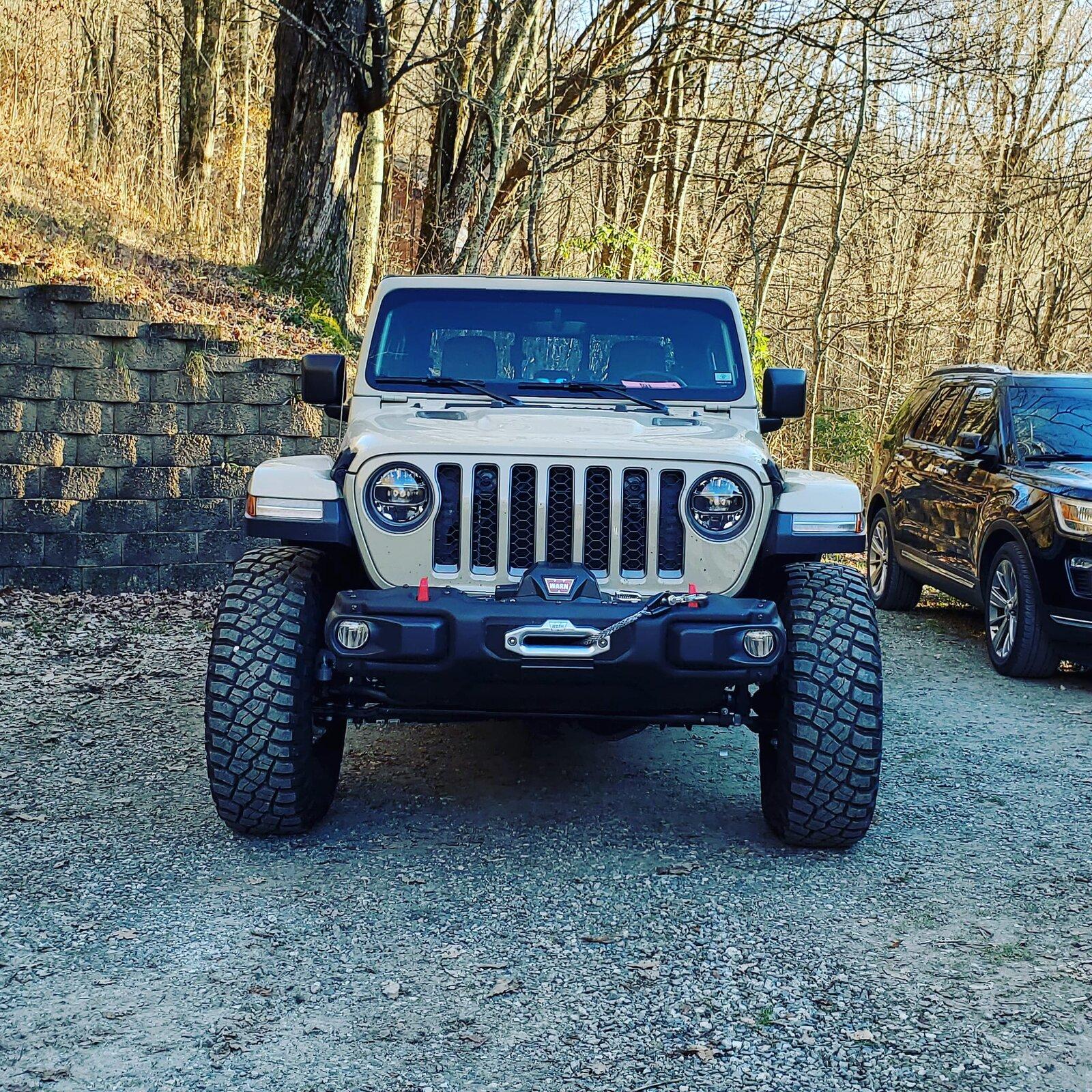

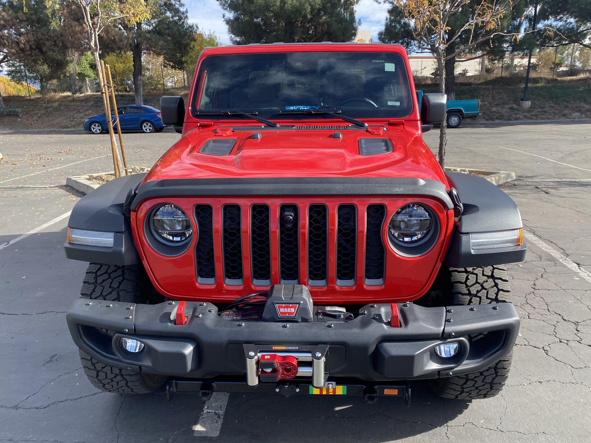

Bought a warn XD9500 when I was 17 (37 now)and it was a ridiculous amount of money for me then.. that winch still works.. so when it was time to buy for the glad there was no second thought. To me the cost has to be measured by the expected life, not the upfront commitment. I have a new warn zeon 10s. Made in US.
To each his own, but that is how I decided.
